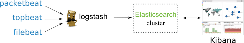

editThe simplest architecture for the Beats platform setup consists of one or more Beats, Elasticsearch, and Kibana. This architecture is easy to get started with and sufficient for networks with low traffic. It also uses the minimum amount of servers: a single machine running Elasticsearch and Kibana. The Beats insert the transactions directly into the Elasticsearch instance.
This section explains how to use the Beats together with Logstash to provide additional buffering. An important advantage to this approach is that you can use Logstash to modify the data captured by Beats in any way you like. You can also use Logstash’s many output plugins to integrate with other systems.

editIn this setup, the Beat sends events to Logstash. Logstash receives these events by using the Logstash Input Beats plugin and then sends the transaction to Elasticsearch by using the Elasticsearch output plugin. The Elasticsearch plugin of Logstash uses the bulk API, making indexing very efficient.
