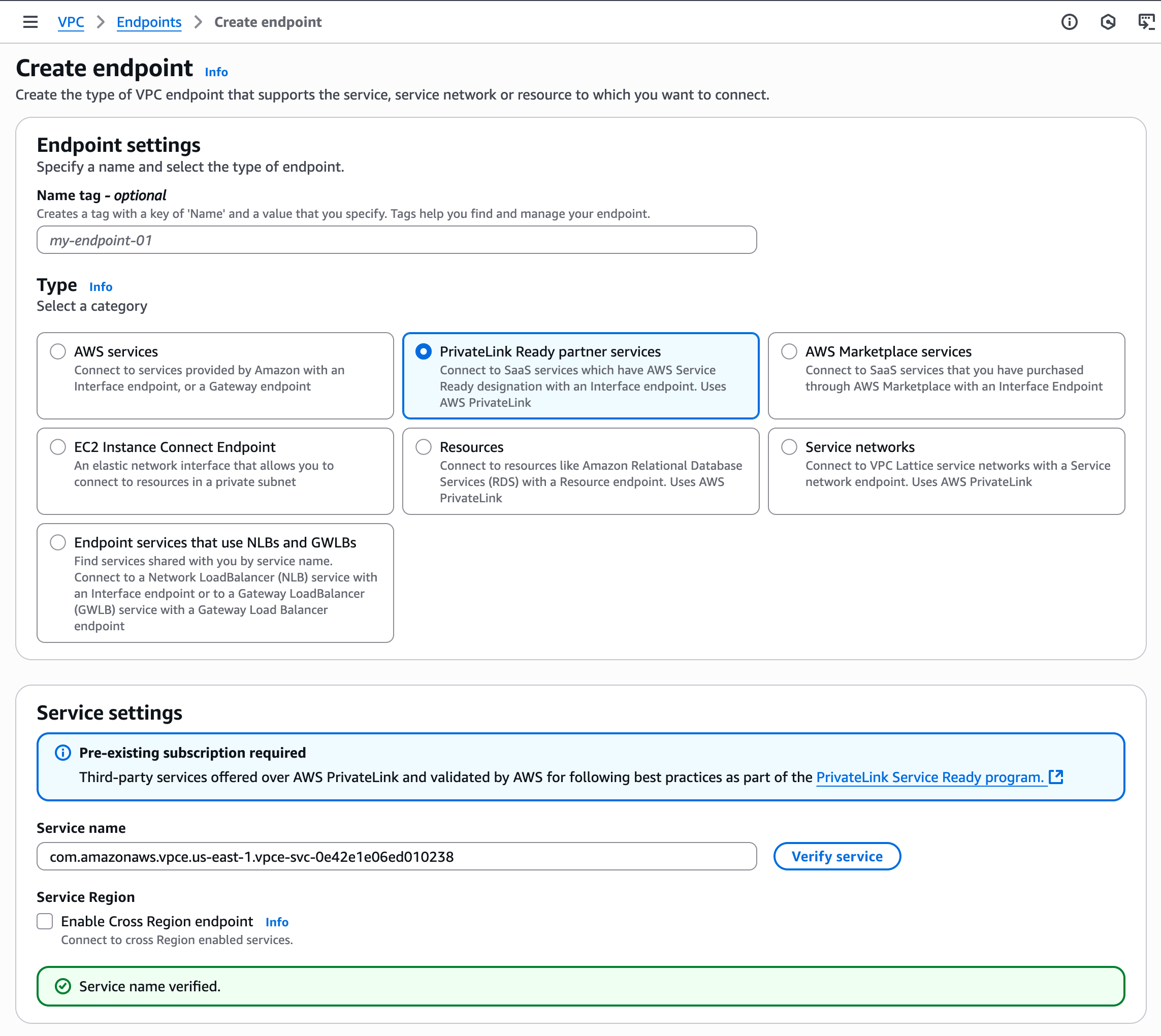

Create a VPC endpoint in your VPC using the service name for your region.
Follow the AWS instructions for details on creating a VPC interface endpoint to an endpoint service.
Use the service name for your region.

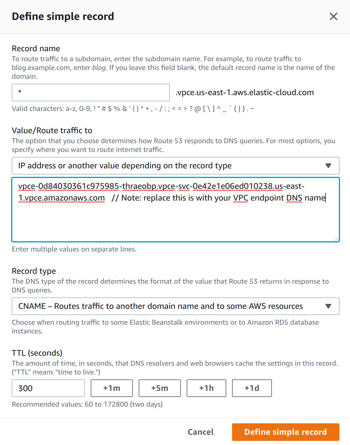

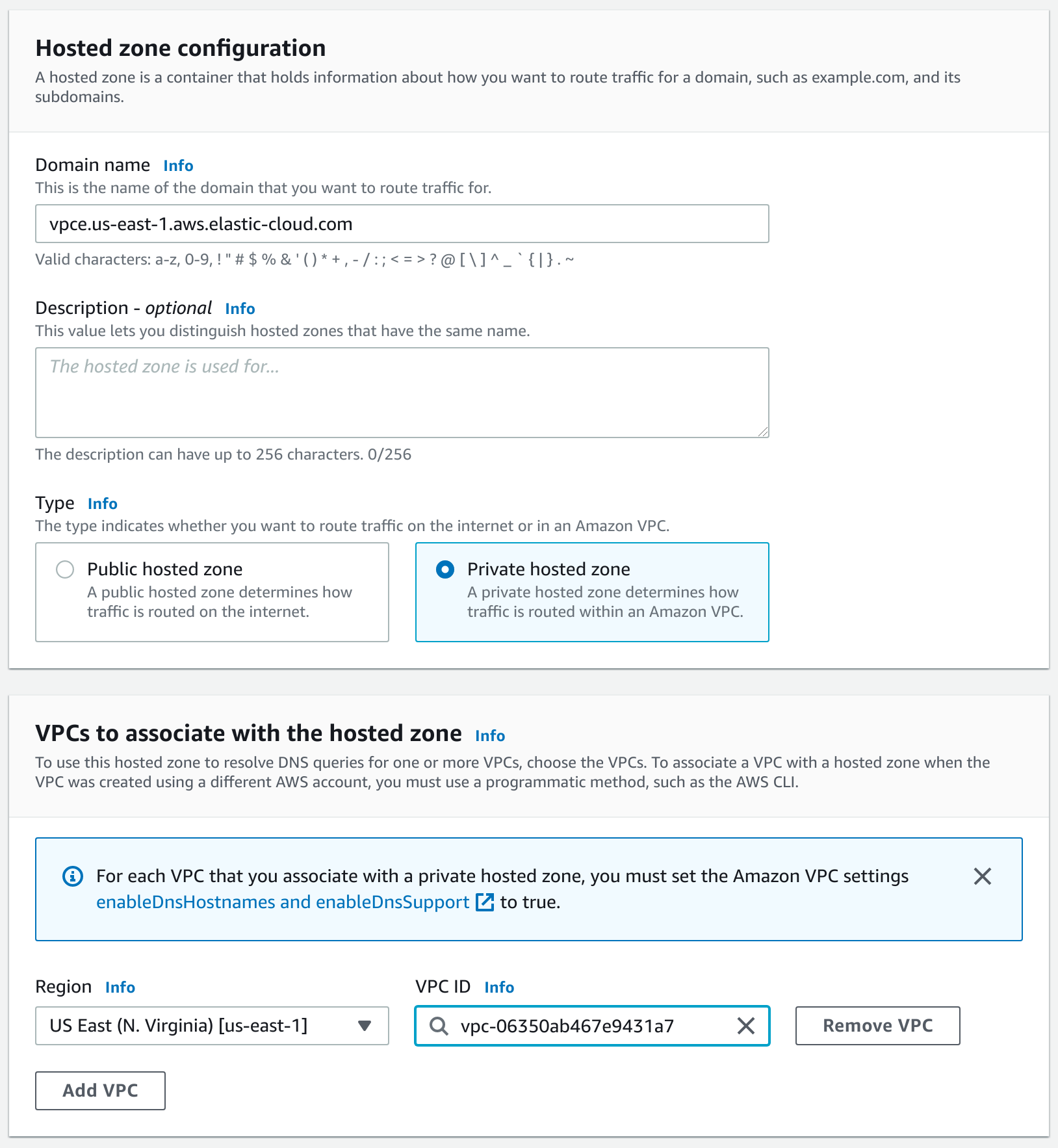

Create a DNS record.
Create a Private hosted zone. Consult Private hosted zone domain name in PrivateLink service names and aliases for the name of the zone. For example, in us-east-1 use
vpce.us-east-1.aws.elastic-cloud.com
as the zone domain name. Don’t forget to associate the zone with your VPC.Then create a DNS CNAME alias pointing to the PrivateLink Endpoint. Add the record to a private DNS zone in your VPC. Use
as the record name, and the VPC endpoint DNS name as a value.Follow the AWS instructions for details on creating a CNAME record which points to your VPC endpoint DNS name.

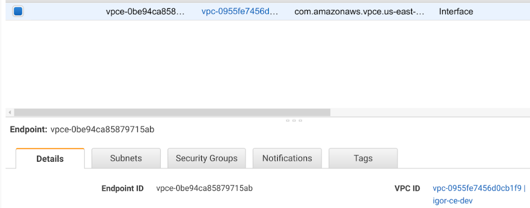

You can find your VPC endpoint ID in the AWS console:
