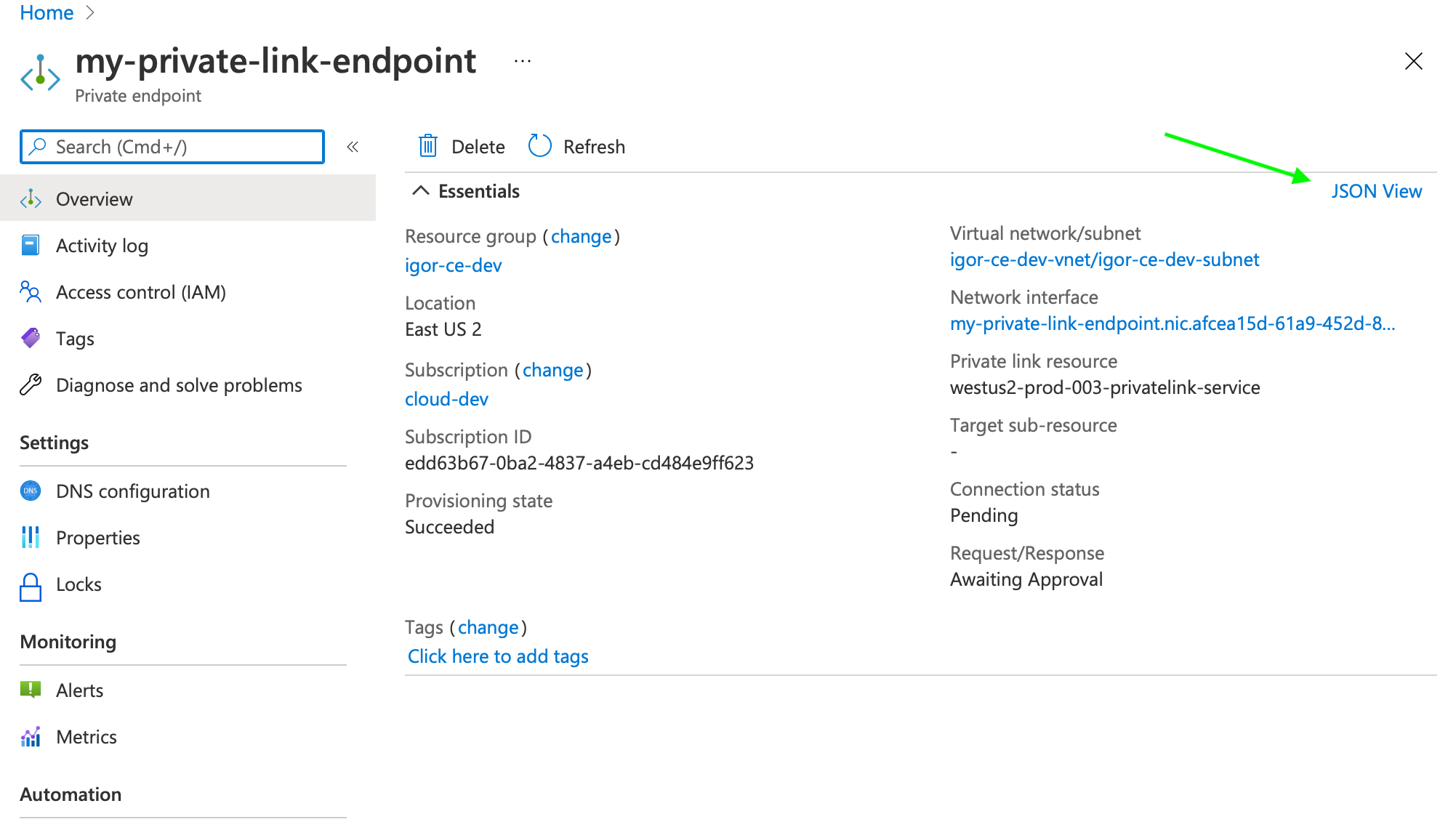

  1. Find your private endpoint resource name.
  2. Find your private endpoint resource ID.
  3. Create policies using the Private Link Endpoint resource ID.
  4. Test the connection.
  5. Associate the private endpoint with your deployment.

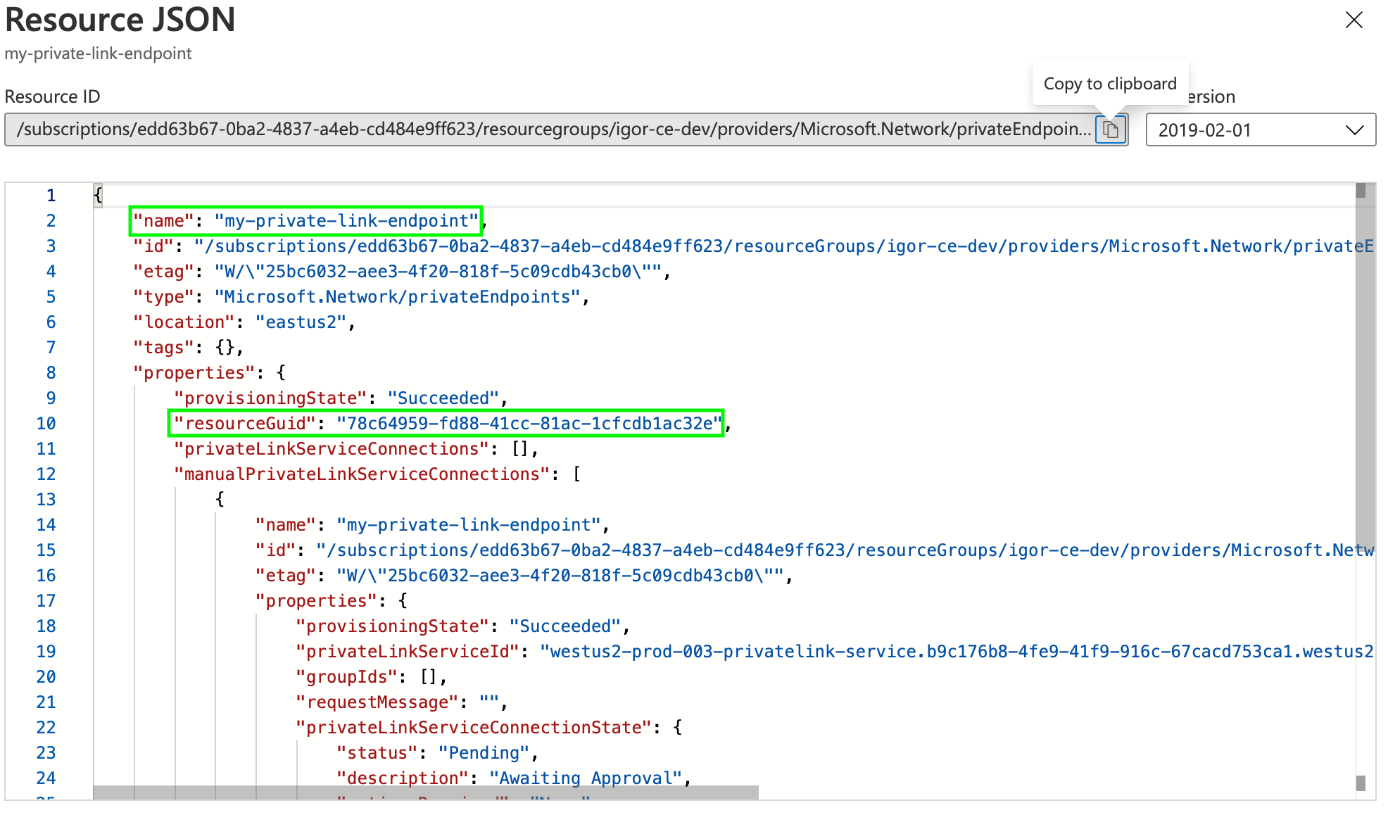

  1. Go to your Private Link Endpoint in the Azure Portal.
  2. Select JSON View.
  3. Copy the value of the top level name property.
  3. Copy the value of the properties.resourceGUID property.
Private endpoint JSON view Private endpoint properties

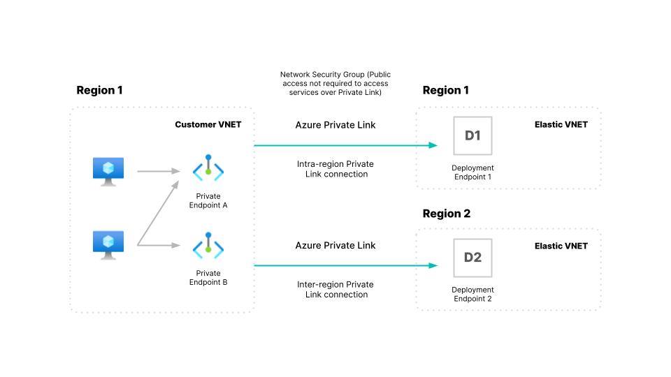

Azure supports inter-region Private Link as described in the Azure documentation.
This means your deployment on Elastic Cloud can be in a different region than the Private Link endpoints or the clients that consume the deployment endpoints.
Inter-region Private Link
  1. Set up Private Link Endpoint in region 1 for a deployment hosted in region 2.
    1. Create your Private Link Endpoint using the service alias for region 2 in the region 1 VNET (let’s call this VNET1).
    2. Create a Private Hosted Zone for region 2, and associate it with VNET1 similar to the step Create a Private Link endpoint and DNS. Note that you are creating these resources in region 1, VNET1.
