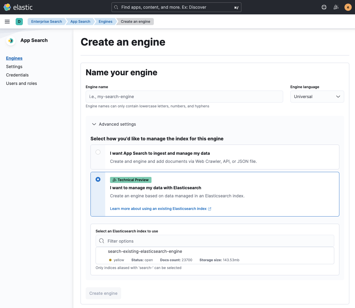

You can create Elasticsearch index engines using App Search UI:
- Select "Engines", and press the "Create engine" button
- Choose an engine name, and click on "Advanced settings"
- Choose "I want to manage my data with Elasticsearch" option.
A list of the available Elasticsearch indices and aliases that start with
search-
to use will be displayed. - Select the Elasticsearch index from the list and click "Create Engine"
