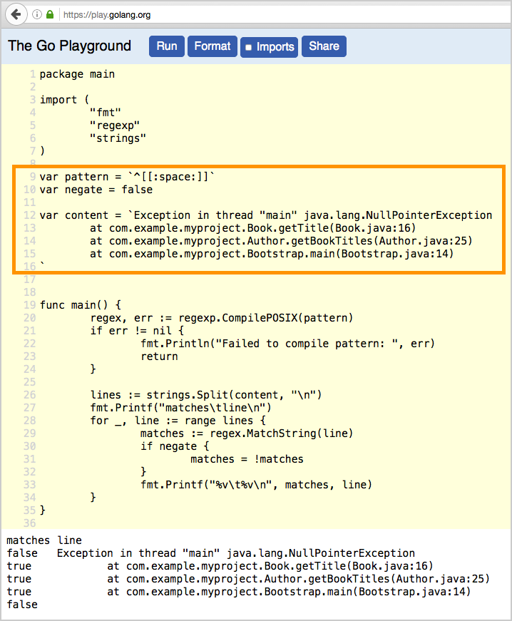

Testing Your Regexp Pattern for Multiline
To make it easier for you to test the regexp patterns in your multiline config, we’ve created a Go Playground. You can simply plug in the regexp pattern along with the negate setting that you plan to use, and paste a sample message between the content backticks (` `). Then click Run, and you’ll see which lines in the message match your specified configuration. For example:
go playground
