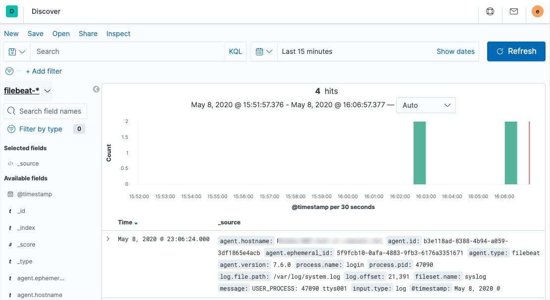

In the side navigation, click Discover. To see Filebeat data, make sure the predefined filebeat-* index pattern is selected.
Discover tab with index selected

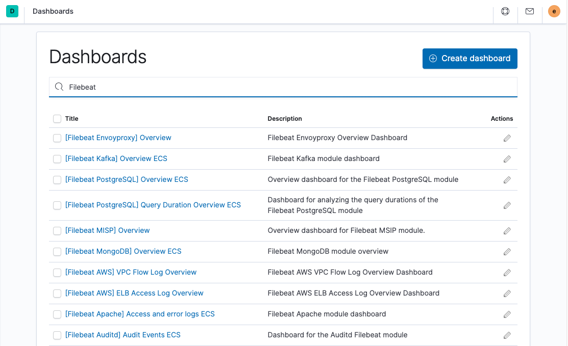

In the side navigation, click Dashboard, then select the dashboard that you want to open.
Navigation widget in Kibana
