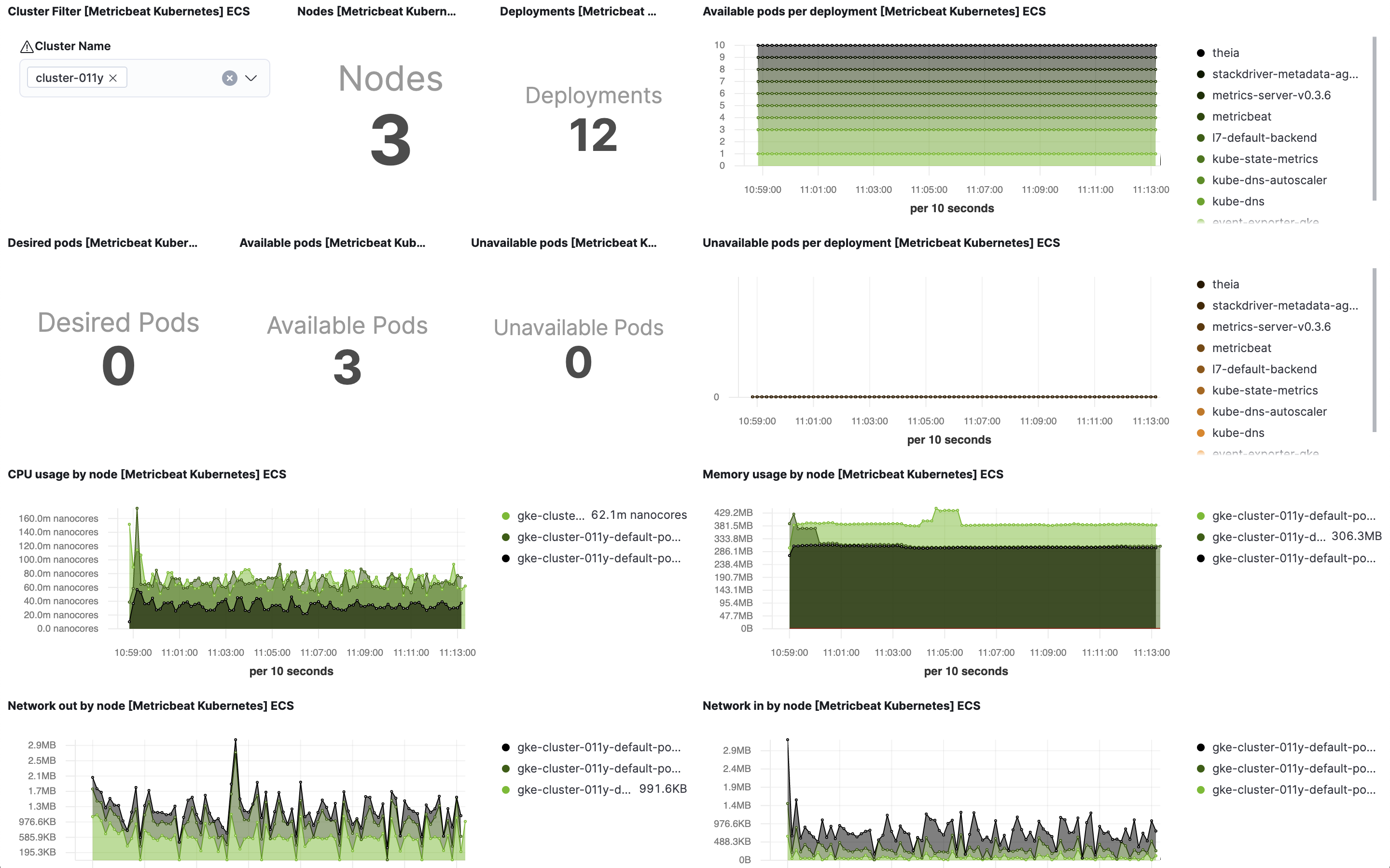

Kubernetes cluster overview example:
metricbeat kubernetes clusteroverview

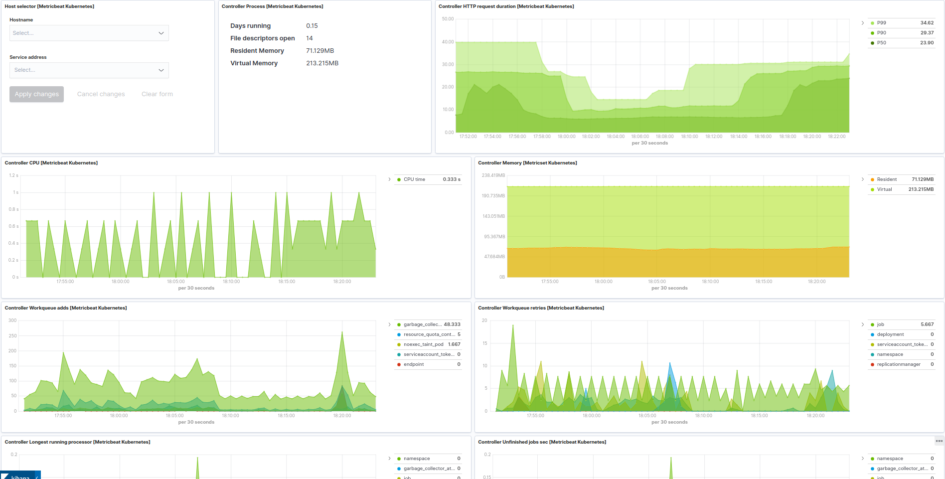

Kubernetes controller manager example:
metricbeat kubernetes controllermanager

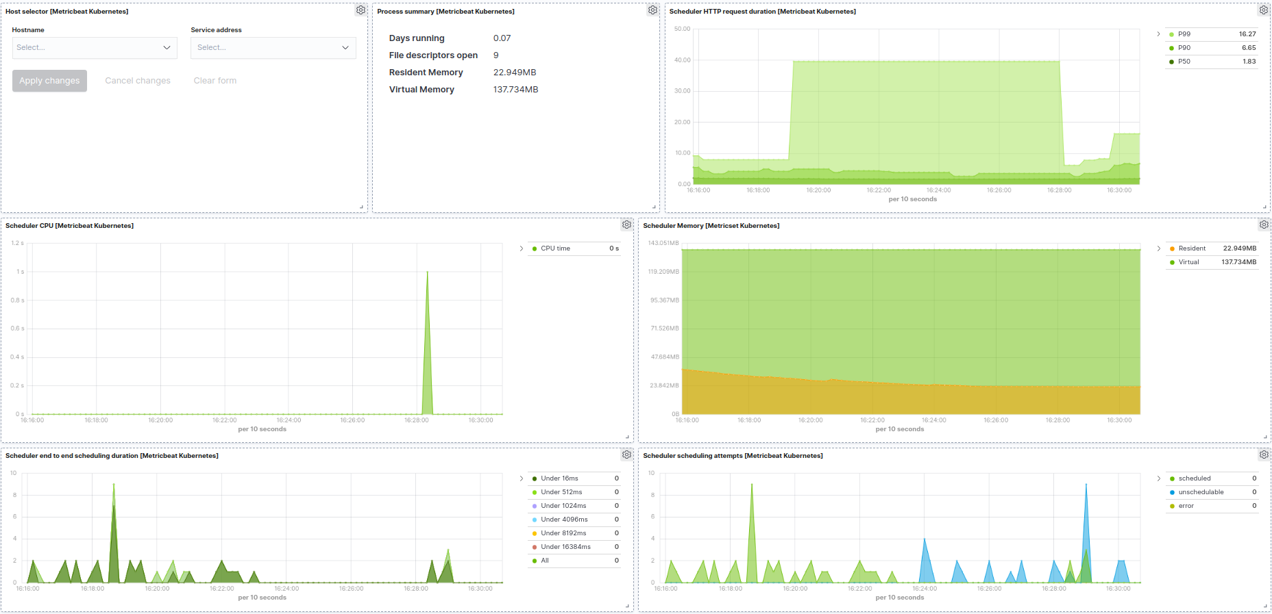

Kubernetes scheduler example:
metricbeat kubernetes scheduler

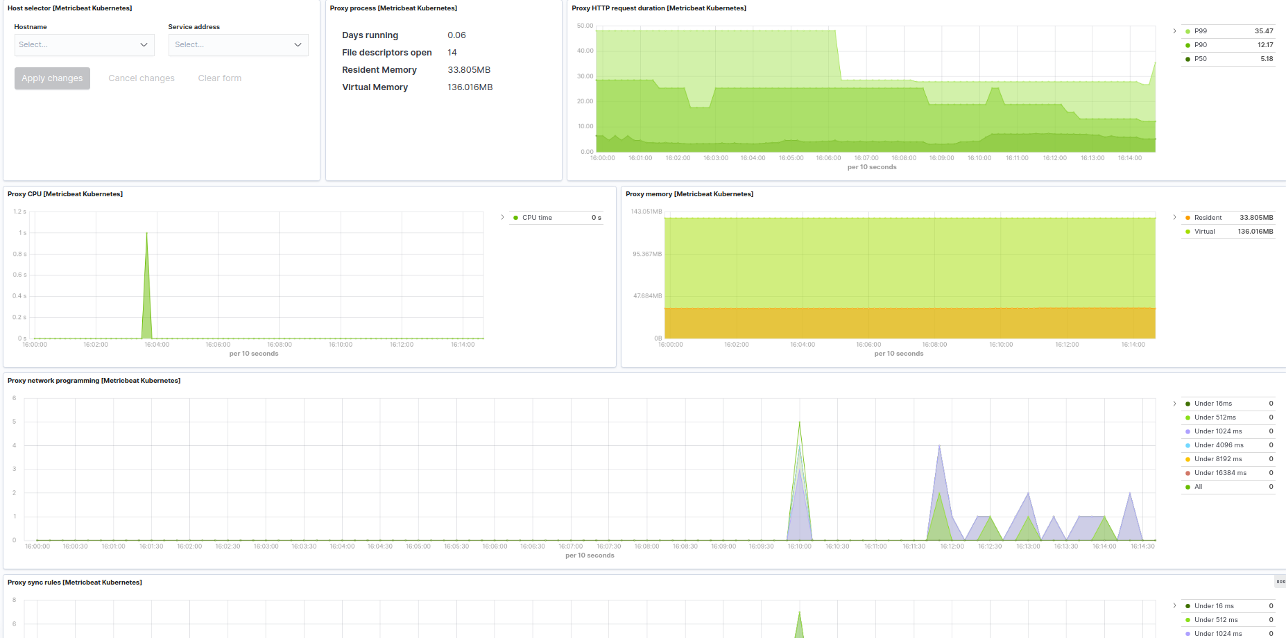

Kubernetes proxy example:
metricbeat kubernetes proxy
