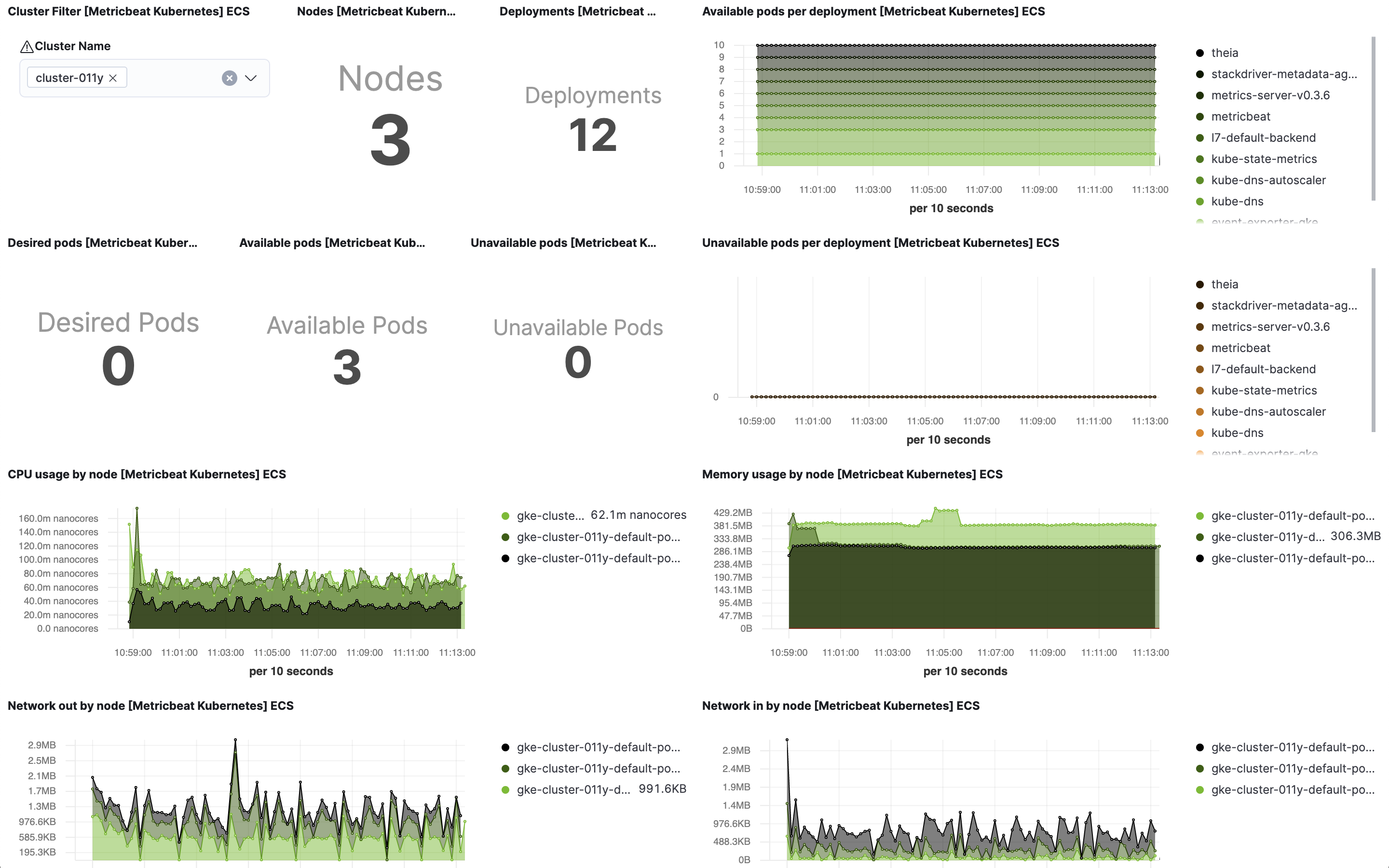

Cluster selector in cluster overview
dashboard helps in distinguishing and filtering metrics collected from multiple clusters. If you want to focus on a subset of the Kubernetes clusters for monitoring a specific scenario, this cluster selector could be a handy tool. Note that this selector gets populated from the orchestrator.cluster.name
field that may not always be available. This field gets its value from sources like kube_config
, kubeadm-config
configMap, and Google Cloud’s meta API for GKE. If the sources mentioned above don’t provide this value, metricbeat will not report it. However, you can always use add_fields processor to set orchestrator.cluster.name
fields and utilize it in the cluster overview
dashboard:
processors: - add_fields: target: orchestrator.cluster fields: name: clusterName url: clusterURL
Kubernetes cluster overview example:
![metricbeat kubernetes clusteroverview](./images/metricbeat-kubernetes-clusteroverview.png)
If you are setting collection period to a value bigger than 2m
you will need to increase
the Interval (in Panel Options) for "Desired Pods", "Available Pods" and "Unavailable Pods" visualisations.

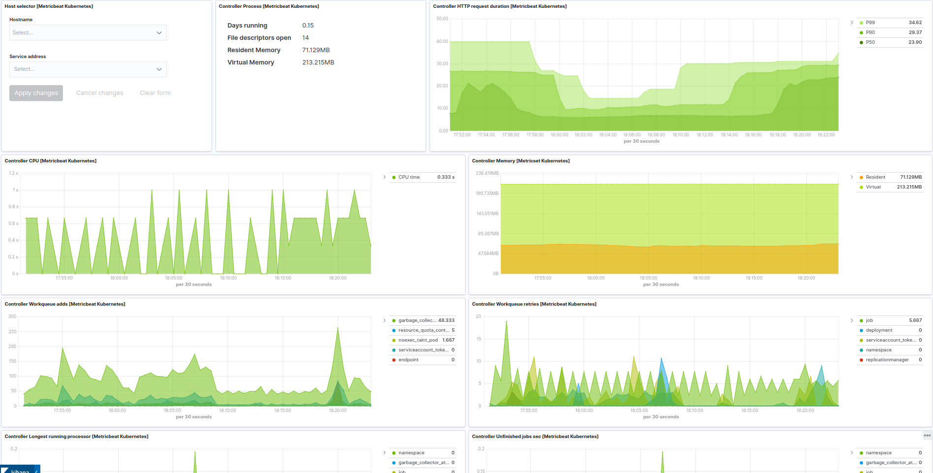

Kubernetes controller manager example:
![metricbeat kubernetes controllermanager](./images/metricbeat-kubernetes-controllermanager.png)

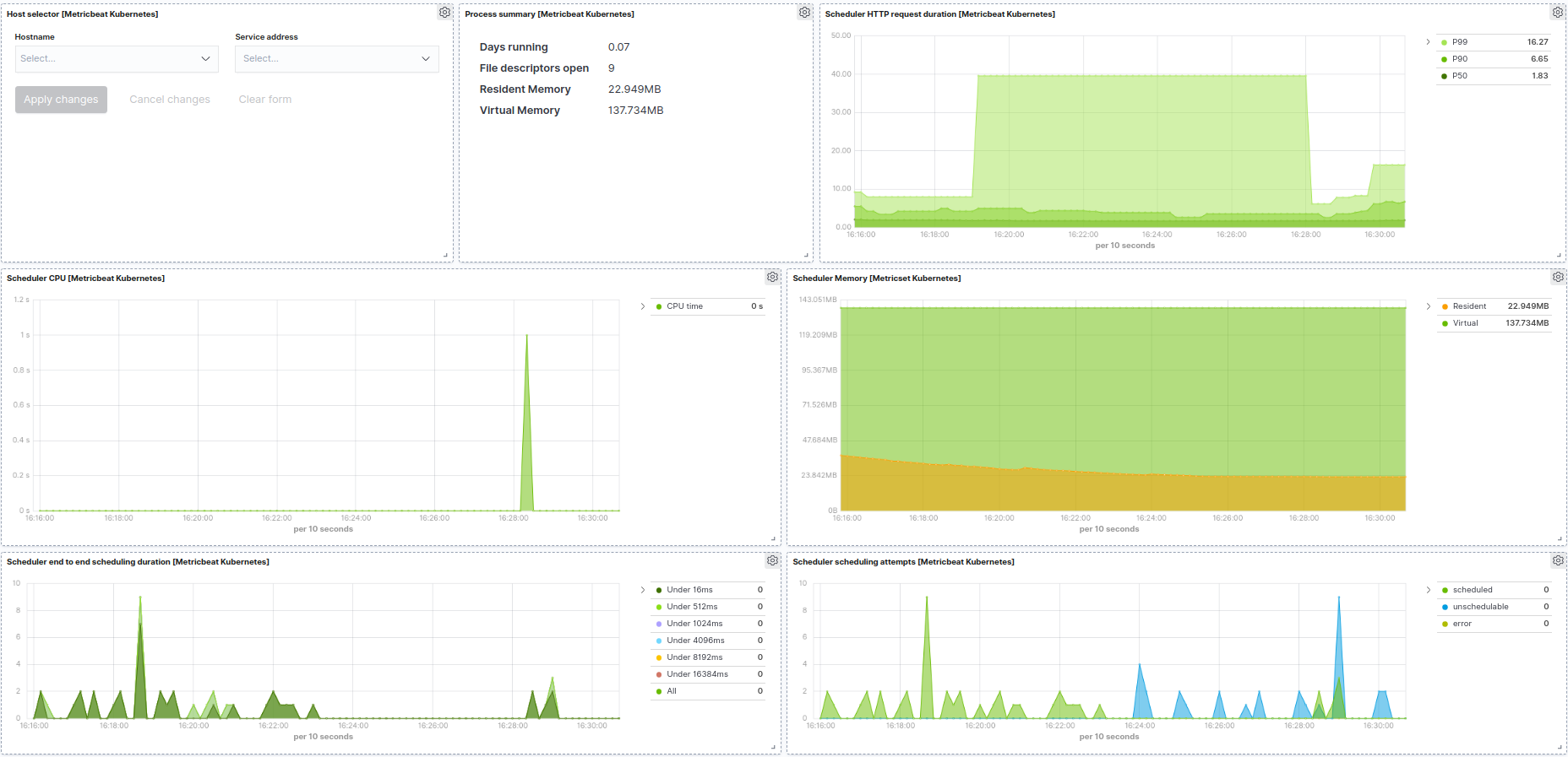

Kubernetes scheduler example:
![metricbeat kubernetes scheduler](./images/metricbeat_kubernetes_scheduler.png)

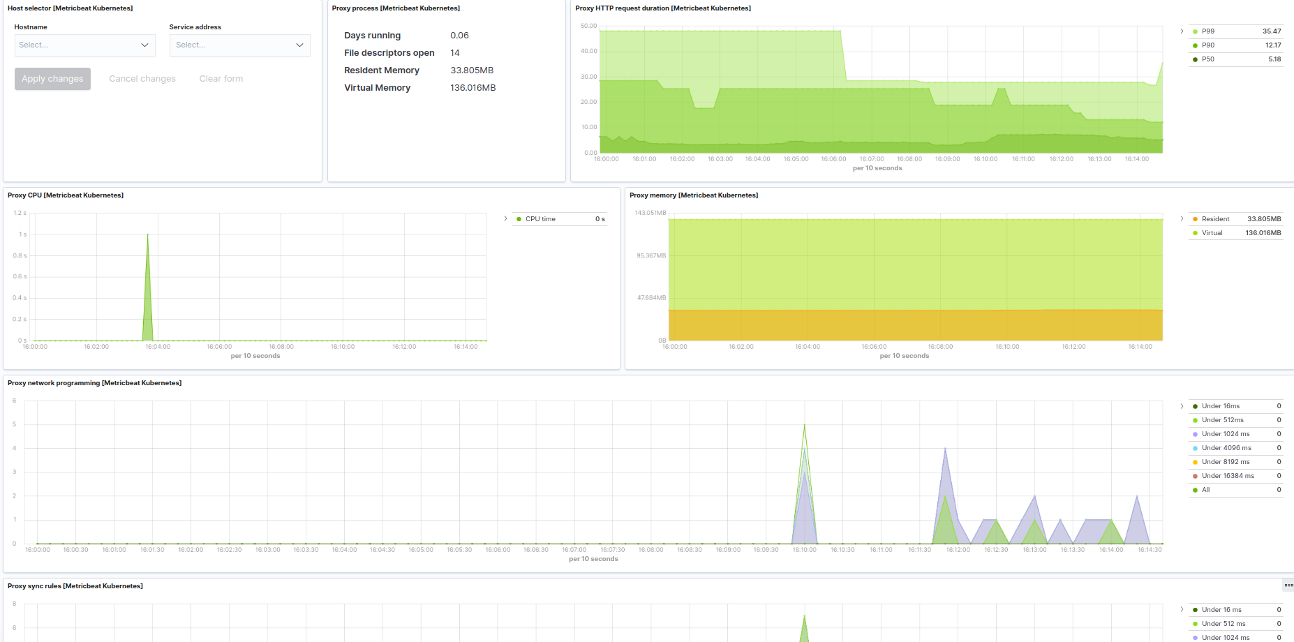

Kubernetes proxy example:
![metricbeat kubernetes proxy](./images/metricbeat-kubernetes-proxy.png)
