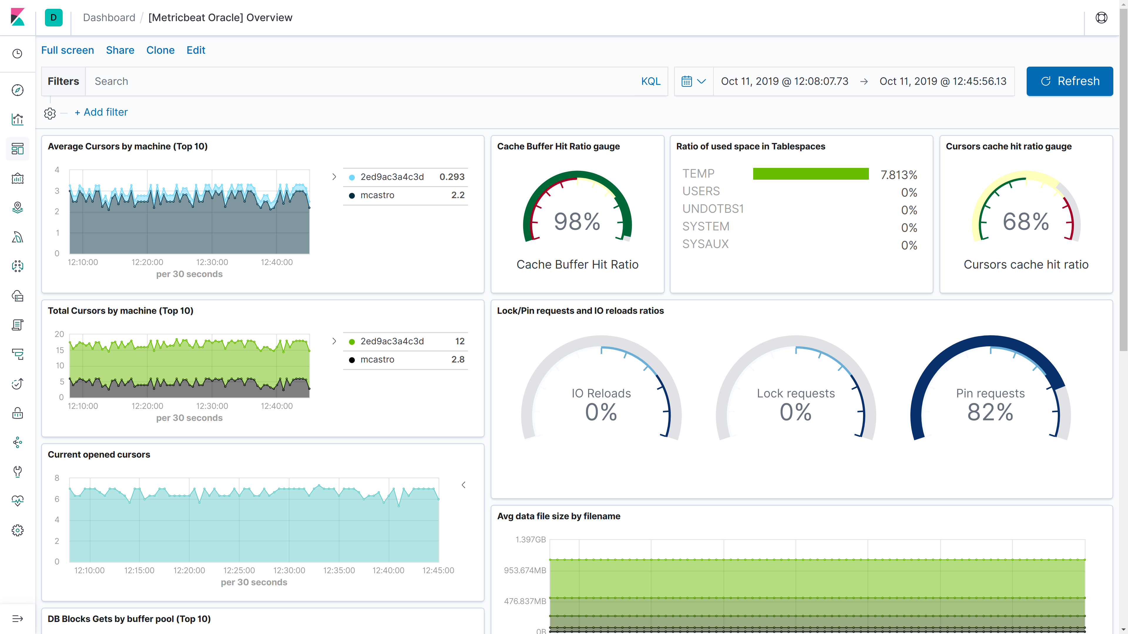

Dashboard
An overview dashboard for Kibana is already included:
metricbeat oracle overview
