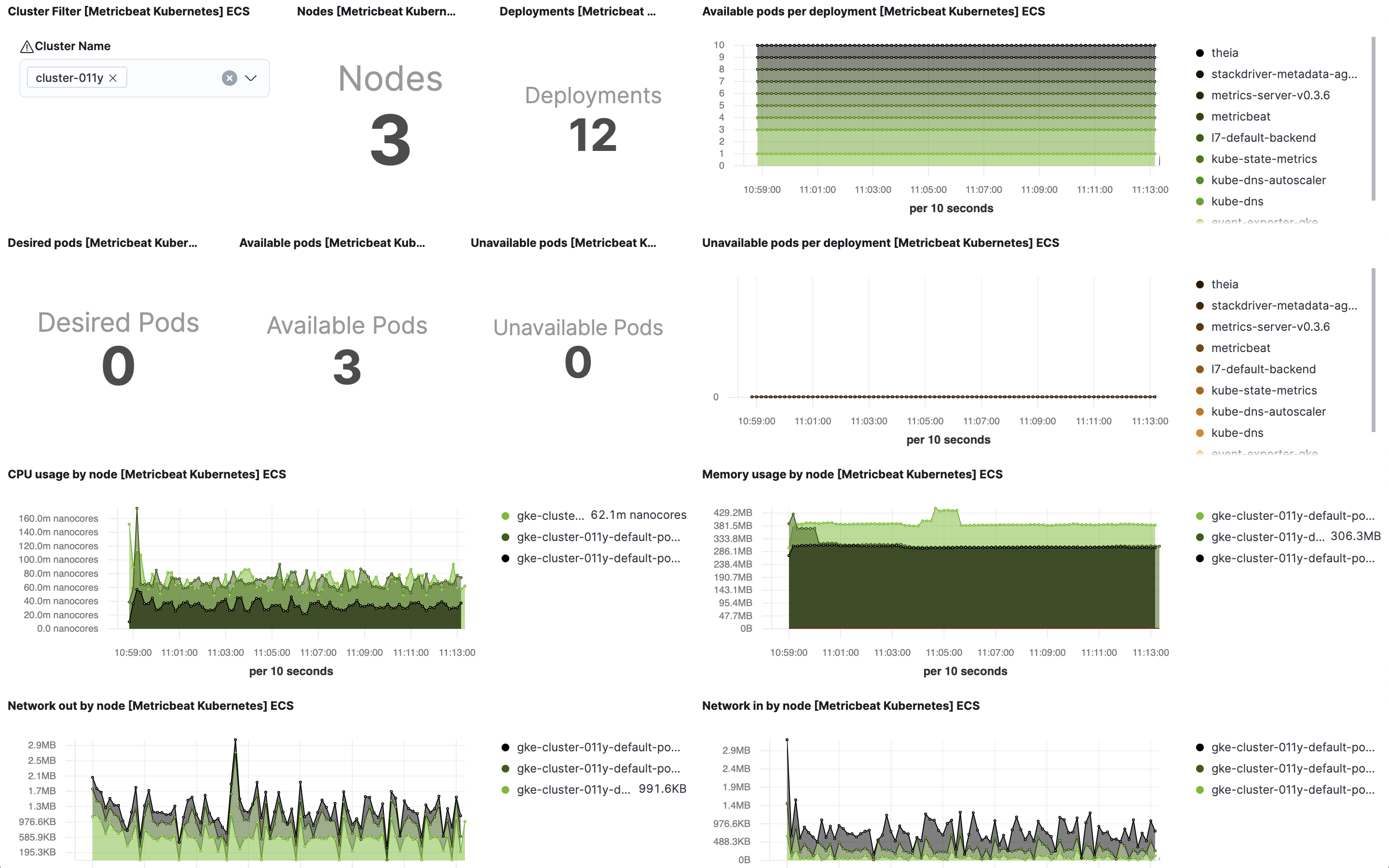

Cluster selector in cluster overview dashboard helps in distinguishing and filtering metrics collected from multiple clusters. If you want to focus on a subset of the Kubernetes clusters for monitoring a specific scenario, this cluster selector could be a handy tool. Note that this selector gets populated from the orchestrator.cluster.name field that may not always be available. This field gets its value from sources like kube_config, kubeadm-config configMap, and Google Cloud’s meta API for GKE. If the sources mentioned above don’t provide this value, metricbeat will not report it. However, you can always use add_fields processor to set orchestrator.cluster.name fields and utilize it in the cluster overview dashboard:
processors:
  - add_fields:
      target: orchestrator.cluster
      fields:
        url: clusterURL
Kubernetes cluster overview example:
metricbeat kubernetes clusteroverview

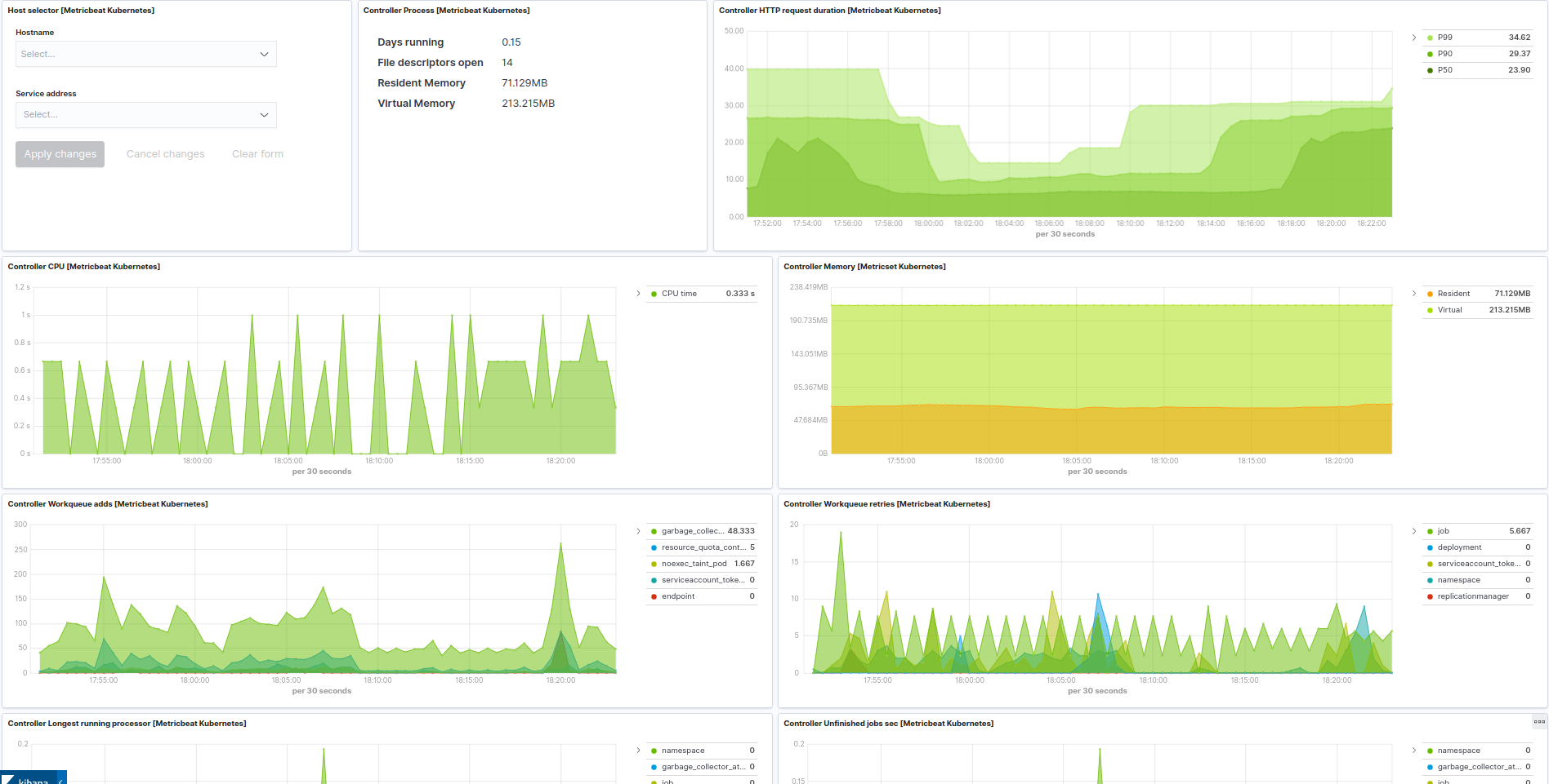

Kubernetes controller manager example:
metricbeat kubernetes controllermanager

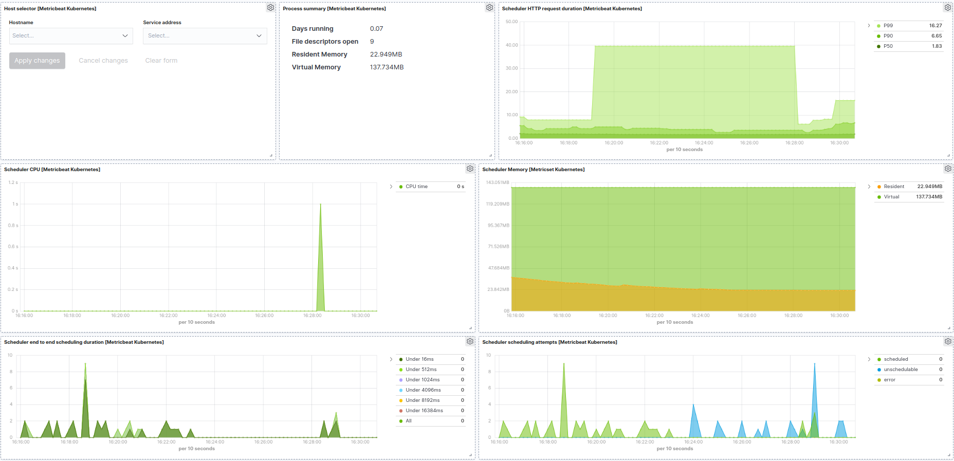

Kubernetes scheduler example:
metricbeat kubernetes scheduler

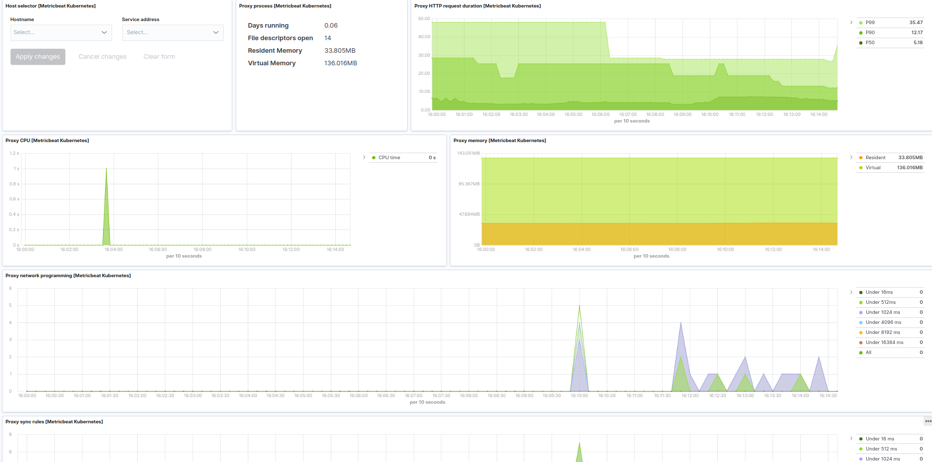

Kubernetes proxy example:
metricbeat kubernetes proxy
