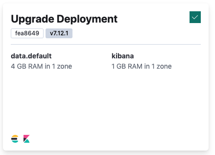

endpoint to get a list of the deployments which have Elasticsearch resources that need upgrading. Here, we query for deployments on Elastic Stack version 7.12.1, and we find a deploymentUpgrade Deployment
. To test try this example, you can use the API or the UI to create a deployment on a previous stack version, and then search for it as shown:curl -k -X POST -H "Authorization: ApiKey $ECE_API_KEY" https://$COORDINATOR_HOST:12443/api/v1/deployments/_search -H 'content-type: application/json' -d '{ "query": { "nested" : { "path" : "resources.elasticsearch", "query" : { "bool" : { "must" : [{ "match" : {"resources.elasticsearch.info.plan_info.current.plan.elasticsearch.version" : { "query" : "7.12.1"}} }] } } } }, "size": 100, "sort": [{"metadata.last_modified": { "order": "desc"}}] } '
{ "return_count" : 1, "match_count" : 1, "deployments" : [ { "id" : "DEPLOYMENT_ID", "name" : "Upgrade Deployment", "healthy" : true, "resources" : { ... "elasticsearch": { "version": "7.12.1" }, ... }
Just for reference, here is the same deployment in the UI:

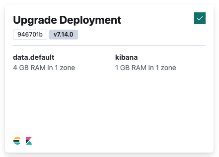

After the upgrade operation completes, the Elasticsearch and Kibana resource will be at version 7.14.0. You can confirm that by running:
curl -k -X GET -H "Authorization: ApiKey $ECE_API_KEY" https://$COORDINATOR_HOST:12443/api/v1/deployments/$DEPLOYMENT_ID
"elasticsearch" : { "version" : "7.14.0" }, ... "kibana" : { "version" : "7.14.0", }
You can also confirm the change in the UI:
