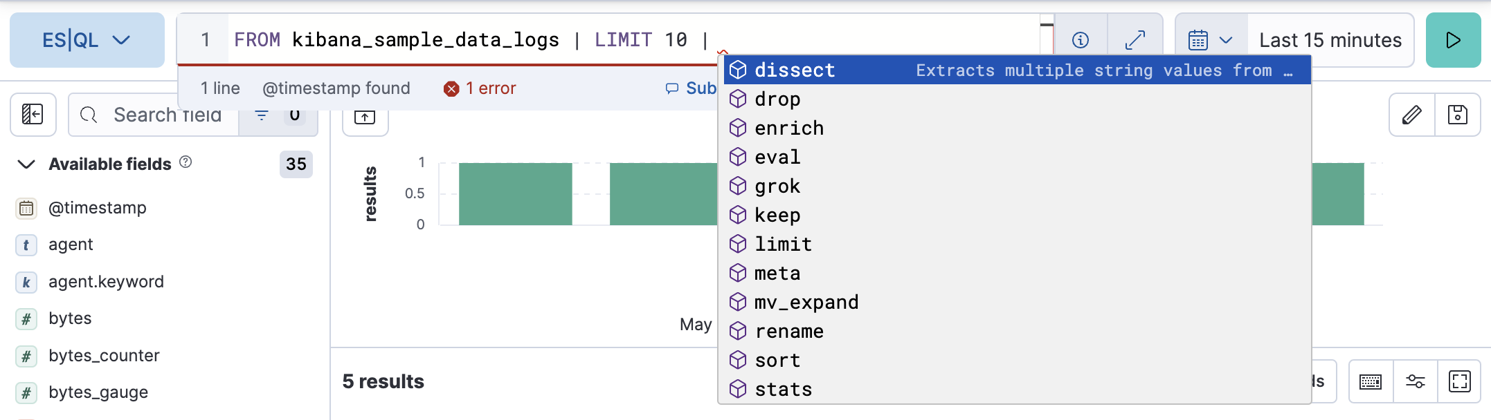

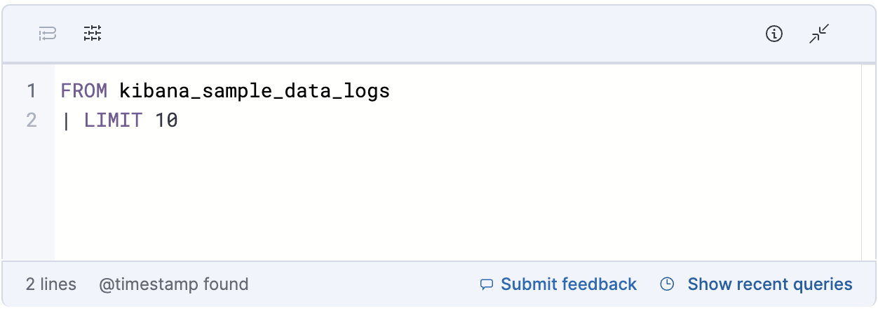

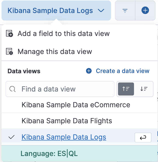

In Kibana, you can use Console or Discover to run ES|QL queries:
To get started with ES|QL in Console, open the main menu and select Dev Tools.
