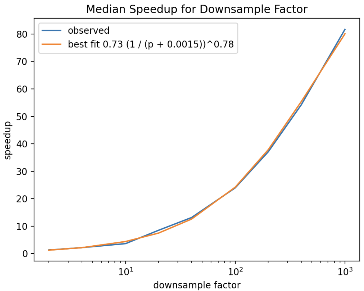

This type of sampling provides almost linear improvement in query latency in relation to the amount by which sampling reduces the document set size:
Graph of the median speedup by sampling factor
This graph is typical of the speed up for the majority of aggregations for a test data set of 63 million documents. The exact constants will depend on the data set size and the number of shards, but the form of the relationship between speed up and probability holds widely. For certain aggregations, the speed up may not be as dramatic. These aggregations have some constant overhead unrelated to the number of documents seen. Even for those aggregations, the speed improvements can be significant.
The sample set is generated by skipping documents using a geometric distribution ((1-p)^(k-1)*p) with success probability being the provided probability (p in the distribution equation). The values returned from the distribution indicate how many documents to skip in the background. This is equivalent to selecting documents uniformly at random. It follows that the expected number of failures before a success is (1-p)/p. For example, with the "probability": 0.01, the expected number of failures (or average number of documents skipped) would be 99 with a variance of 9900. Consequently, if you had only 80 documents in your index or matched by your filter, you would most likely receive no results.

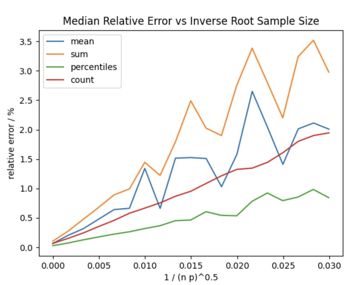

Graph of the relative error by sampling probability and doc count
In the above image p is the probability provided to the aggregation, and n is the number of documents matched by whatever query is provided. You can see the impact of outliers on sum and mean, but when many documents are still matched at higher sampling rates, the relative error is still low.
This represents the result of aggregations against a typical positively skewed APM data set which also has outliers in the upper tail. The linear dependence of the relative error on the sample size is found to hold widely, but the slope depends on the variation in the quantity being aggregated. As such, the variance in your own data may cause relative error rates to increase or decrease at a different rate.
