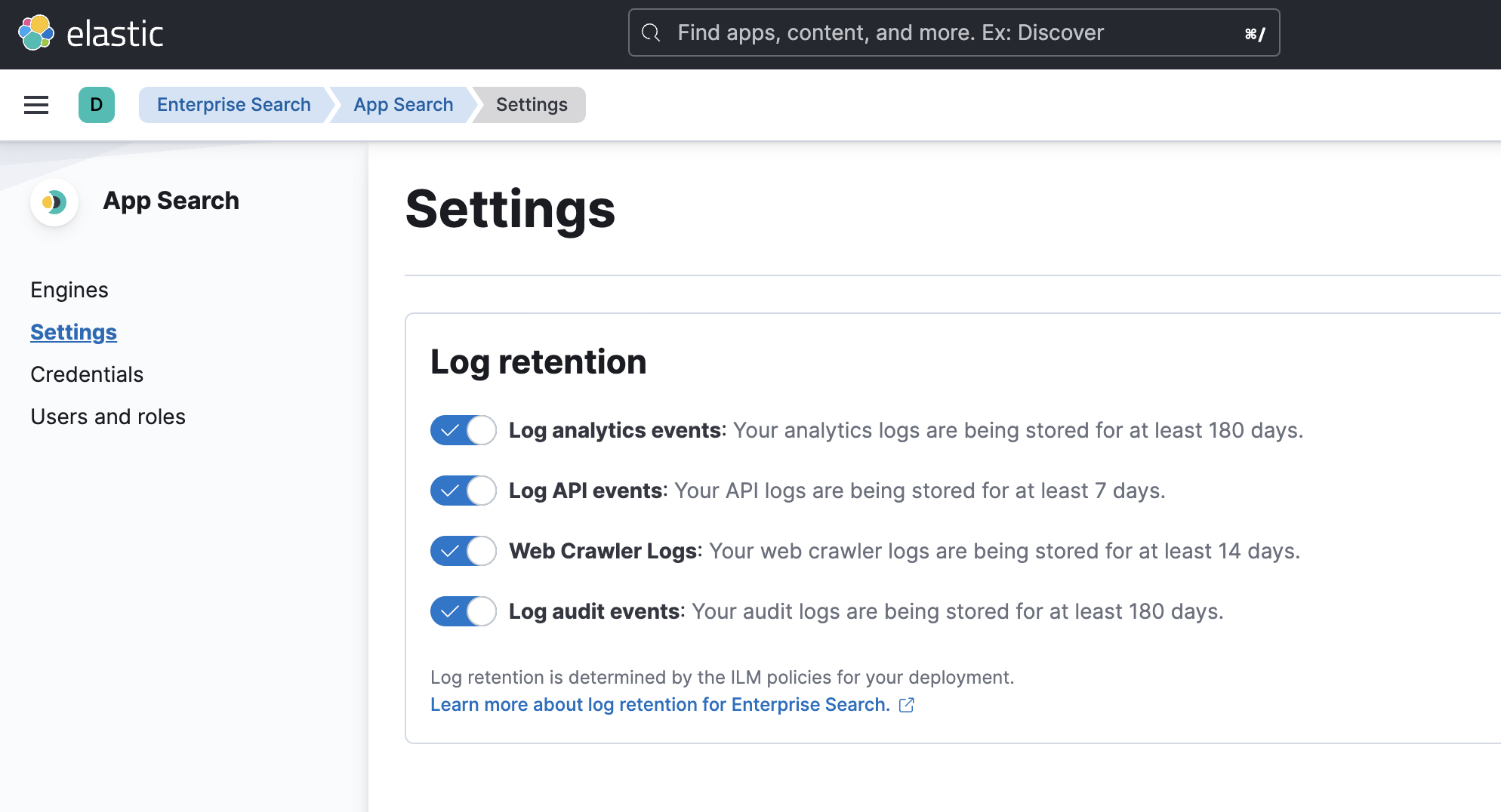

Enabling and disabling audit log event streams
Audit logging can be enabled and disabled from the App Search Settings page. Audit logs are enabled by default. Disabling them disables them for both App Search and Workplace Search.
App Search Settings page with Log audit events toggle

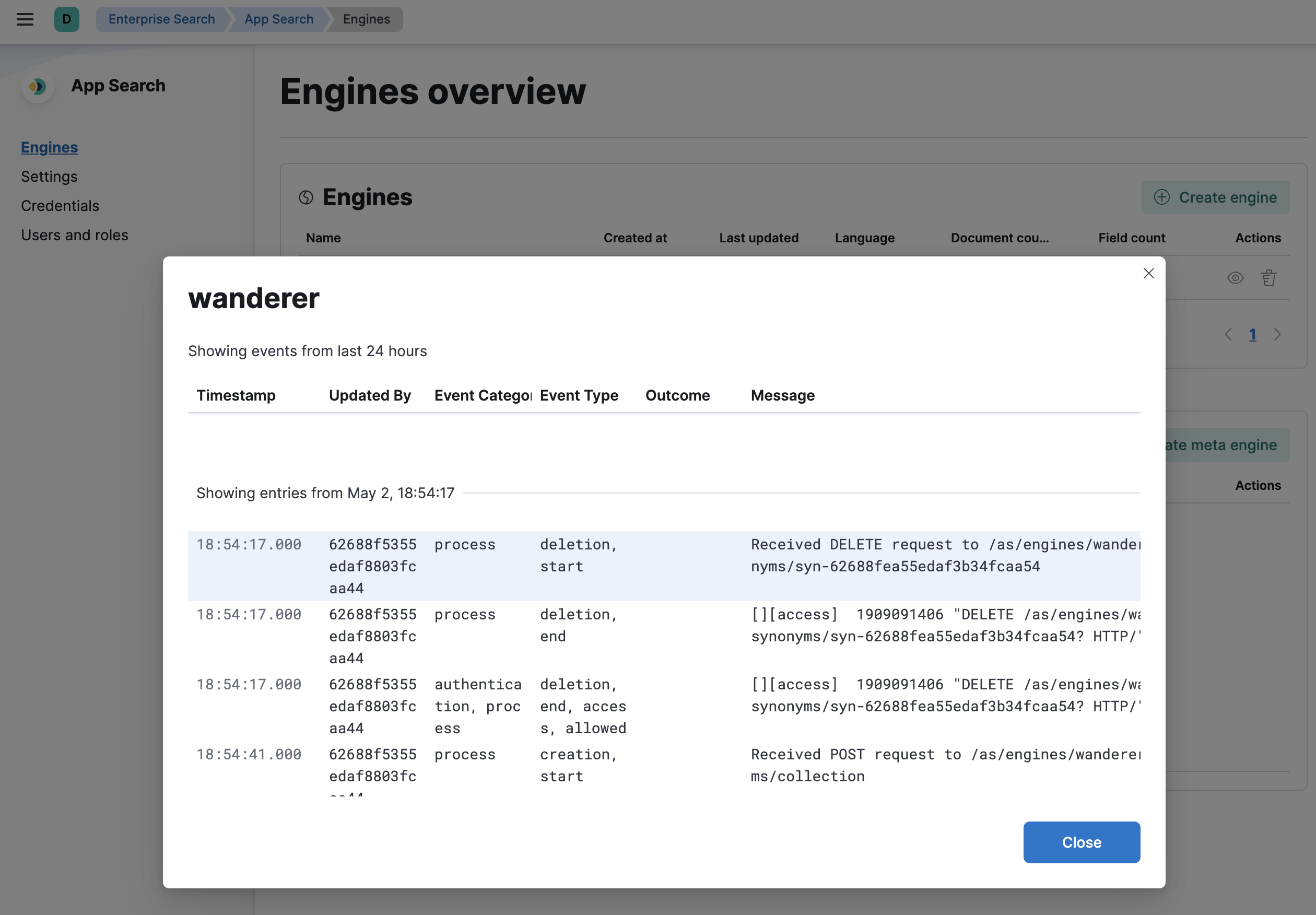

Viewing audit events in App Search
Audit log events that pertain to an engine can be viewed directly within the Engine Overview page by clicking the "Last Updated" timestamp in Engine Table.
App Search engine audit log events table
