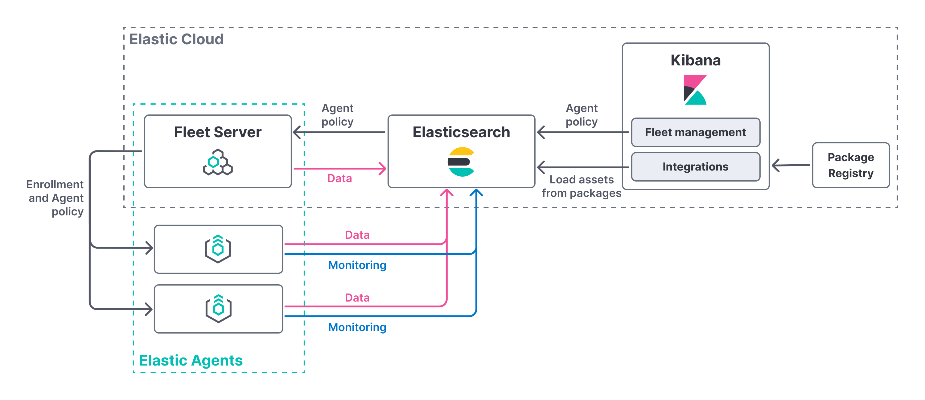

Fleet Server can be provisioned and hosted on Elastic Cloud. When the Cloud deployment is created, a highly available set of Fleet Servers is provisioned automatically.
This approach might be right for you if you want to reduce on-prem compute resources and you’d like Elastic to take care of provisioning and life cycle management of your deployment.
With this approach, multiple Fleet Servers are automatically provisioned to satisfy the chosen instance size (instance sizes are modified to satisfy the scale requirement). You can also choose the resources allocated to each Fleet Server and whether you want each Fleet Server to be deployed in multiple availability zones. If you choose multiple availability zones to address your fault-tolerance requirements, those instances are also utilized to balance the load.
This approach might not be right for you if you have restrictions on connectivity to the internet.
Fleet Server Cloud deployment model
