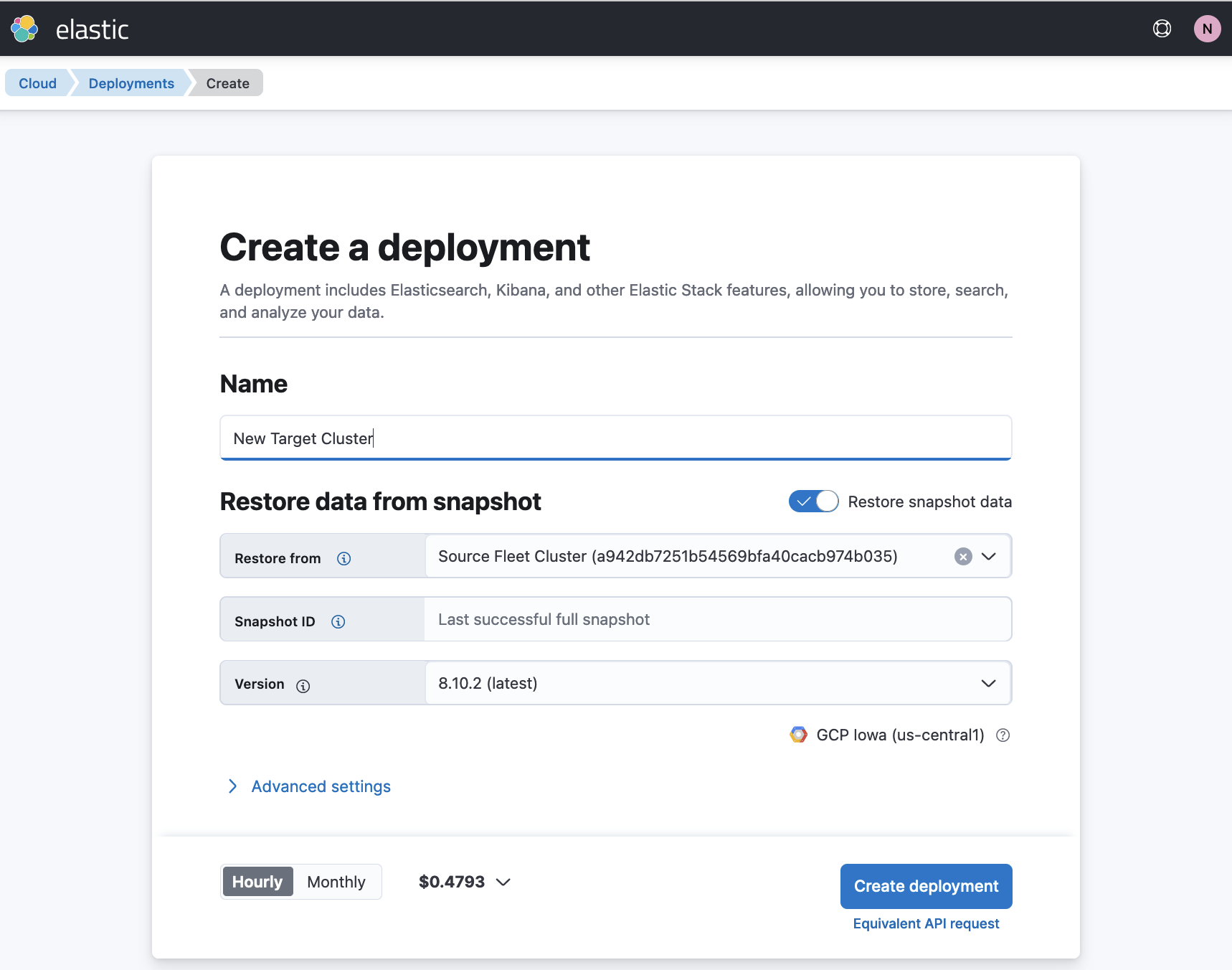

  1. Open the Elastic Cloud console and select Create deployment.
  2. Select Restore snapshot data.
  3. In the Restore from field, select your source deployment.
  4. Choose your deployment settings, and, optimally, choose the same Elastic Stack version as the source cluster.
  5. Click Create deployment.

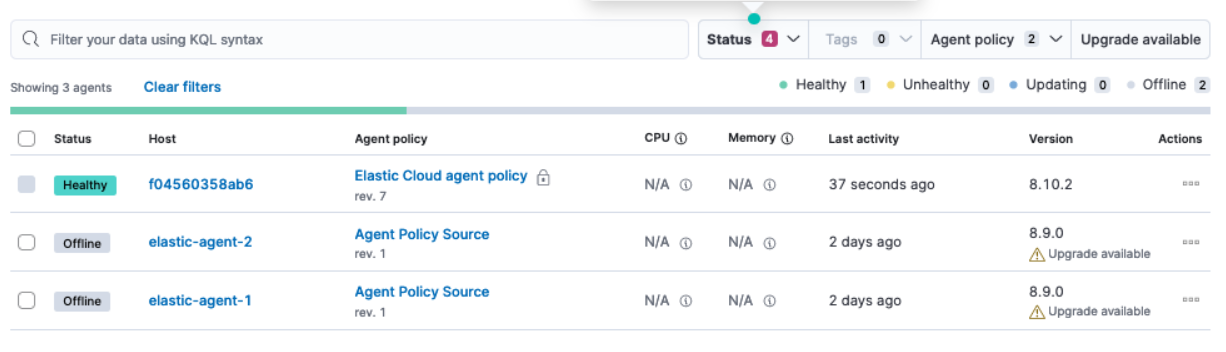

  2. On the Agents tab, your agents should visible, however they’ll appear as Offline. This is because these agents have not yet enrolled in the new, target cluster, and are still enrolled in the original, source cluster.
    Agents tab in Fleet showing offline agents

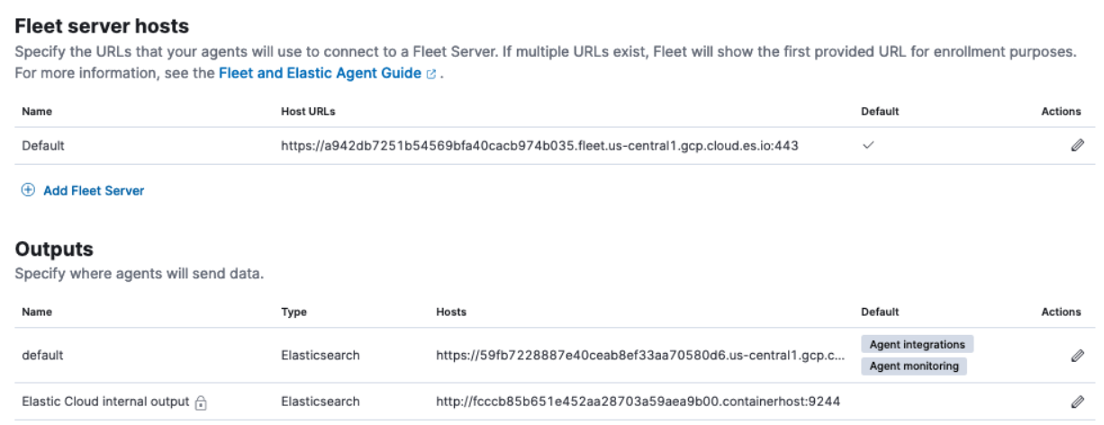

  4. Examine the configurations captured there for Fleet. Note that these settings are scopied from the snapshot of the source cluster and may not have a meaning in the target cluster, so they need to be modified accordingly.
    In the following example, both the Fleet Server hosts and the Outputs settings are copied over from the source cluster:
    Settings tab in Fleet showing source deployment host and output settings

  1. In the new target cluster on Elastic Cloud, in the Outputs section, on the Fleet Settings tab, you will find an internal output named Elastic Cloud internal output. The host address is in the form:
    https://<cluster-id-target>.containerhost:9244
    Record this <cluster-id-target> from the target cluster. In the example shown, the ID is fcccb85b651e452aa28703a59aea9b00.

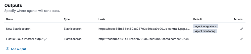

  2. Also in the Outputs section, notice that the default Elasticsearch output (that was copied over from the source cluster) is also in the form:
    https://<cluster-id-source>.<cloud endpoint address>:443.
    Modify the Elasticsearch output so that the cluster ID is the same as that for Elastic Cloud internal output. In this example we also rename the output to New Elasticsearch.
    Outputs section showing the new Elasticsearch host setting
    In this example, the New Elasticsearch output and the Elastic Cloud internal output now have the same cluster ID, namely fcccb85b651e452aa28703a59aea9b00.
You have now created an Elasticsearch output that agents can use to write data to the new, target cluster. For on-premise environments not using Elastic Cloud, you should similarly be able to use the host address of the new cluster.

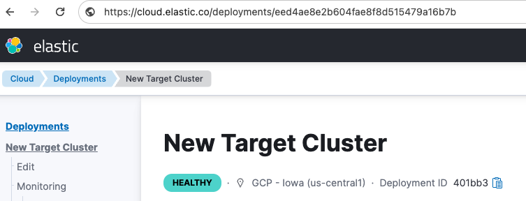

The easiest way to find the deployment-id is from the deployment URL:
  1. From the Kibana menu select Manage this deployment.
  2. Copy the deployment ID from the URL in your browser’s address bar.
    Deployment management page
    In this example, the new deployment ID is eed4ae8e2b604fae8f8d515479a16b7b.

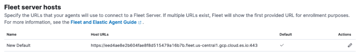

  3. In the target cluster, under Fleet server hosts, replace the original host URL with the new value.
    Fleet server hosts showing the new host URL

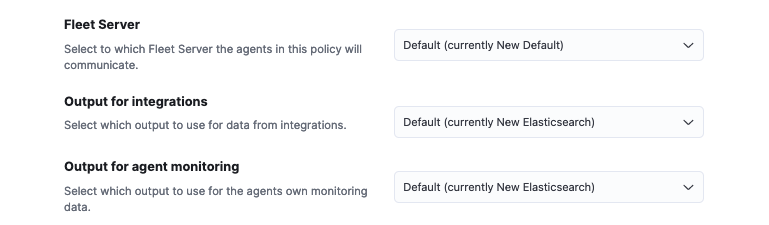

  4. Ensure that Fleet Server, Output for integrations, and Output for agent monitoring are all set to the newly created entities.
    An agent policy’s settings showing the newly created entities
If you modified the Fleet Server and the output in place these would have been updated accordingly. However if new entities are created, then ensure that the correct ones are referenced here.

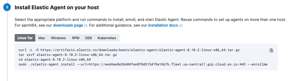

  3. In the section Install Elastic Agent on your host, find the sample install command. This contains the details you’ll need to enroll the agents, namely the enrollment token and the Fleet Server URL.
  4. Copy the portion of the install command containing these values. That is, –url=<path> –enrollment-token=<token for the new policy>.
    Install command from the Add Agent UI

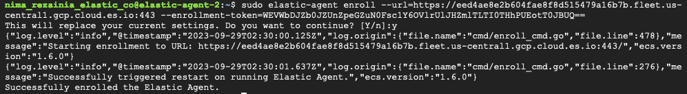

  5. On the host machines where the current agents are installed, enroll the agents again using this copied URL and the enrollment token:
    sudo elastic-agent enroll --url=<fleet server url> --enrollment-token=<token for the new policy>
    The command output should be like the following:
    Install command output

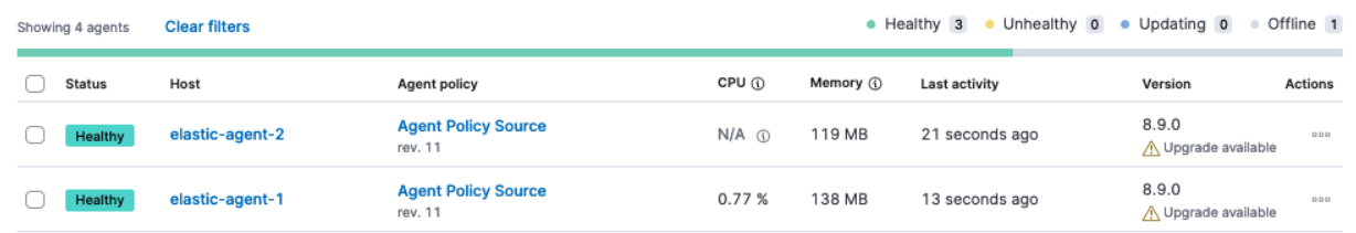

  6. The agent on each host will now check into the new Fleet Server and appear in the new target cluster. In the source cluster, the agents will go offline as they won’t be sending any check-ins.
    Newly enrolled agents in the target cluster
