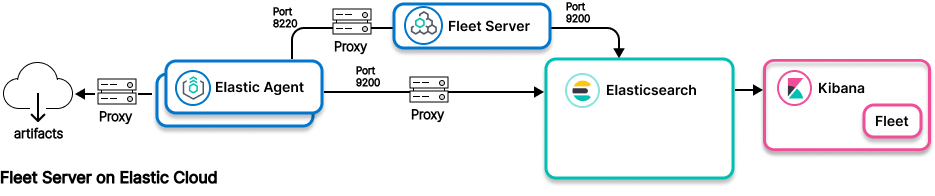

Image showing connections between Elastic Agent and Elasticsearch using a proxy when Fleet Server is managed by Elastic

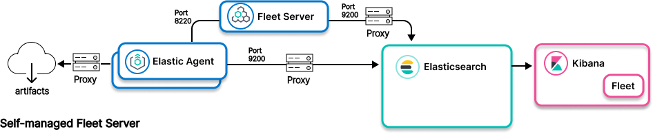

This architecture works with a variety of proxying tools to allow for more flexibility in your environment. Consider using Logstash as a proxy, as Logstash and the rest of the Elastic Stack are designed and tested to work together, and can be easier to support.
Ingest model
Control path for Fleet Server on Elastic Cloud: Elastic Agent to proxy to Fleet Server to Elasticsearch
Control path for self-managed Fleet Server: Elastic Agent to Fleet Server to proxy to Elasticsearch
Data path: Elastic Agent to proxy to Elasticsearch
