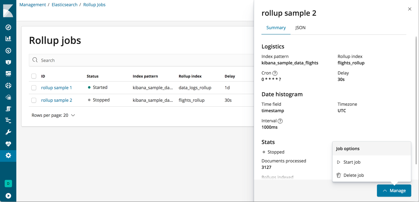

Managing rollup jobs
Selecting a job on the Rollup jobs page shows its details. The Manage menu in the lower right enables you to start, stop, and delete the rollup job. You must first stop a rollup job before deleting it.
][Rollup job details
