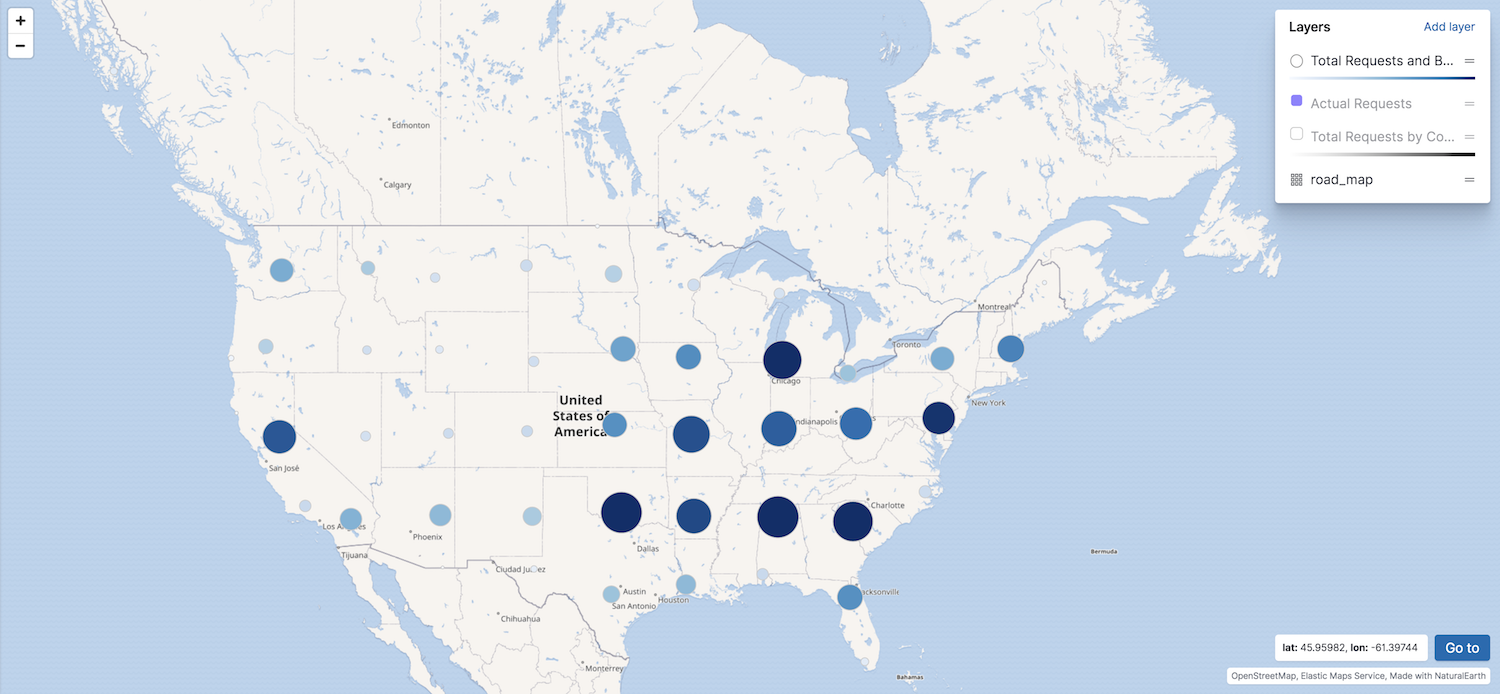

Add a vector layer from the grid aggregation source

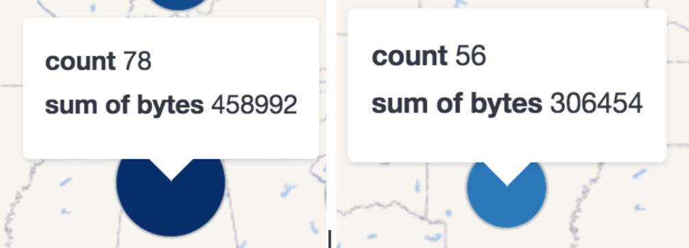

editAggregations group Elasticsearch documents into grids. You can calculate metrics for each gridded cell.
You’ll create a layer for aggregated data and make it visible only when the map is zoomed out past zoom level 9. Darker colors will symbolize grids with more web log traffic, and lighter colors will symbolize grids with less traffic. Larger circles will symbolize grids with more total bytes transferred, and smaller circles will symbolize grids with less bytes transferred.
Add the layer
edit- In the map legend, click Add layer.
- Click the Grid aggregation data source.
- Set Index pattern to kibana_sample_data_logs.
- Click the Add layer button.
Set Layer name to
Total Requests and Bytes
. - Set Min zoom to 0 and Max zoom to 9.
- Set Layer transparency to 1.
Configure the aggregation metrics
edit- Click plus to the right of Metrics label.
- Select Sum in the aggregation select.
- Select bytes in the field select.
Set the vector style
edit-
In Vector style, change Symbol size:
- Set Min size to 1.
- Set Max size to 25.
- In the field select, select sum of bytes.
Click Save & close button.
Your map now looks like this:
