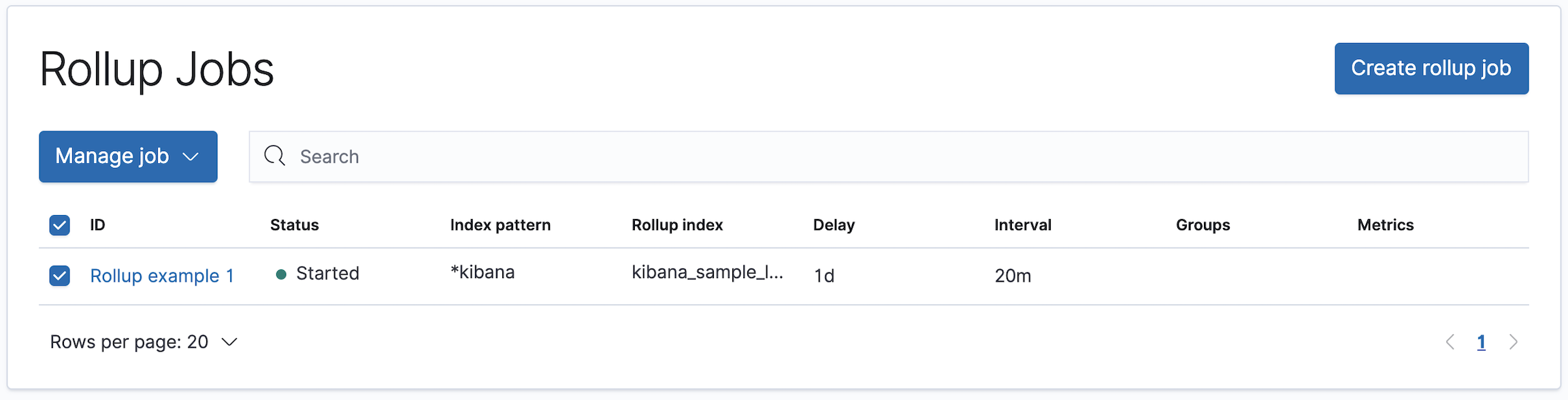

Start, stop, and delete rollup jobs
Once you’ve saved a rollup job, you’ll see it the Rollup Jobs overview page, where you can drill down for further investigation. The Manage menu enables you to start, stop, and delete the rollup job. You must first stop a rollup job before deleting it.

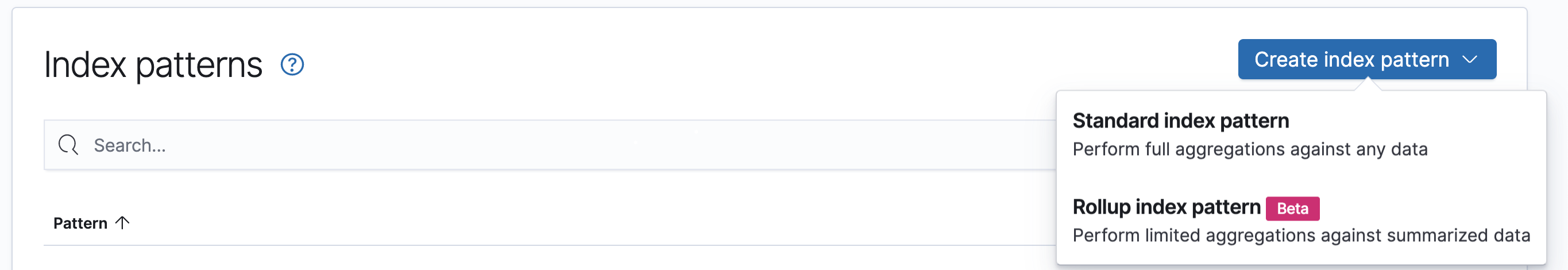

  1. Open the main menu, then click Stack Management > Index Patterns.
  2. Click Create index pattern, and select Rollup index pattern from the dropdown.
    ][Create rollup index pattern

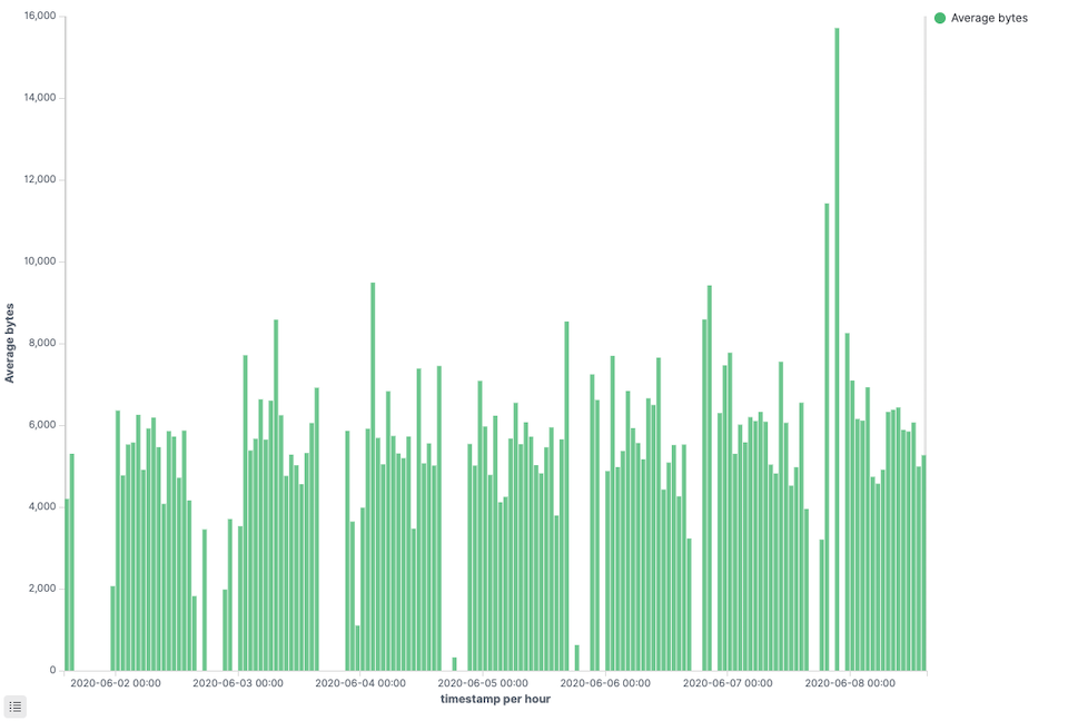

  4. Open the main menu, click Dashboard, then create and add a vertical bar chart.
  5. Choose rollup_logstash,kibana_sample_data_logs as your source to see both the raw and rolled up data.
    ][Create visualization of rolled up data
  6. Look at the data in your visualization.
    ][Visualization of rolled up data

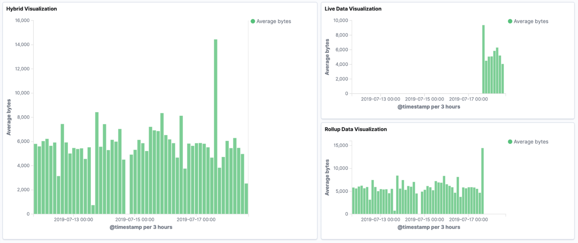

  7. Optionally, create a dashboard that contains visualizations of the rolled up data, raw data, or both.
    ][Dashboard with rolled up data
