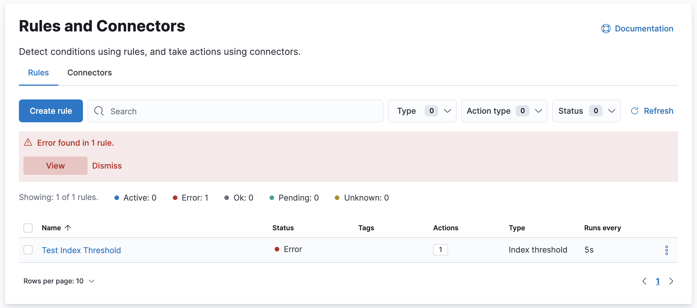

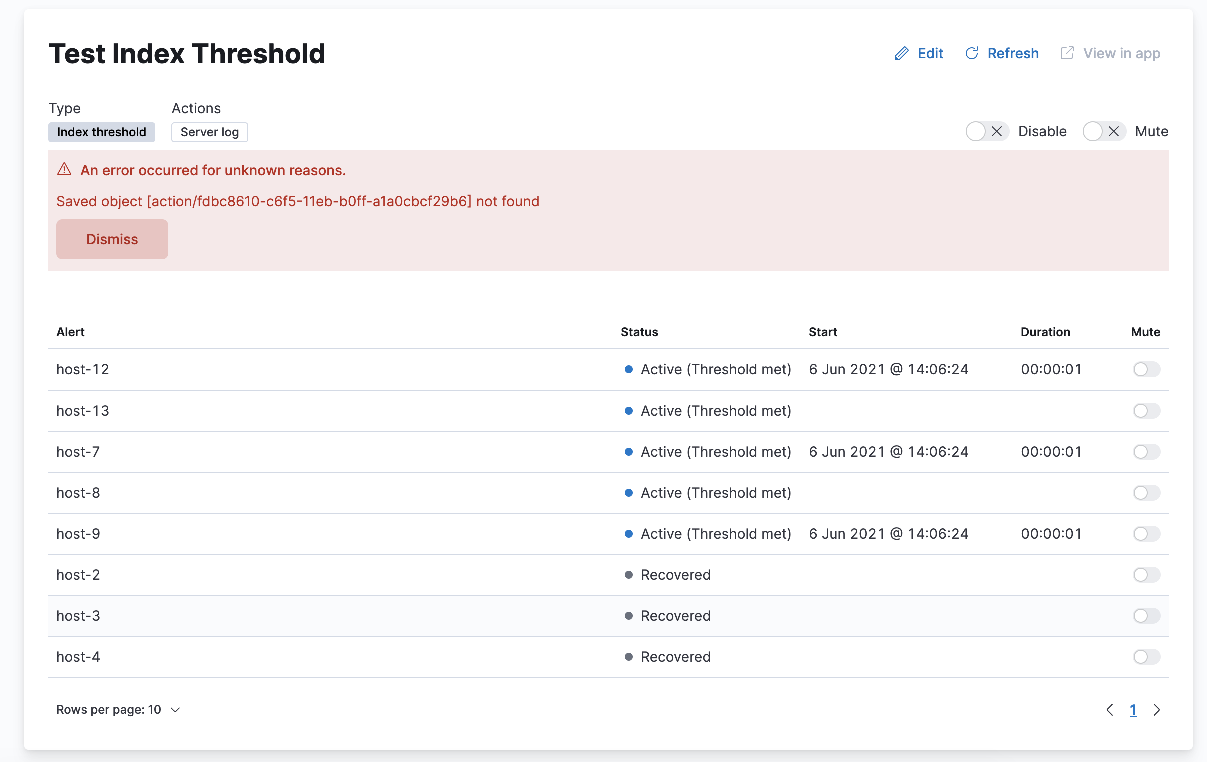

Look for error banners
The Rule Management and Rule Details pages contain an error banner, which helps to identify the errors for the rules:
Rule management page with the errors banner
Rule details page with the errors banner
