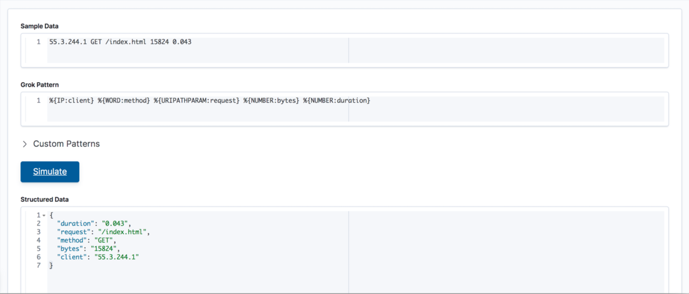

In Sample Data, enter a message that is representative of the data that you want to parse. For example:
55.3.244.1 GET /index.html 15824 0.043
In Grok Pattern, enter the grok pattern that you want to apply to the data.
To parse the log line in this example, use:
%{IP:client} %{WORD:method} %{URIPATHPARAM:request} %{NUMBER:bytes} %{NUMBER:duration}
Click Simulate.
You’ll see the simulated event that results from applying the grok pattern.
