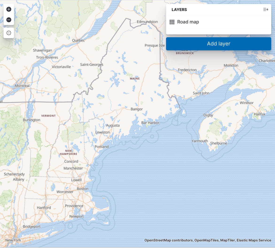

  1. Create a new map.
  2. Zoom in on the New England area in the northeast United States.
    You’re adding flight paths to this area, and this sets up the map for a good view of the data.
    fu gs new england map

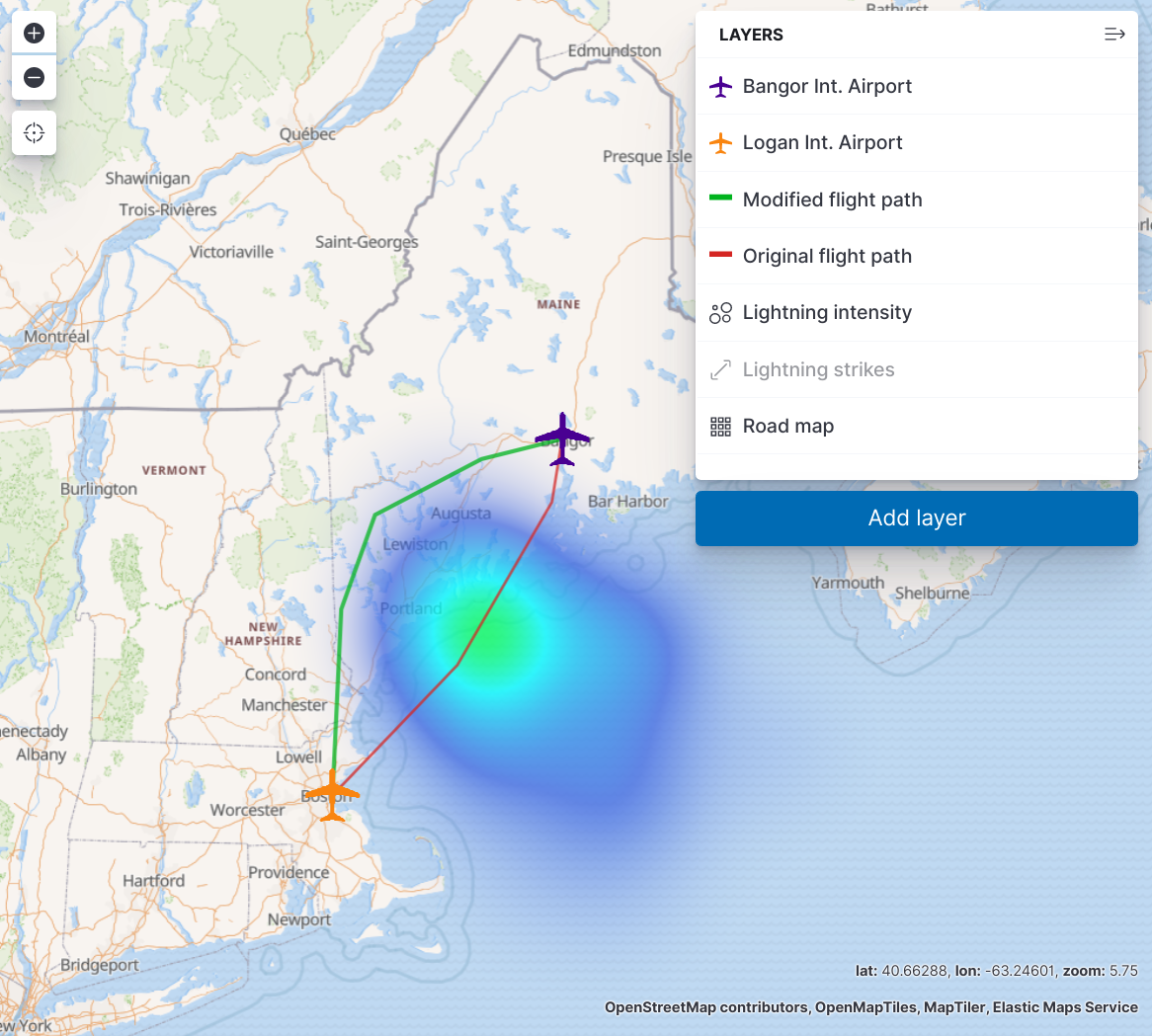

    With your new lightning heat map layer, your map should look like this:
    fu gs lightning intensity

Your final map might look like this:
fu gs final map
