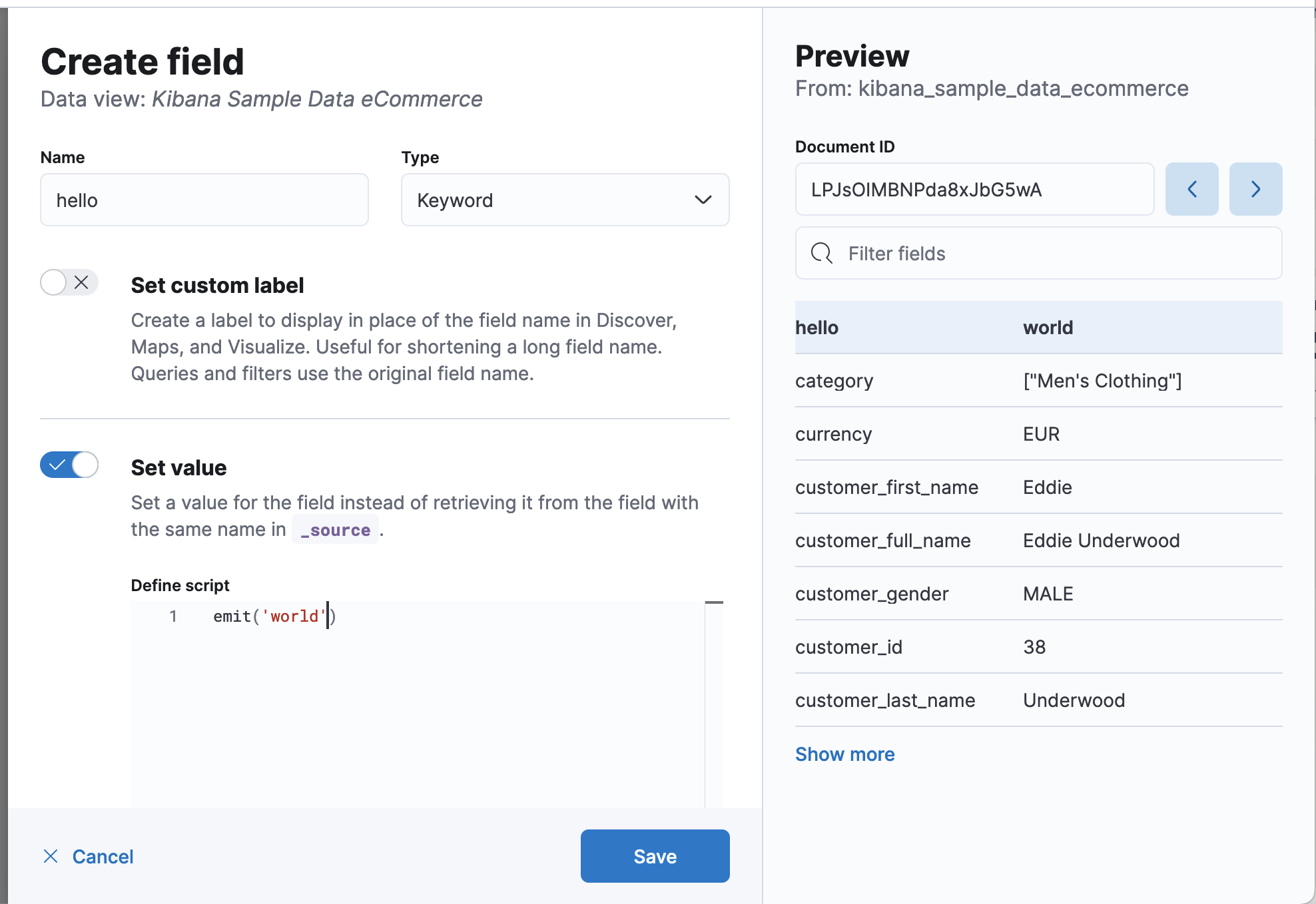

Return a keyword value
Return Hello World!:
emit("Hello World!");
Runtime field with keyword type

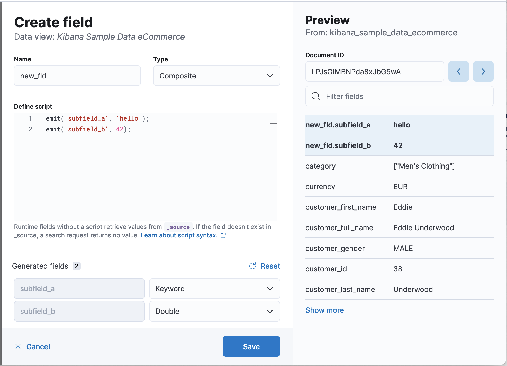

Return multiple fields with a composite runtime field
A single runtime field can also produce multiple subfields when the type Composite is selected. The script editor provides default types that can be customized for each subfields.
Return keyword and double type subfields. Note that the first argument for emit is the name of the subfield.
emit('subfield_a', 'Hello');
emit('subfield_b', 42);
Runtime field with composite type
