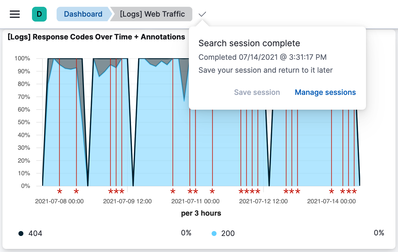

  1. Load your dashboard.
    Your search session begins automatically. The icon after the dashboard title displays the current state of the search session. A clock icon indicates the search session is in progress. A checkmark indicates that the search session is complete.
  2. To continue a search in the background, click the clock icon, and then click Save session.
    Search Session indicator displaying the current state of the search
    Once you save a search session, you can start a new search, navigate to a different application, or close the browser.

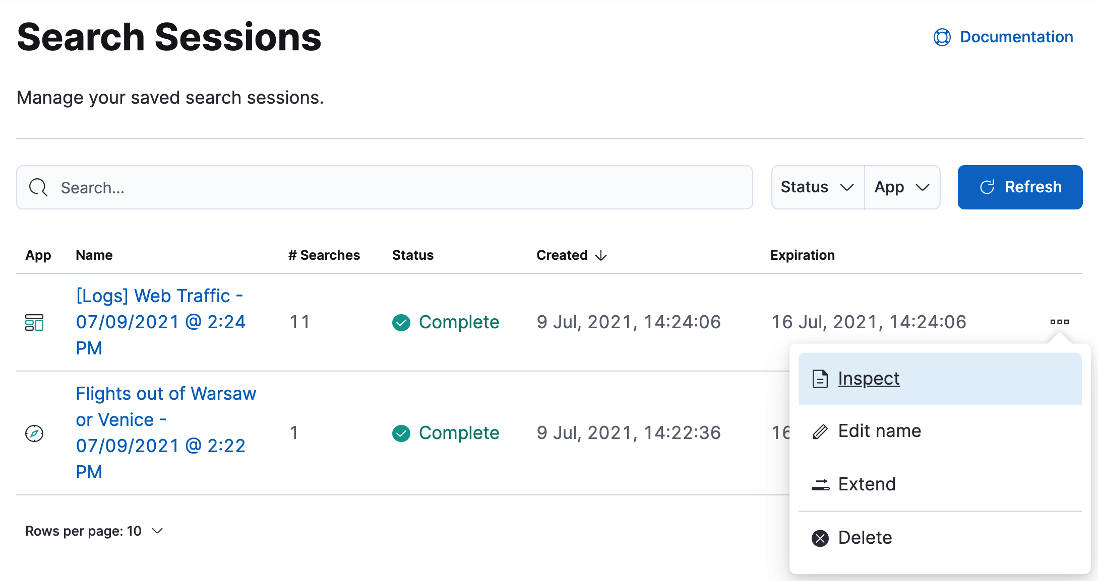

  3. To view your saved searches, open the main menu, and then click Stack Management > Search Sessions. For a saved or completed session, you can also open this view from the search sessions popup.
    Search Sessions management view with actions for inspecting
  4. Use the edit menu in Search Sessions to:
    • Inspect the queries and filters that makeup the session.
    • Edit the name of a session.
    • Extend the expiration of a completed session.
    • Delete a session.
