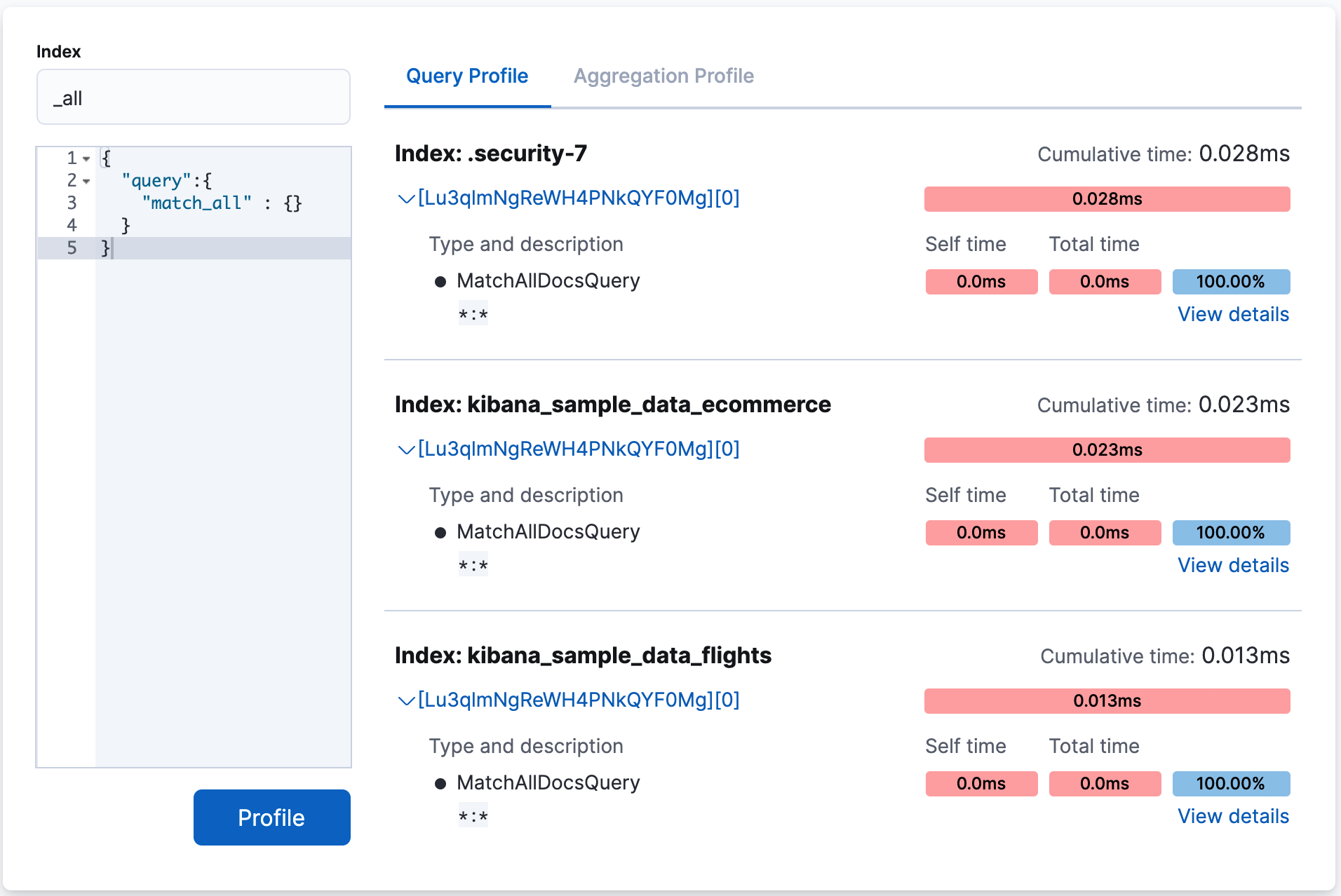

editSearch Profiler is automatically enabled in Kibana. Open the main menu, click Dev Tools, and then click Search Profiler to get started.
Search Profiler displays the names of the indices searched, the shards in each index,
and how long it took for the query to complete. To try it out, replace the default match_all
query
with the query you want to profile, and then click Profile.
The following example shows the results of profiling the match_all
query.
If you take a closer look at the information for the .security_7
sample index, the
Cumulative time field shows you that the query took 0.028ms to execute.
The cumulative time metric is the sum of individual shard times. It is not necessarily the actual time it took for the query to return (wall clock time). Because shards might be processed in parallel on multiple nodes, the wall clock time can be significantly less than the cumulative time. However, if shards are colocated on the same node and executed serially, the wall clock time is closer to the cumulative time.
While the cumulative time metric is useful for comparing the performance of your indices and shards, it doesn’t necessarily represent the actual physical query times.
To see more profiling information, click View details. You’ll see details about the query components that ran on the shard and the timing breakdown of low-level methods. For more information, refer to Profiling queries.

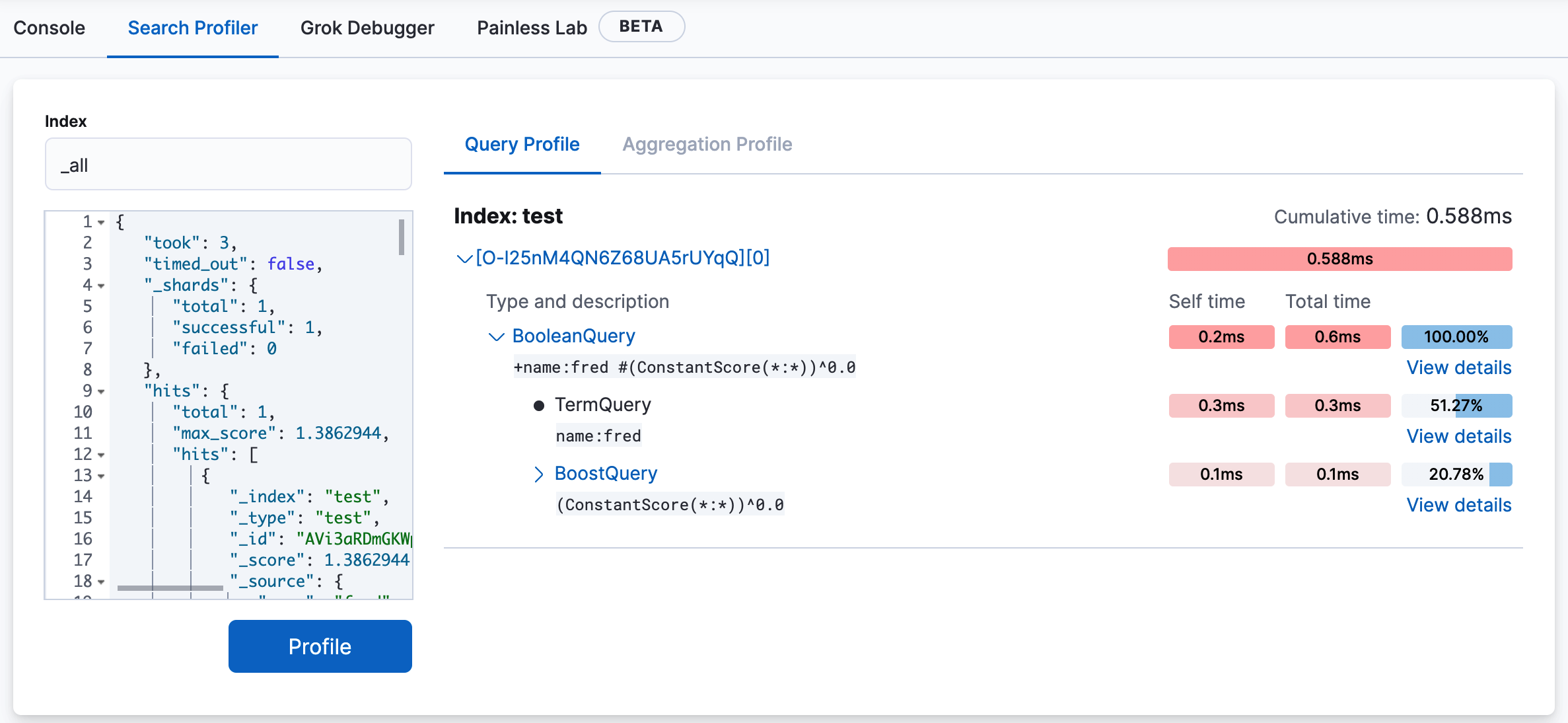

Render pre-captured profiler JSON
editThe Search Profiler queries the cluster that the Kibana node is attached to. It does this by executing the query against the cluster and collecting the results.
Sometimes you might want to investigate performance problems that are temporal in nature. For example, a query might only be slow at certain time of day when many customers are using your system. You can set up a process to automatically profile slow queries when they occur and then save those profile responses for later analysis.
The Search Profiler supports this workflow by allowing you to paste the pre-captured JSON in the query editor. The Search Profiler will detect that you have entered a JSON response (rather than a query) and will render just the visualization, rather than querying the cluster.
To see how this works, copy and paste the following profile response into the query editor and click Profile.
{ "took": 3, "timed_out": false, "_shards": { "total": 1, "successful": 1, "failed": 0 }, "hits": { "total": 1, "max_score": 1.3862944, "hits": [ { "_index": "test", "_type": "test", "_id": "AVi3aRDmGKWpaS38wV57", "_score": 1.3862944, "_source": { "name": "fred", "age": 69, "hair": "blonde" } } ] }, "profile": { "shards": [ { "id": "[O-l25nM4QN6Z68UA5rUYqQ][test][0]", "searches": [ { "query": [ { "type": "BooleanQuery", "description": "+name:fred #(ConstantScore(*:*))^0.0", "time": "0.5884370000ms", "breakdown": { "score": 7243, "build_scorer_count": 1, "match_count": 0, "create_weight": 196239, "next_doc": 9851, "match": 0, "create_weight_count": 1, "next_doc_count": 2, "score_count": 1, "build_scorer": 375099, "advance": 0, "advance_count": 0 }, "children": [ { "type": "TermQuery", "description": "name:fred", "time": "0.3016880000ms", "breakdown": { "score": 4218, "build_scorer_count": 1, "match_count": 0, "create_weight": 132425, "next_doc": 2196, "match": 0, "create_weight_count": 1, "next_doc_count": 2, "score_count": 1, "build_scorer": 162844, "advance": 0, "advance_count": 0 } }, { "type": "BoostQuery", "description": "(ConstantScore(*:*))^0.0", "time": "0.1223030000ms", "breakdown": { "score": 0, "build_scorer_count": 1, "match_count": 0, "create_weight": 17366, "next_doc": 0, "match": 0, "create_weight_count": 1, "next_doc_count": 0, "score_count": 0, "build_scorer": 102329, "advance": 2604, "advance_count": 2 }, "children": [ { "type": "MatchAllDocsQuery", "description": "*:*", "time": "0.03307600000ms", "breakdown": { "score": 0, "build_scorer_count": 1, "match_count": 0, "create_weight": 6068, "next_doc": 0, "match": 0, "create_weight_count": 1, "next_doc_count": 0, "score_count": 0, "build_scorer": 25615, "advance": 1389, "advance_count": 2 } } ] } ] } ], "rewrite_time": 168640, "collector": [ { "name": "CancellableCollector", "reason": "search_cancelled", "time": "0.02952900000ms", "children": [ { "name": "SimpleTopScoreDocCollector", "reason": "search_top_hits", "time": "0.01931700000ms" } ] } ] } ], "aggregations": [] } ] } }
Your output should look similar to this:
