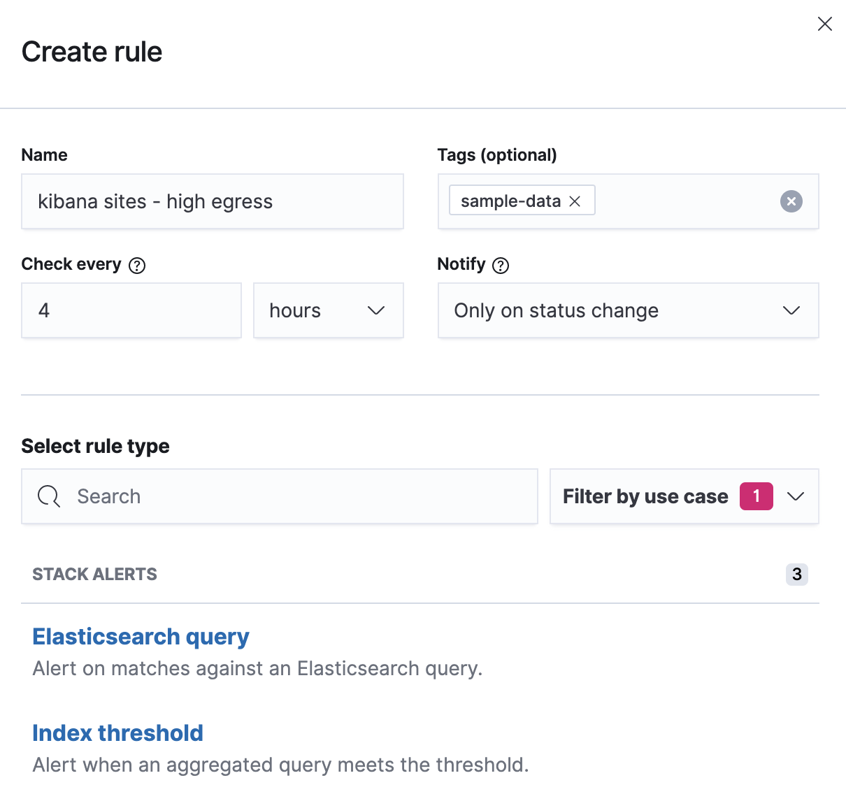

Create the rule
editFill in the rule details, then select Index Threshold.

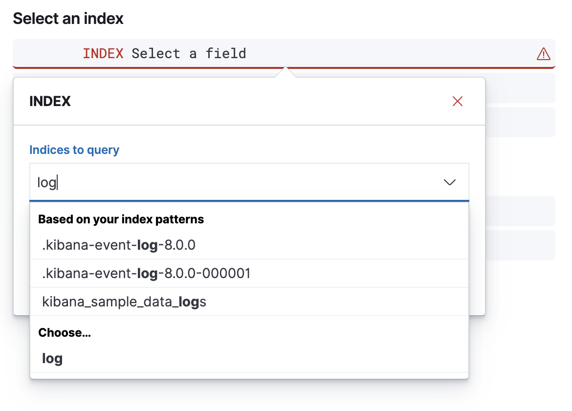

- Index
- This clause requires an index or data view and a time field that will be used for the time window.

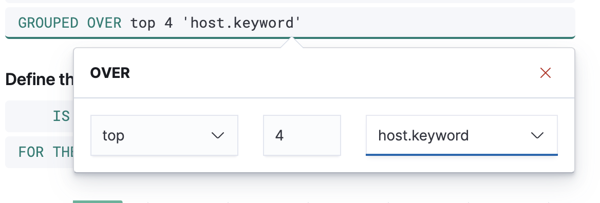

the document count is used, and an aggregation field is not necessary. - Over/Grouped Over
- This clause lets you configure whether the aggregation is applied over all documents, or should be split into groups using a grouping field. If grouping is used, an alert will be created for each group when it exceeds the threshold. To limit the number of alerts on high cardinality fields, you must specify the number of groups to check against the threshold. Only the top groups are checked.

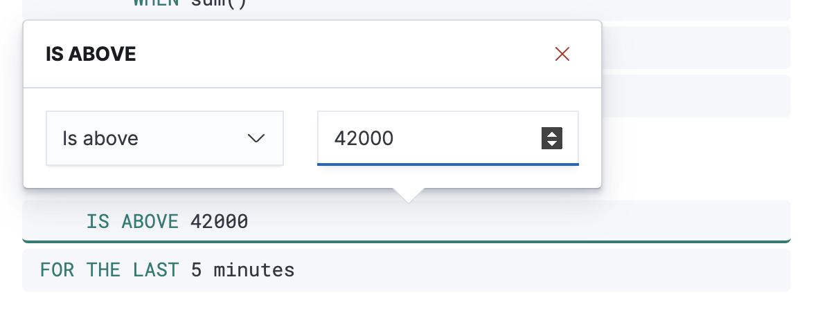

- Threshold
This clause defines a threshold value and a comparison operator (one of

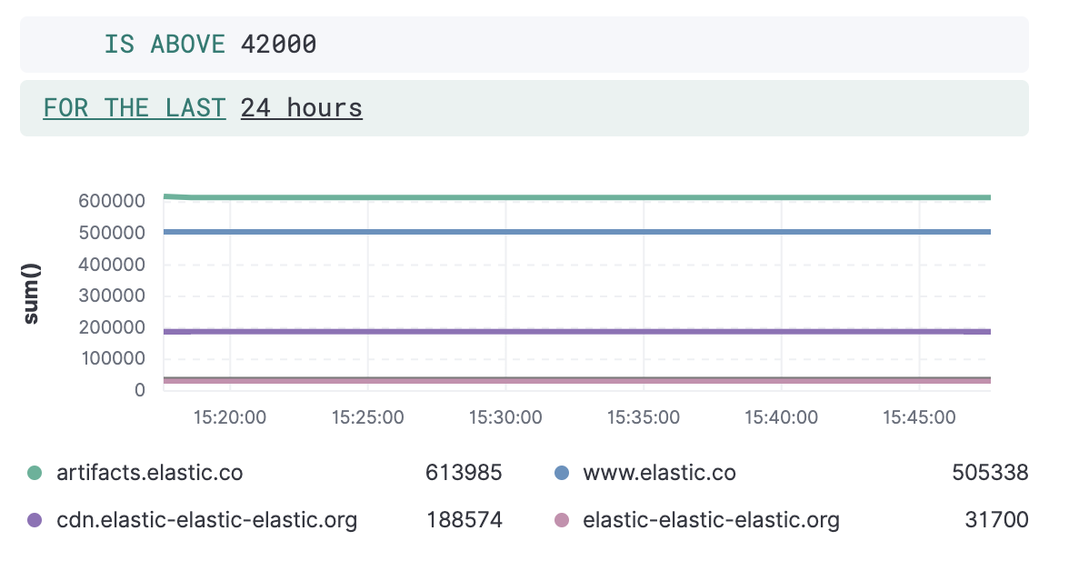

If data is available and all clauses have been defined, a preview chart will render the threshold value and display a line chart showing the value for the last 30 intervals. This can provide an indication of recent values and their proximity to the threshold, and help you tune the clauses.

- Open the main menu, then click Stack Management > Rules and Connectors.
Create a new rule that is checked every four hours and triggers actions when the rule status changes.
- Select the Index threshold rule type.

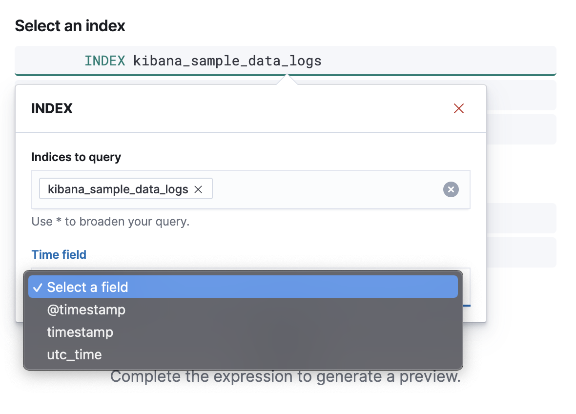

Click Index, and set Indices to query to kibana_sample_data_logs.
Set the Time field to @timestamp.

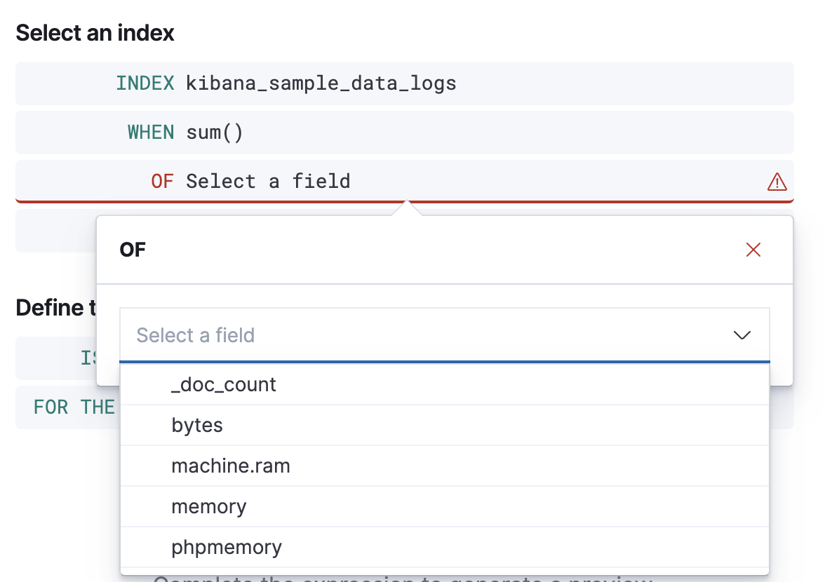

To detect the number of bytes served during the time window, click When and select
sum
as the aggregation, and bytes as the field to aggregate. -
To detect the four sites that have the most traffic, click Over and select
top
, enter4
, and selecthost.keyword
as the field. -
To trigger the rule when any of the top four sites exceeds 420,000 bytes over a 24 hour period, select
is above
and enter420000

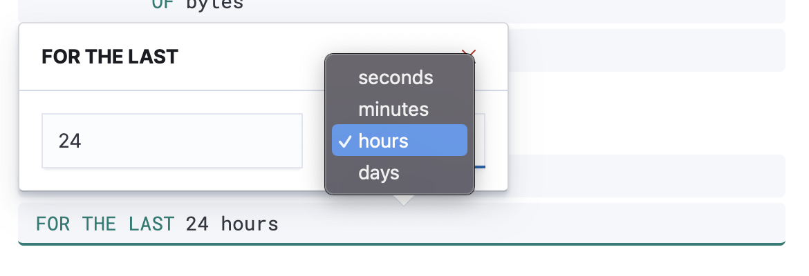

Finally, click For the last, enter
24
and selecthours
to complete the rule configuration. -

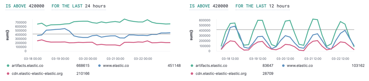

The preview chart will render showing the 24 hour sum of bytes at 4 hours intervals (the check every interval) for the past 120 hours (the last 30 intervals).
Change the time window and observe the effect it has on the chart. Compare a 24 window to a 12 hour window. Notice the variability in the sum of bytes, due to different traffic levels during the day compared to at night. This variability would result in noisy rules, so the 24 hour window is better. The preview chart can help you find the right values for your rule.
