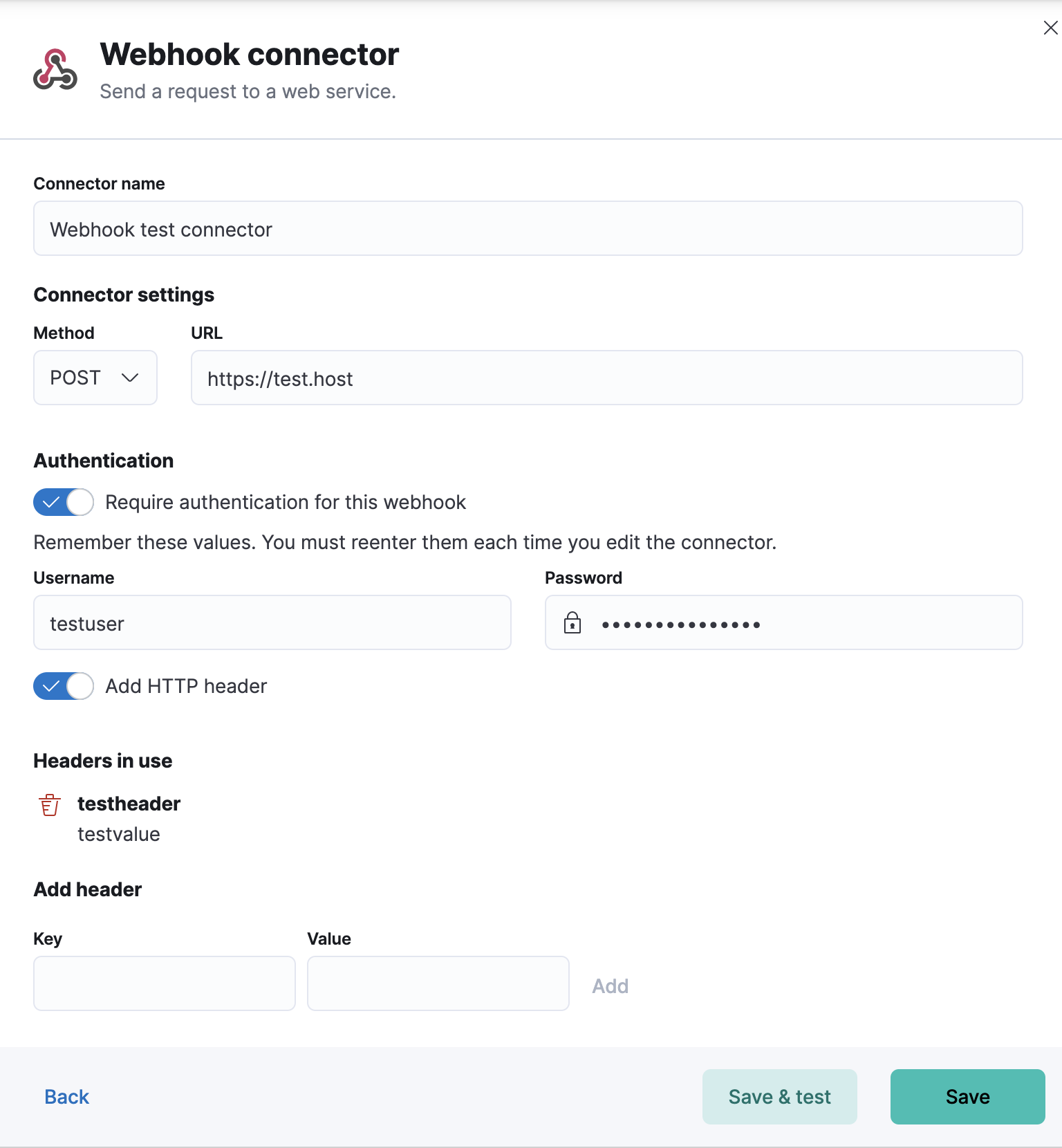

Connector configuration
Webhook connectors have the following configuration properties.
Name
The name of the connector. The name is used to identify a connector in the management UI connector listing, or in the connector list when configuring an action.
URL
The request URL. If you are using the xpack.actions.allowedHosts setting, make sure the hostname is added to the allowed hosts.
Method
HTTP request method, either post(default) or put.
Headers
A set of key-value pairs sent as headers with the request
Require authentication
If true, a username and password for login type authentication must be provided.
Username
Username for HTTP basic authentication.
Password
Password for HTTP basic authentication.

Define Webhook connector properties.
Webhook connector

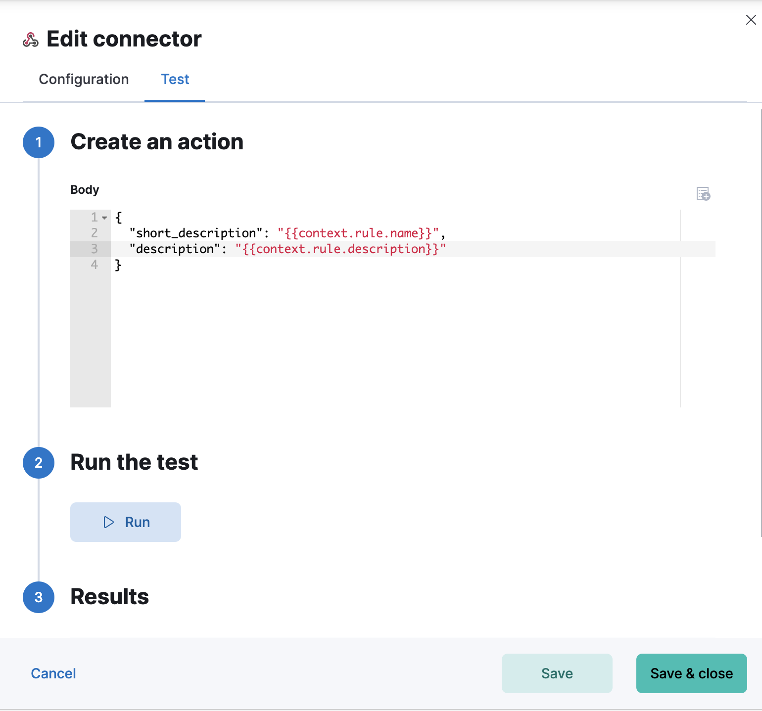

Test Webhook action parameters.
Webhook params test

Body
A JSON payload sent to the request URL. For example:
  "short_description": "{{context.rule.name}}",
  "description": "{{context.rule.description}}",
Mustache template variables (the text enclosed in double braces, for example, context.rule.name) have their values escaped, so that the final JSON will be valid (escaping double quote characters). For more information on Mustache template variables, refer to Action type and details.
