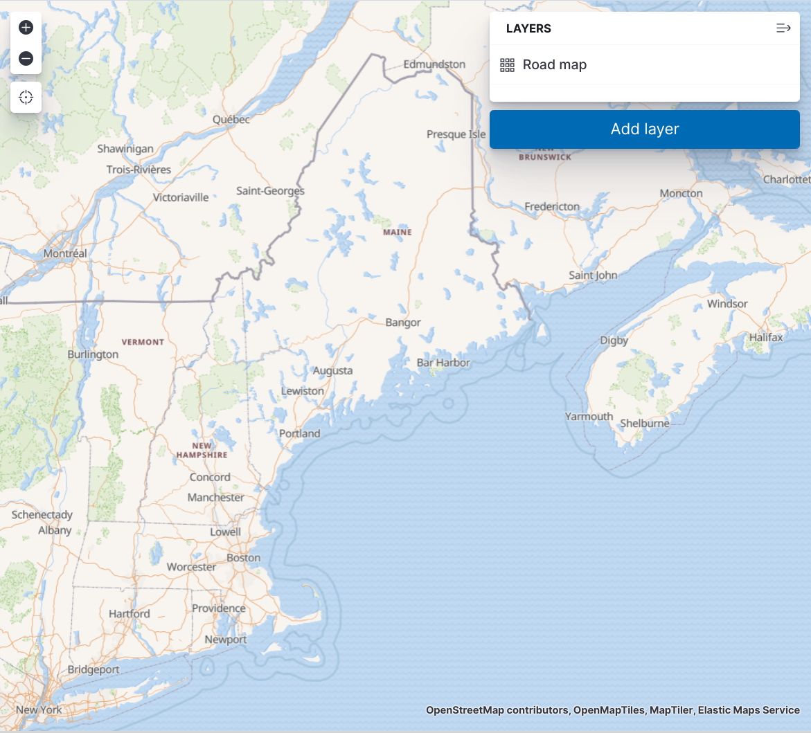

  1. Create a new map.
  2. Zoom in on the New England area in the northeast United States.
    You’re adding flight paths to this area, and this sets up the map for a good view of the data.
    fu gs new england map

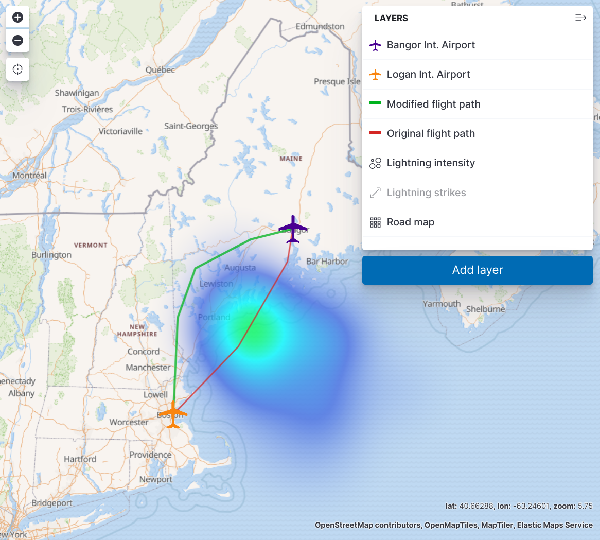

Add a heatmap aggregation layer
Looking at the Lightning detected layer, it’s clear where lightning has struck. What’s less clear, is if there have been more lightning strikes in some areas than others, in other words, where the lightning hot spots are. An advantage of having indexed geo_point data for the lightning strikes is that you can perform aggregations on the data.
  1. Click Add layer.
  2. From the list of layer types, click Heat map.
    Because you indexed lightning_detected.geojson using the index name and pattern lightning_detected, that data is available as a geo_point aggregation.
  3. Select lightning_detected.
  4. Click Add layer to add the heat map layer "Lightning intensity".
    The remaining default settings are good, but there are a couple of settings that you might want to change.
  5. Play around with the Layer Style > Color range setting.
    Again the default looks good, but feel free to choose a different color range.
  6. When you’re finished modifying settings, click Save & close.
    With your new lightning heat map layer, your map should look like this:
    fu gs lightning intensity
Organize the layers
Consider ways you might improve the appearance of the final map. Small changes in how and when layers are shown can help tell a better story with your data. Here are a few final tweaks you might make:
  • Update layer names
  • Adjust styles for each layer
  • Adjust the layer order
  • Decide which layers to show at different zoom levels
When you’ve finished, again be sure to save your work .
Your final map might look like this:
fu gs final map
