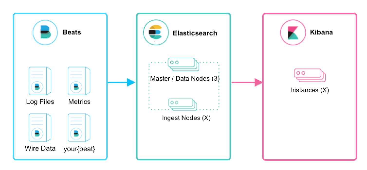

Getting Started
For first time users, if you simply want to tail a log file to grasp the power of the Elastic Stack, we recommend trying Filebeat Modules. Filebeat Modules enable you to quickly collect, parse, and index popular log types and view pre-built Kibana dashboards within minutes. Metricbeat Modules provide a similar experience, but with metrics data. In this context, Beats will ship data directly to Elasticsearch where Ingest Nodes will process and index your data.
deploy1

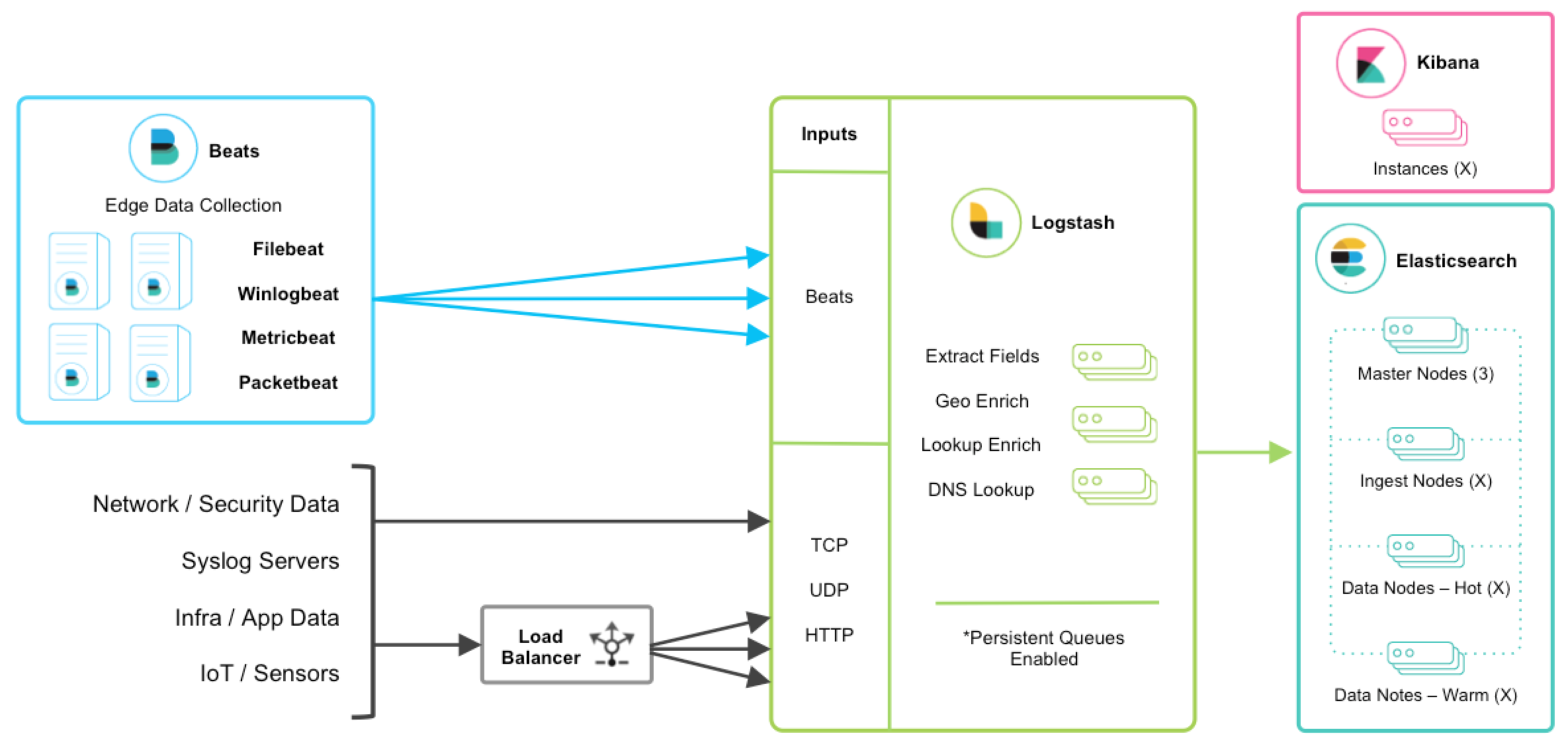

Beats and Logstash
Beats run across thousands of edge host servers, collecting, tailing, and shipping logs to Logstash. Logstash serves as the centralized streaming engine for data unification and enrichment. The Beats input plugin exposes a secure, acknowledgement-based endpoint for Beats to send data to Logstash.
deploy2

Scalability
Logstash is horizontally scalable and can form groups of nodes running the same pipeline. Logstash’s adaptive buffering capabilities will facilitate smooth streaming even through variable throughput loads. If the Logstash layer becomes an ingestion bottleneck, simply add more nodes to scale out. Here are a few general recommendations:
  • Beats should load balance across a group of Logstash nodes.
  • A minimum of two Logstash nodes are recommended for high availability.
  • It’s common to deploy just one Beats input per Logstash node, but multiple Beats inputs can also be deployed per Logstash node to expose independent endpoints for different data sources.
Resiliency
When using Filebeat or Winlogbeat for log collection within this ingest flow, at-least-once delivery is guaranteed. Both the communication protocols, from Filebeat or Winlogbeat to Logstash, and from Logstash to Elasticsearch, are synchronous and support acknowledgements. The other Beats don’t yet have support for acknowledgements.
Logstash persistent queues provide protection across node failures. For disk-level resiliency in Logstash, it’s important to ensure disk redundancy. For on-premise deployments, it’s recommended that you configure RAID. When running in the cloud or a containerized environment, it’s recommended that you use persistent disks with replication strategies that reflect your data SLAs.
Make sure queue.checkpoint.writes: 1 is set for at-least-once guarantees. For more details, see the persistent queue durability documentation.

TCP, UDP, and HTTP Protocols
The TCP, UDP, and HTTP protocols are common ways to feed data into Logstash. Logstash can expose endpoint listeners with the respective TCP, UDP, and HTTP input plugins. The data sources enumerated below are typically ingested through one of these three protocols.
The TCP and UDP protocols do not support application-level acknowledgements, so connectivity issues may result in data loss.
For high availability scenarios, a third-party hardware or software load balancer, like HAProxy, should be added to fan out traffic to a group of Logstash nodes.

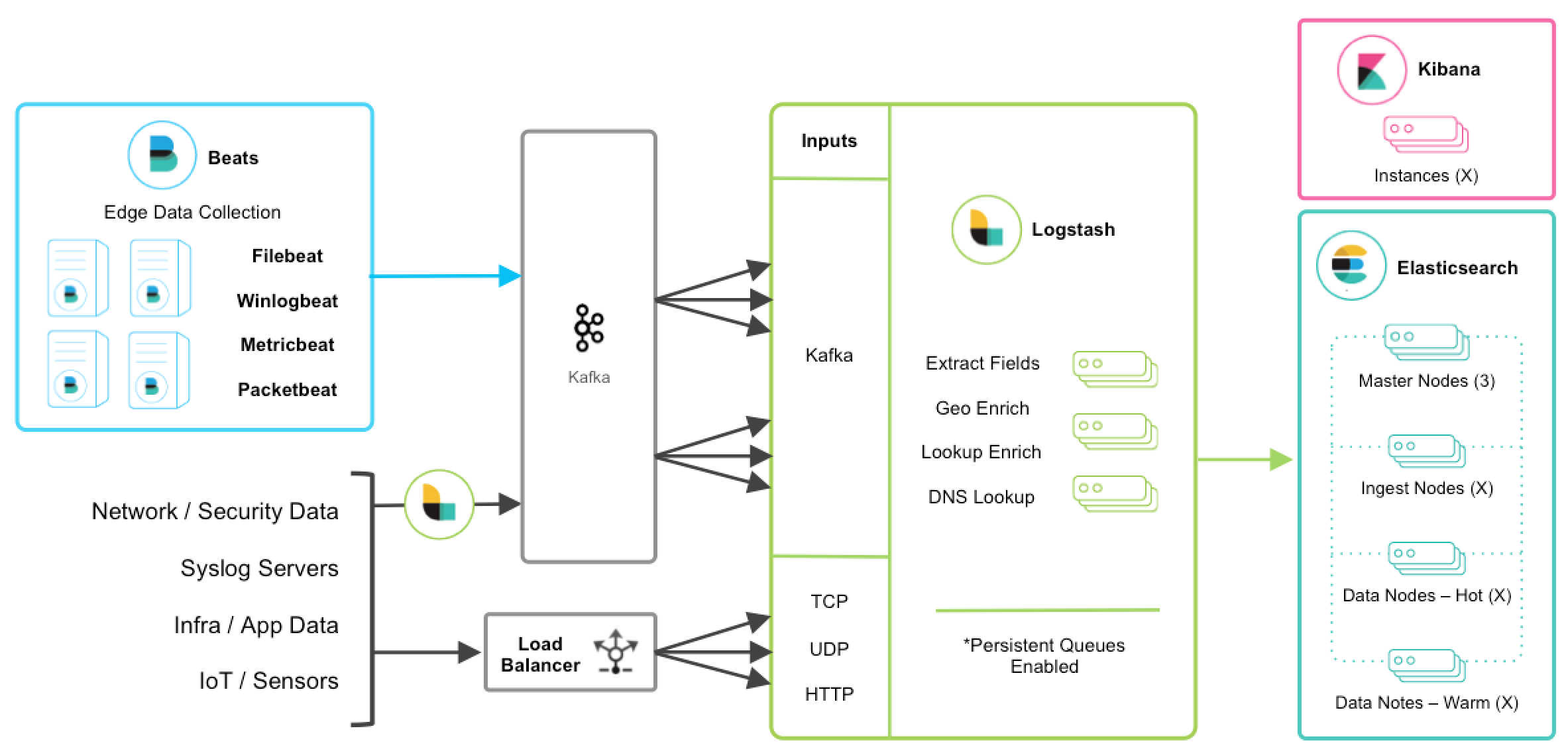

Integrating with Messaging Queues
If you are leveraging message queuing technologies as part of your existing infrastructure, getting that data into the Elastic Stack is easy. For existing users who are utilizing an external queuing layer like Redis or RabbitMQ just for data buffering with Logstash, it’s recommended to use Logstash persistent queues instead of an external queuing layer. This will help with overall ease of management by removing an unnecessary layer of complexity in your ingest architecture.
For users who want to integrate data from existing Kafka deployments or require the underlying usage of ephemeral storage, Kafka can serve as a data hub where Beats can persist to and Logstash nodes can consume from.
deploy4
The other TCP, UDP, and HTTP sources can persist to Kafka with Logstash as a conduit to achieve high availability in lieu of a load balancer. A group of Logstash nodes can then consume from topics with the Kafka input to further transform and enrich the data in transit.
Resiliency and Recovery
When Logstash consumes from Kafka, persistent queues should be enabled and will add transport resiliency to mitigate the need for reprocessing during Logstash node failures. In this context, it’s recommended to use the default persistent queue disk allocation size queue.max_bytes: 1GB.
If Kafka is configured to retain data for an extended period of time, data can be reprocessed from Kafka in the case of disaster recovery and reconciliation.
