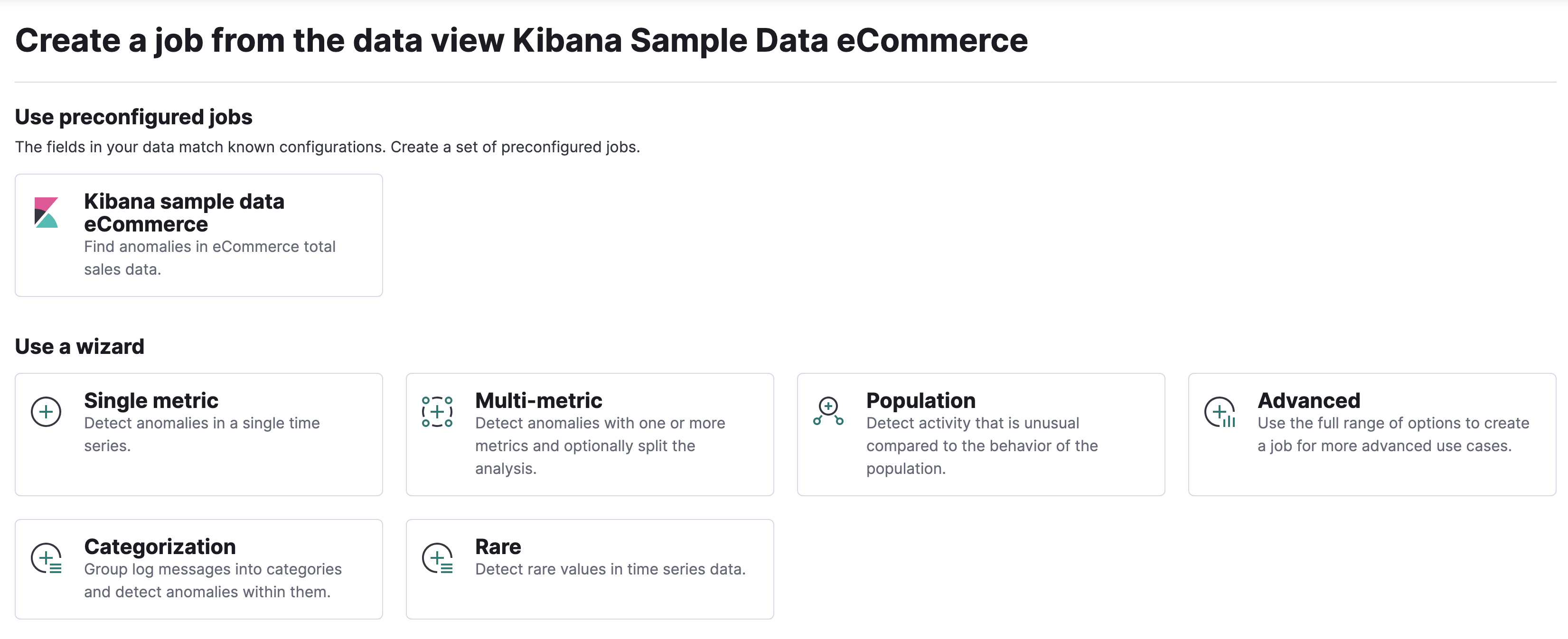

Create New Job
  • The single metric wizard creates simple jobs that have a single detector. A detector applies an analytical function to specific fields in your data. In addition to limiting the number of detectors, the single metric wizard omits many of the more advanced configuration options.
  • The multi-metric wizard creates jobs that can have more than one detector, which is more efficient than running multiple jobs against the same data.
  • The population wizard creates jobs that detect activity that is unusual compared to the behavior of the population.
  • The categorization wizard creates jobs that group log messages into categories and use count or rare functions to detect anomalies within them.
  • The advanced wizard creates jobs that can have multiple detectors and enables you to configure all job settings.
Kibana can also recognize certain types of data and provide specialized wizards for that context. For example, there are anomaly detection jobs for the sample eCommerce orders and sample web logs data sets, as well as for data generated by the Elastic Security and Observability solutions, Beats, and Elastic Agent Integrations. For a list of all the preconfigured jobs, see Supplied configurations.

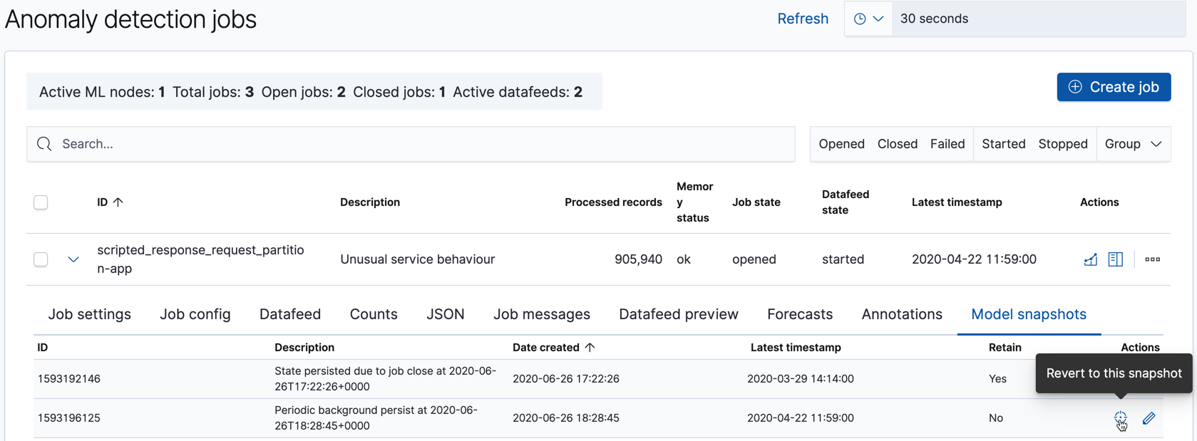

Model snapshots
Elastic Stack machine learning features calculate baselines of normal behavior then extrapolate anomalous events. These baselines are accomplished by generating models of your data.
To ensure resilience in the event of a system failure, snapshots of the machine learning model for each anomaly detection job are saved to an internal index within the Elasticsearch cluster. The amount of time necessary to save these snapshots is proportional to the size of the model in memory. By default, snapshots are captured approximately every 3 to 4 hours. You can change this interval (background_persist_interval) when you create or update a job.
To reduce the number of snapshots consuming space on your cluster, at the end of each day, old snapshots are automatically deleted. The age of each snapshot is calculated relative to the timestamp of the most recent snapshot. By default, if there are snapshots over one day older than the newest snapshot, they are deleted except for the first snapshot each day. As well, all snapshots over ten days older than the newest snapshot are deleted. You can change these retention settings (daily_model_snapshot_retention_after_days and model_snapshot_retention_days) when you create or update a job. If you want to exempt a specific snapshot from this clean up, use Kibana or the update model snapshots API to set retain to true.
You can see the list of model snapshots for each job with the get model snapshots API or in the Model snapshots tab on the Job Management page in Kibana:
Example screenshot with a list of model snapshots
There are situations other than system failures where you might want to revert to using a specific model snapshot. The machine learning features react quickly to anomalous input and new behaviors in data. Highly anomalous input increases the variance in the models and machine learning analytics must determine whether it is a new step-change in behavior or a one-off event. In the case where you know this anomalous input is a one-off, it might be appropriate to reset the model state to a time before this event. For example, after a Black Friday sales day you might consider reverting to a saved snapshot. If you know about such events in advance, however, you can use calendars and scheduled events to avoid impacting your model.
