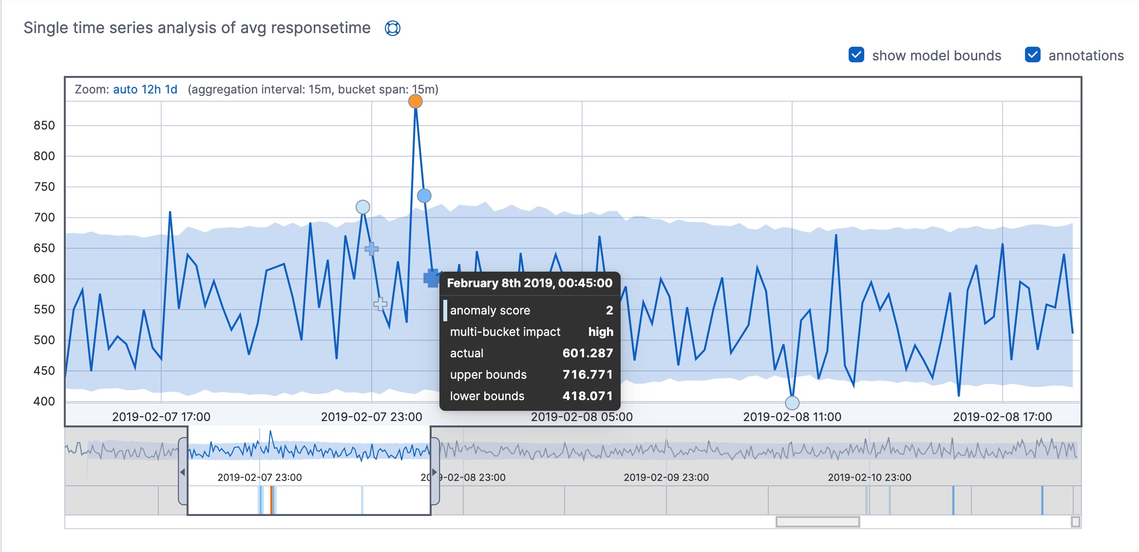

The machine learning analytics enhance the anomaly score for each bucket by considering contiguous buckets. This extra multi-bucket analysis effectively uses a sliding window to evaluate the events in each bucket relative to the larger context of recent events. When you review your machine learning results, there is a multi_bucket_impact property that indicates how strongly the final anomaly score is influenced by multi-bucket analysis. In Kibana, anomalies with medium or high multi-bucket impact are depicted in the Anomaly Explorer and the Single Metric Viewer with a cross symbol instead of a dot. For example:
Examples of anomalies with multi-bucket impact in Kibana
In this example, you can see that some of the anomalies fall within the shaded blue area, which represents the bounds for the expected values. The bounds are calculated per bucket, but multi-bucket analysis is not limited by that scope.
Both the Anomaly Explorer and the Single Metric Viewer contain an Anomalies table that shows key details about each anomaly such as time, typical and actual values, and probability. The Anomaly explanation section helps you to interpret a given anomaly by providing further insights about its type, impact, and score.

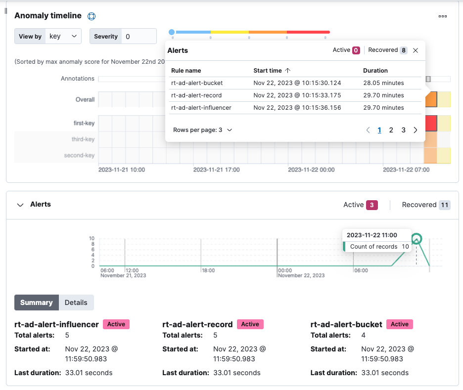

If you have Anomaly detection alert rules applied to an anomaly detection job and an alert has occured for the rule, you can view how the alert correlates with the anomaly detection results in the Anomaly Explorer by using the Anomaly timeline swimlane and the Alerts panel. The Alerts panel contains a line chart with the alerts count over time. The cursor on the line chart is in sync with the anomaly swimlane making it easier to review anomalous buckets with the spike produced by the alerts. The panel also contains aggregated information for each alert rule associated with the job selection such as the total number of active, recovered, and untracked alerts for the selected job and time range. An alert context menu is displayed when an anomaly swimlane cell is selected with alerts in the chosen time range. The context menu contains the alert counters for the selected time buckets.
Alerts table in the Anomaly Explorer

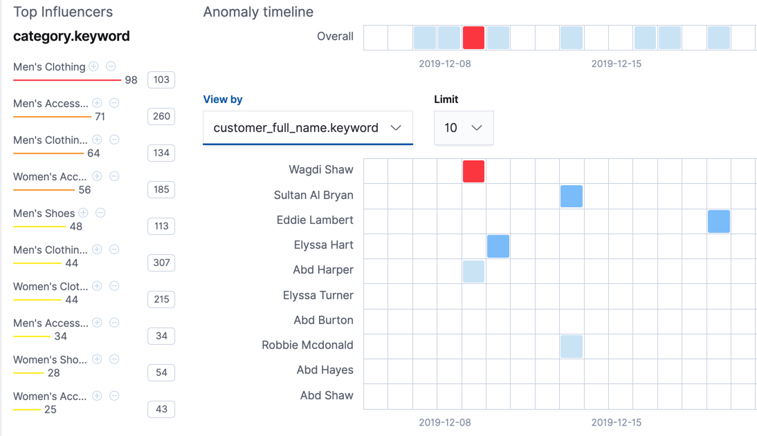

For example, the high_sum_total_sales anomaly detection job for the eCommerce orders sample data uses customer_full_name.keyword and category.keyword as influencers. You can examine the influencer results with the get influencers API. Alternatively, you can use the Anomaly Explorer in Kibana:
Influencers in the Kibana Anomaly Explorer
On the left is a list of the top influencers for all of the detected anomalies in that same time period. The list includes maximum anomaly scores, which in this case are aggregated for each influencer, for each bucket, across all detectors. There is also a total sum of the anomaly scores for each influencer. You can use this list to help you narrow down the contributing factors and focus on the most anomalous entities.
You can also explore swim lanes that correspond to the values of an influencer. In this example, the swim lanes correspond to the values for the customer_full_name.keyword. By default, the swim lanes are sorted according to which entity has the maximum anomaly score values. You can click on the sections in the swim lane to see details about the anomalies that occurred in that time interval.
The anomaly scores that you see in each section of the Anomaly Explorer might differ slightly. This disparity occurs because for each anomaly detection job, there are bucket results, influencer results, and record results. Anomaly scores are generated for each type of result. The anomaly timeline in Kibana uses the bucket-level anomaly scores. If you view swim lanes by influencer, it uses the influencer-level anomaly scores, as does the list of top influencers. The list of anomalies uses the record-level anomaly scores.
