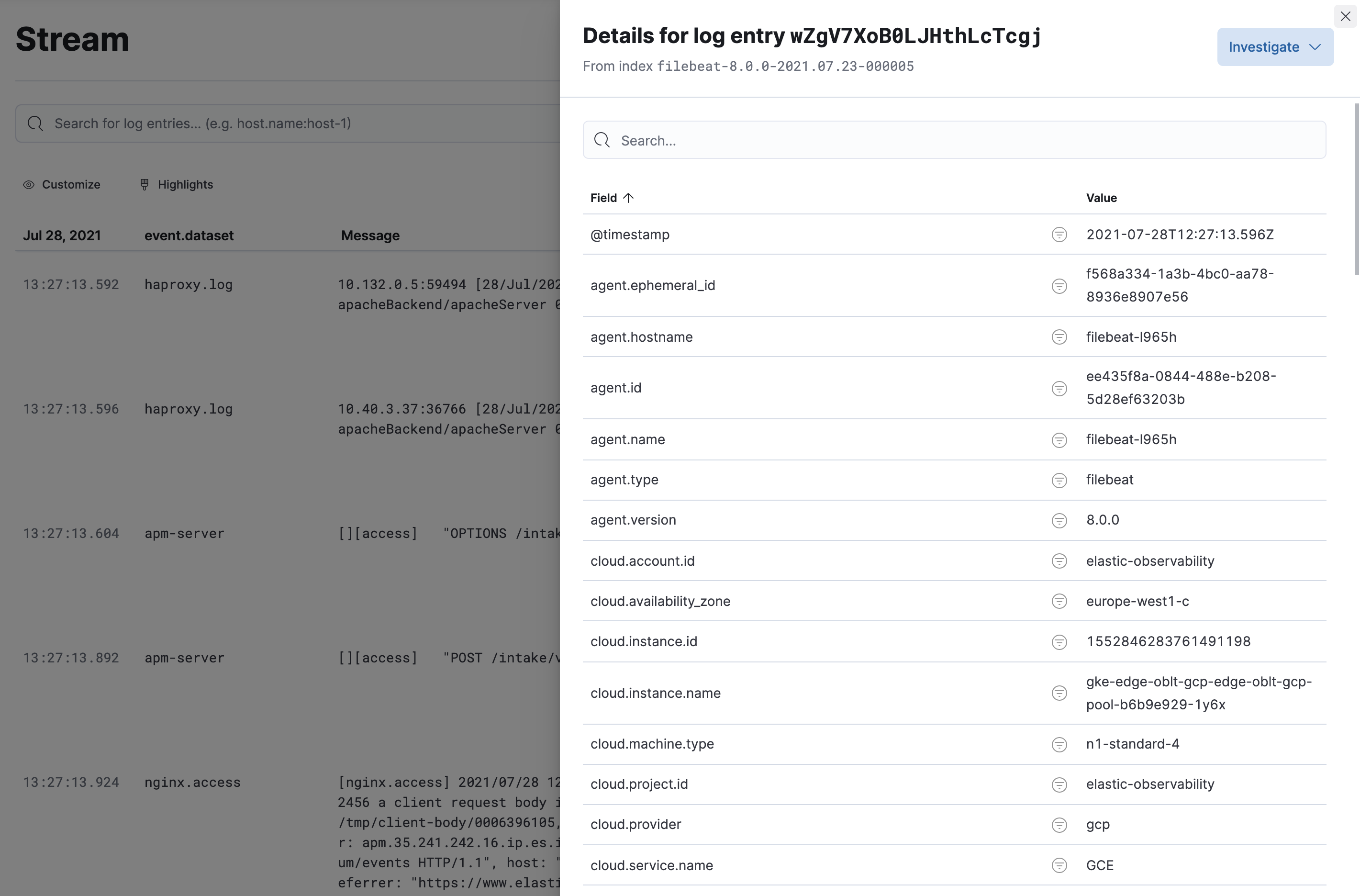

Inspect log event details
When you have searched and filtered your logs for a specific log event, you may want to examine the metadata and the structured fields associated with that event. To view the Log event document details fly-out, hover over the log event, click View actions for line, and then select View details. To further enhance the workflow of monitoring logs, the icons next to each field value enable you to filter the logs per that value.
Log event details

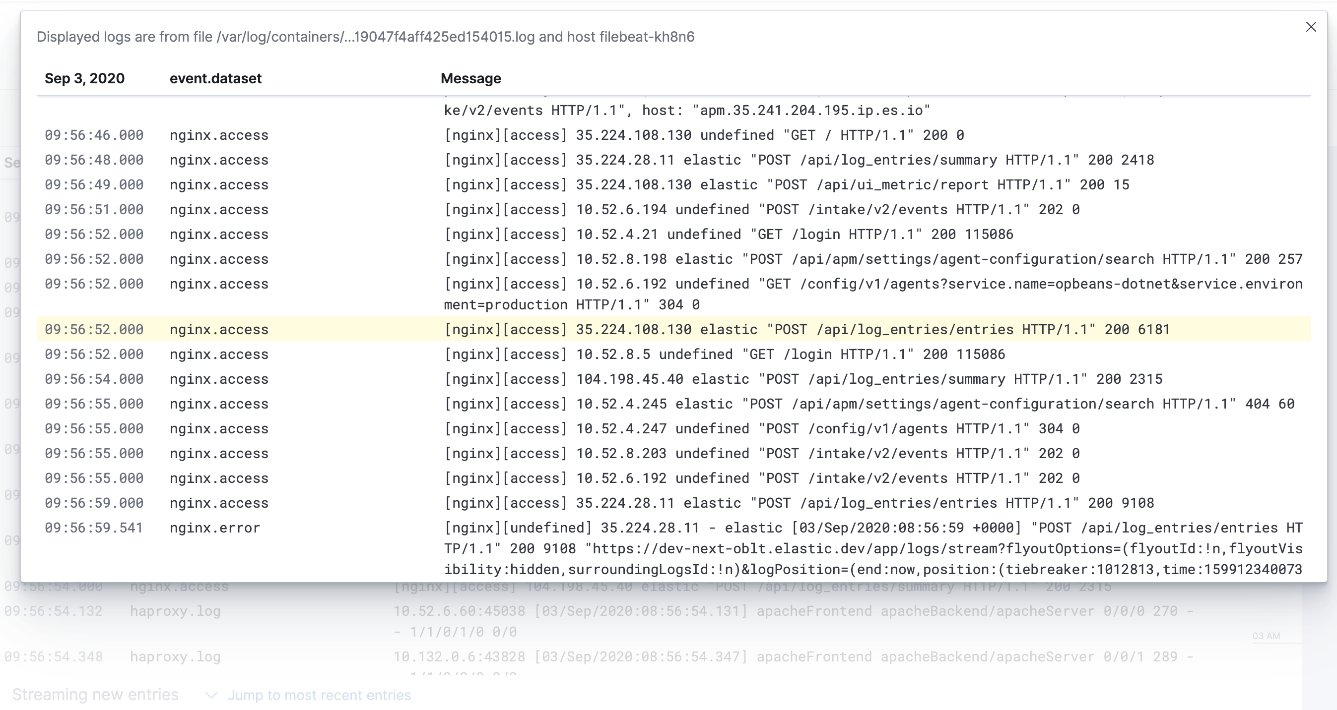

View contextual logs
Once your logs are filtered, and you find an interesting log line, the real context you are looking for is what happened before and after that log line within that data source. For example, you are running containerized applications on a Kubernetes cluster, you filter the logs for the term error, and you find an interesting error log line. The context you want is what happened before and after the error line within the logs of this container and application.
Hover over the log event, click View actions for line, and then select View in context. The context is preserved and helps you find the root cause as soon as possible.
Contextual log event
