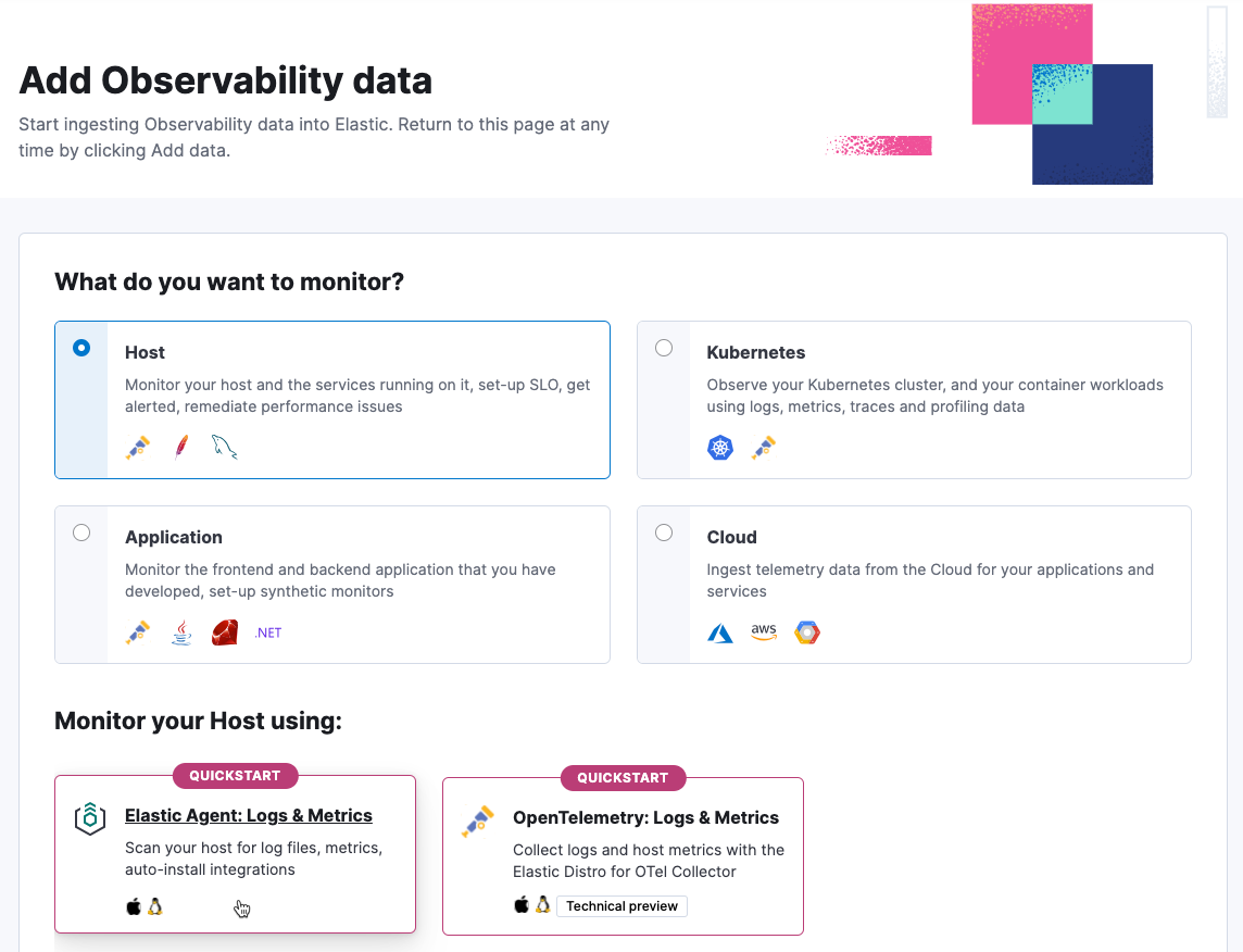

edit- In Kibana, go to the Observability UI and click Add Data.
Under What do you want to monitor? select Host, and then select Elastic Agent: Logs & Metrics.
Copy the install command.
You’ll run this command to download the auto-detection script, scan your system for observability data, and install Elastic Agent.

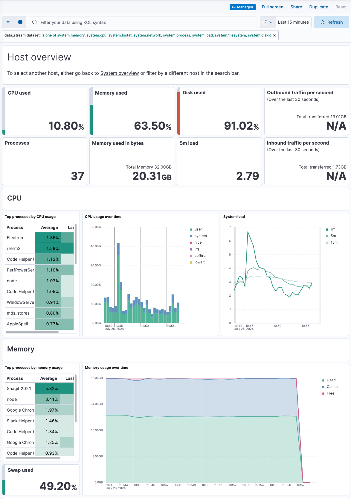

For example, you can navigate the Host overview dashboard to explore detailed metrics about system usage and throughput. Metrics that indicate a possible problem are highlighted in red.
