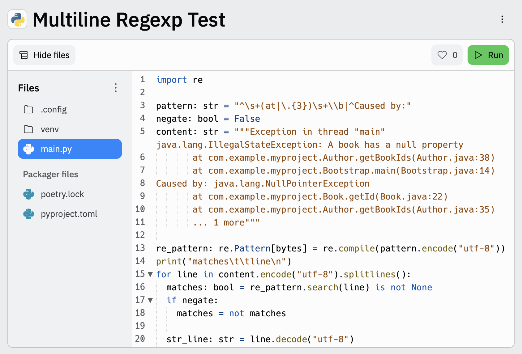

editTo make it easier for you to test the regexp patterns in your multiline config, you can use this Multiline Regexp Test:
Plug in the regexp pattern at line
3
, along with themultiline.negate
setting that you plan to use at line4

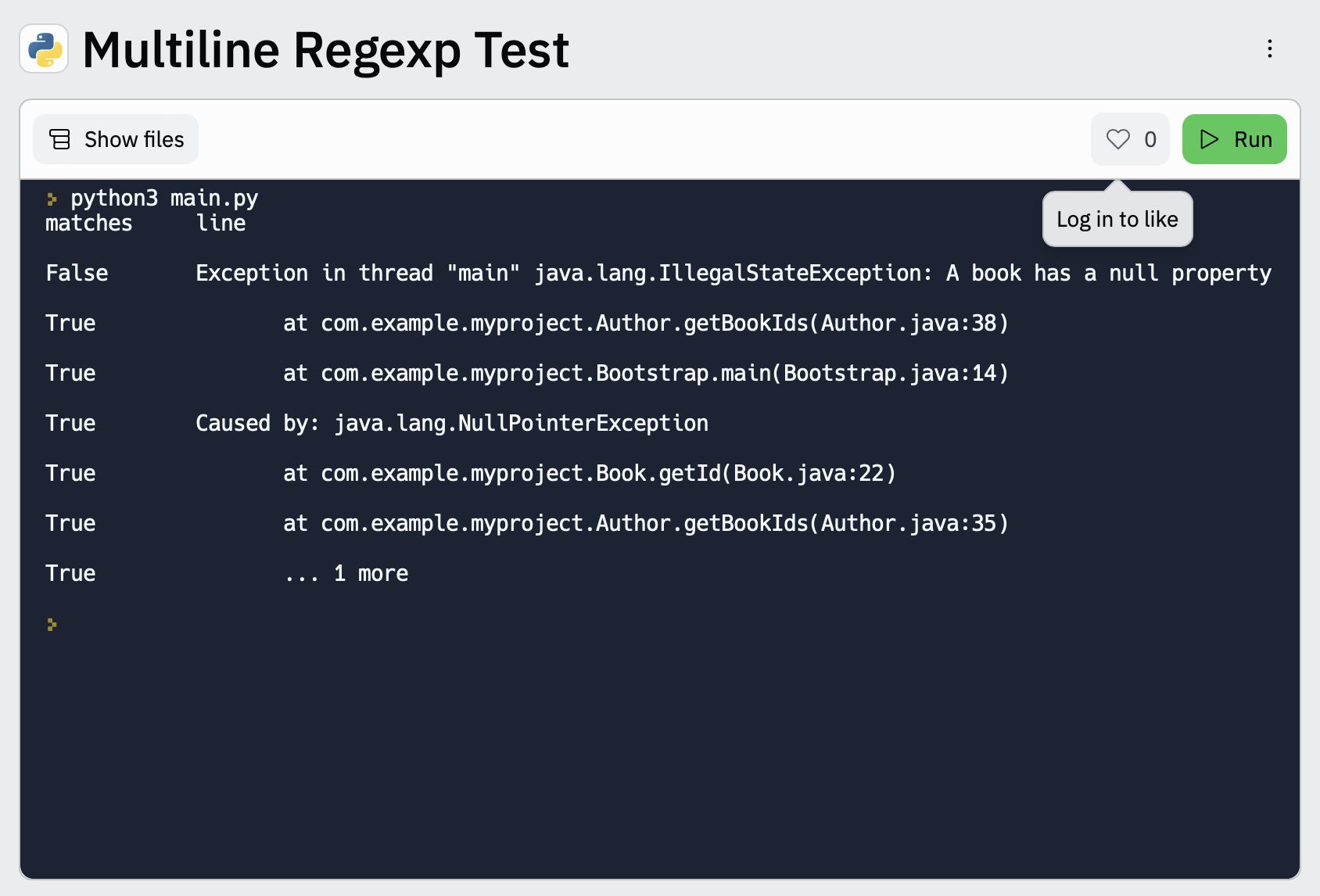

Paste a sample message between the three double quote delimiters (
) at line5
Click
Run
to see which lines in the message match your specified configuration.
