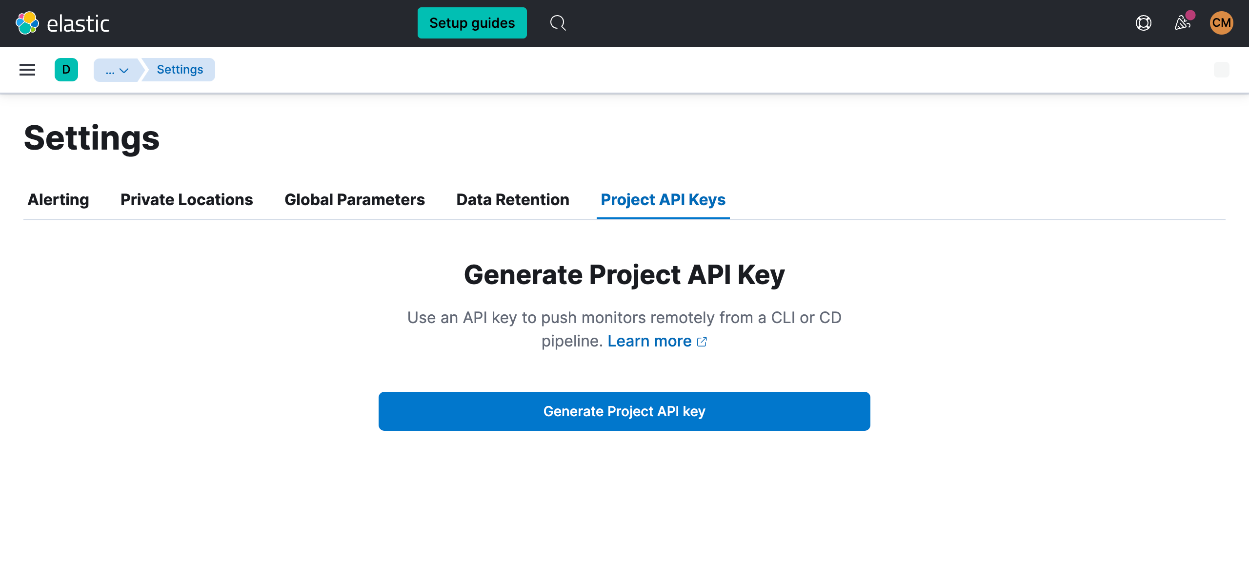

  1. To generate an API key:
    1. Go to Synthetics in Kibana.
    2. Click Settings.
    3. Switch to the Project API Keys tab.
    4. Click Generate Project API key.
      To generate a Project API key, you must be logged in as a user with the privileges described in Writer role.
      Project API Keys tab in Synthetics settings
  2. Set the SYNTHETICS_API_KEY environment variable in your terminal. You will most likely want to set this permanently. This is done differently in Powershell and Bash.
