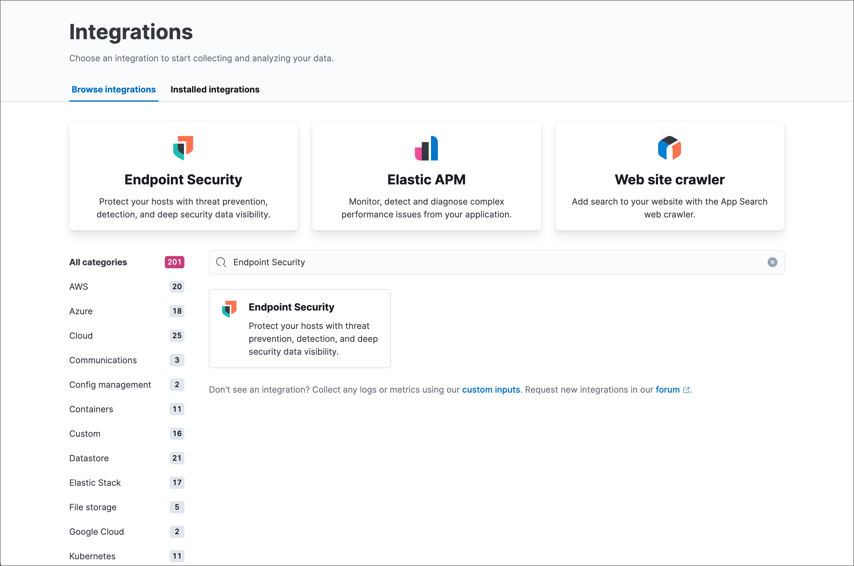

  1. In Kibana, select SecurityEndpoints. If this is not your first time using Elastic Security, select ManagementIntegrations, then search for and select Endpoint Security.

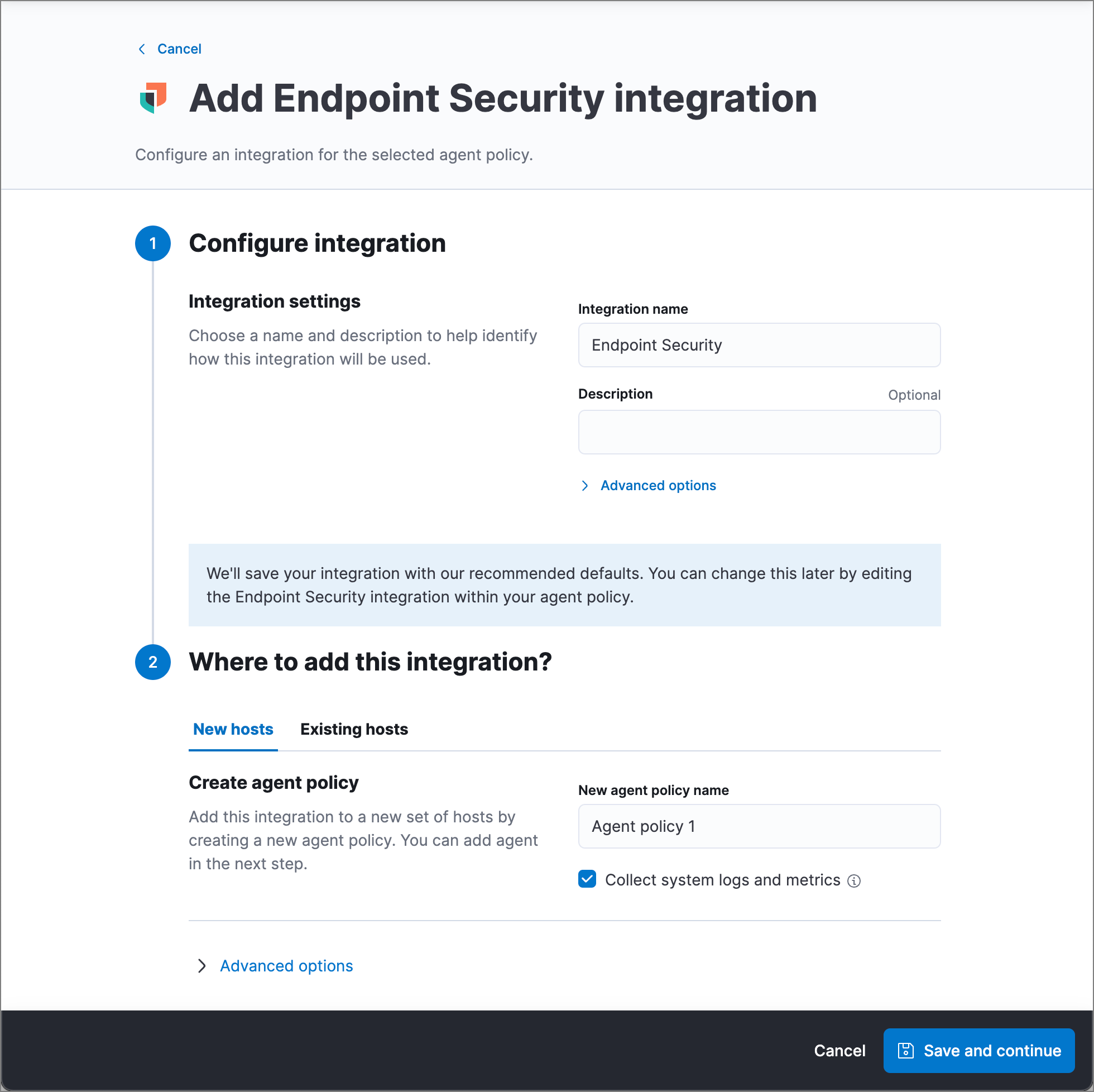

  2. Select Add Endpoint Security on either the Endpoints page of the Elastic Security app or the Endpoint Security integration page (ManagementIntegrations). The integration configuration page appears.
    Add Endpoint Security integration page.
  3. Configure the Endpoint Security integration with an Integration name and optional Description.
  4. Enter a name for the agent policy in New agent policy name. If other agent policies already exist, you can click the Existing hosts tab and select an existing policy instead. For more details on Elastic Agent configuration settings, refer to Elastic Agent policies.
  5. When the configuration is complete, click Save and continue.

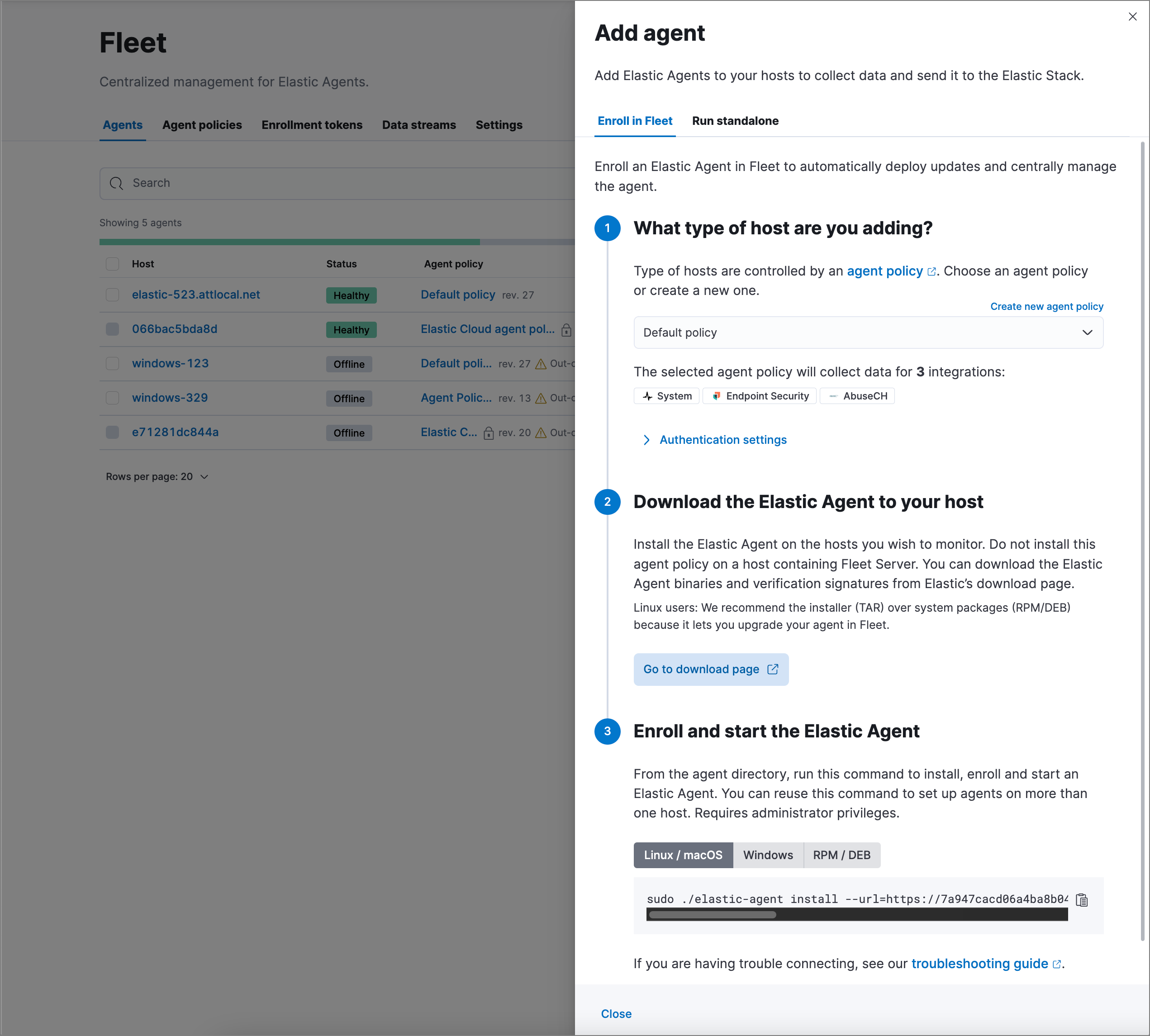

  1. Go to FleetAgentsAdd agent.
    Add agent flyout on the Fleet page.

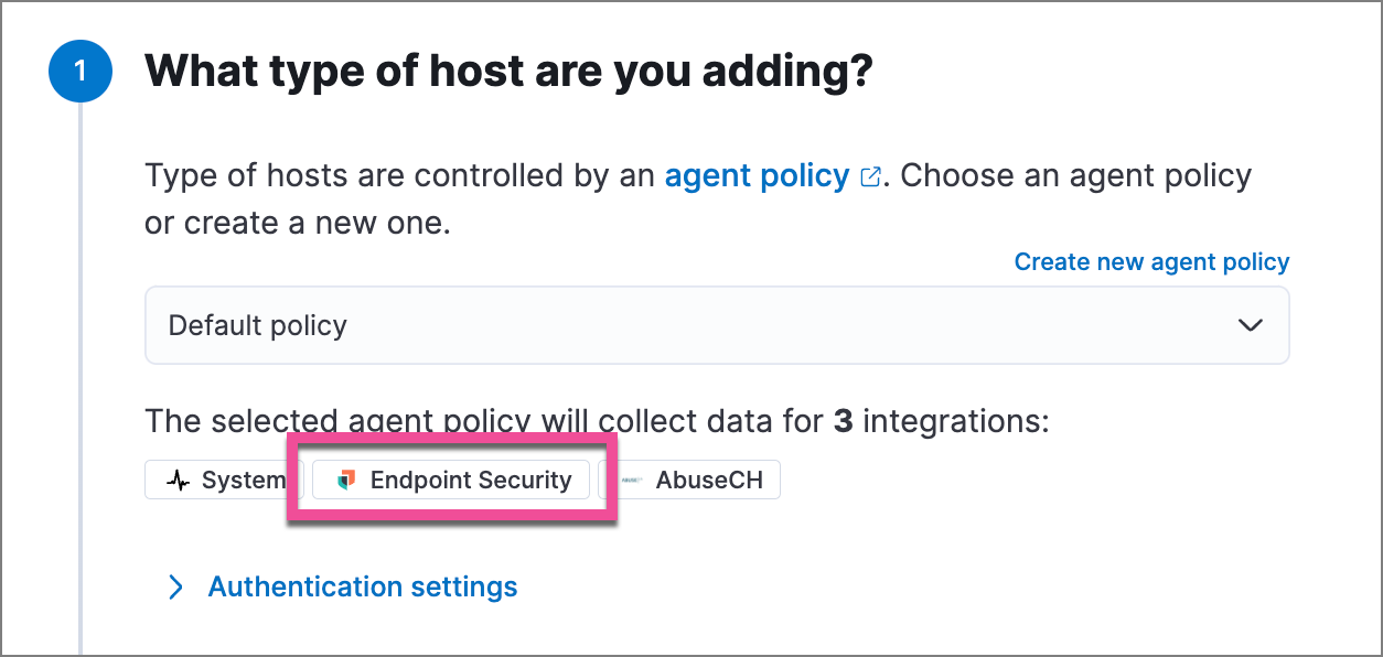

  2. Select an agent policy for the Elastic Agent. You can select an existing custom policy, or select Create new agent policy to create a new one. For more details on Elastic Agent configuration settings, refer to Elastic Agent policies.
    The selected policy should include Endpoint Security.
    Add agent flyout with Endpoint Security integration highlighted.
  3. Download and extract the Elastic Agent package on your host’s machine.
  4. Open a command-line interface and navigate to the directory where the Elastic Agent is located. Copy and run the command from Fleet for your OS to enroll and run the agent.
  5. After you have enrolled the Elastic Agent on your host, select Close. The host now appears on the Endpoints page in the Elastic Security app. It may take a minute or two while the Elastic Agent starts up.
