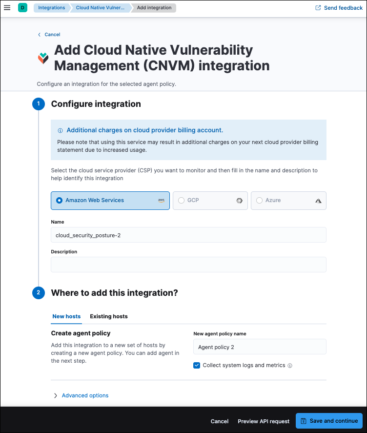

edit- In the Elastic Security app, go to the Get started page, then click Add security integrations.
- Search for Cloud Native Vulnerability Management, then click on the result.
- Click Add Cloud Native Vulnerability Management.
Give your integration a name that matches its purpose or the AWS account region you want to scan for vulnerabilities (for example,
uswest2-aws-account
.) - Click Save and continue. The integration will create a new Elastic Agent policy.
- Click Add Elastic Agent to your hosts.

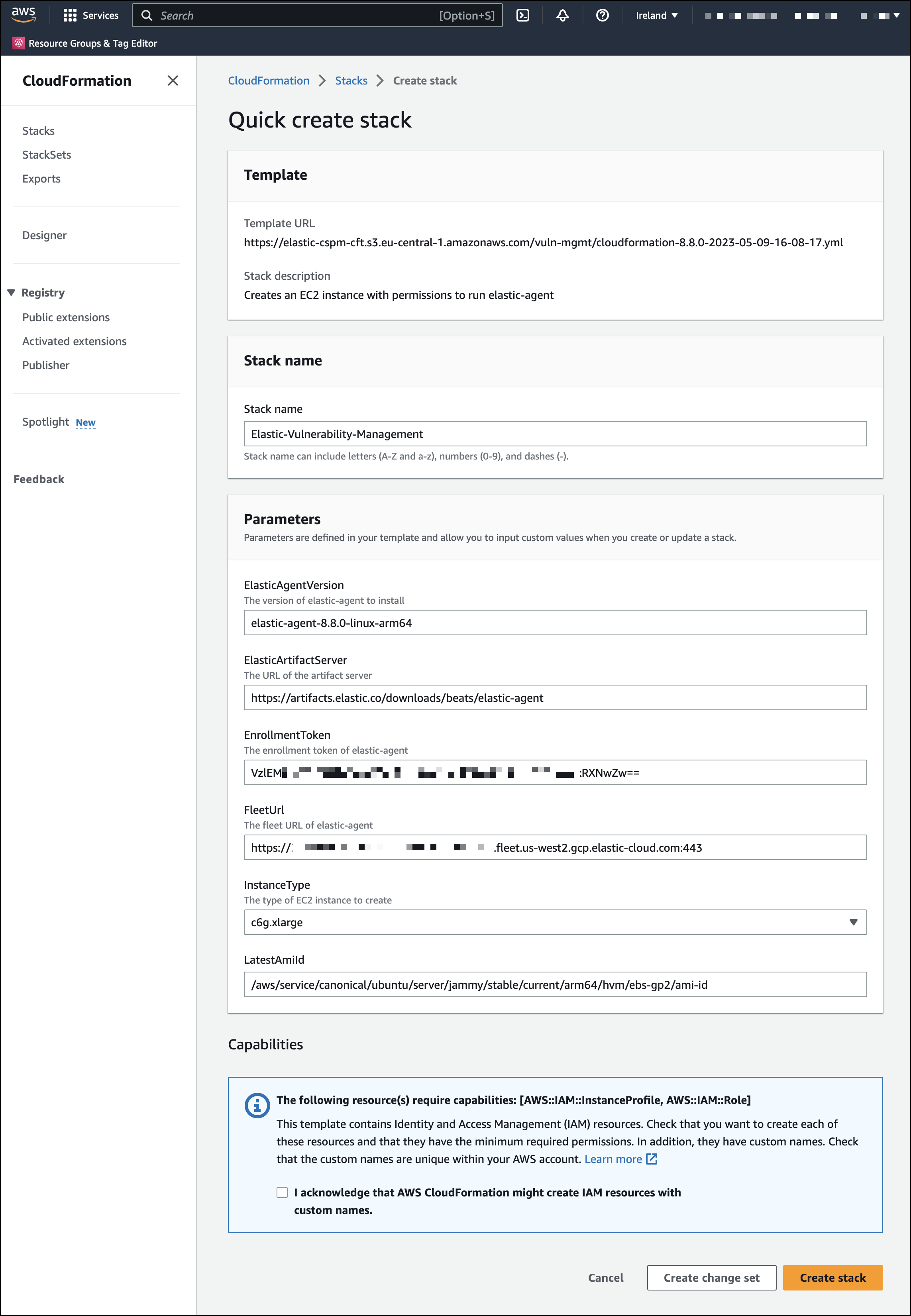

Step 3: Run the CloudFormation template
edit- Switch back to the tab where you have Kibana open.
Click Launch CloudFormation. The CloudFormation page appears.
- Click Create stack. To avoid authentication problems, you can only make configuration changes to the VM InstanceType, which you could make larger to increase scanning speed.
- Wait for the confirmation that Elastic Agent was enrolled.
