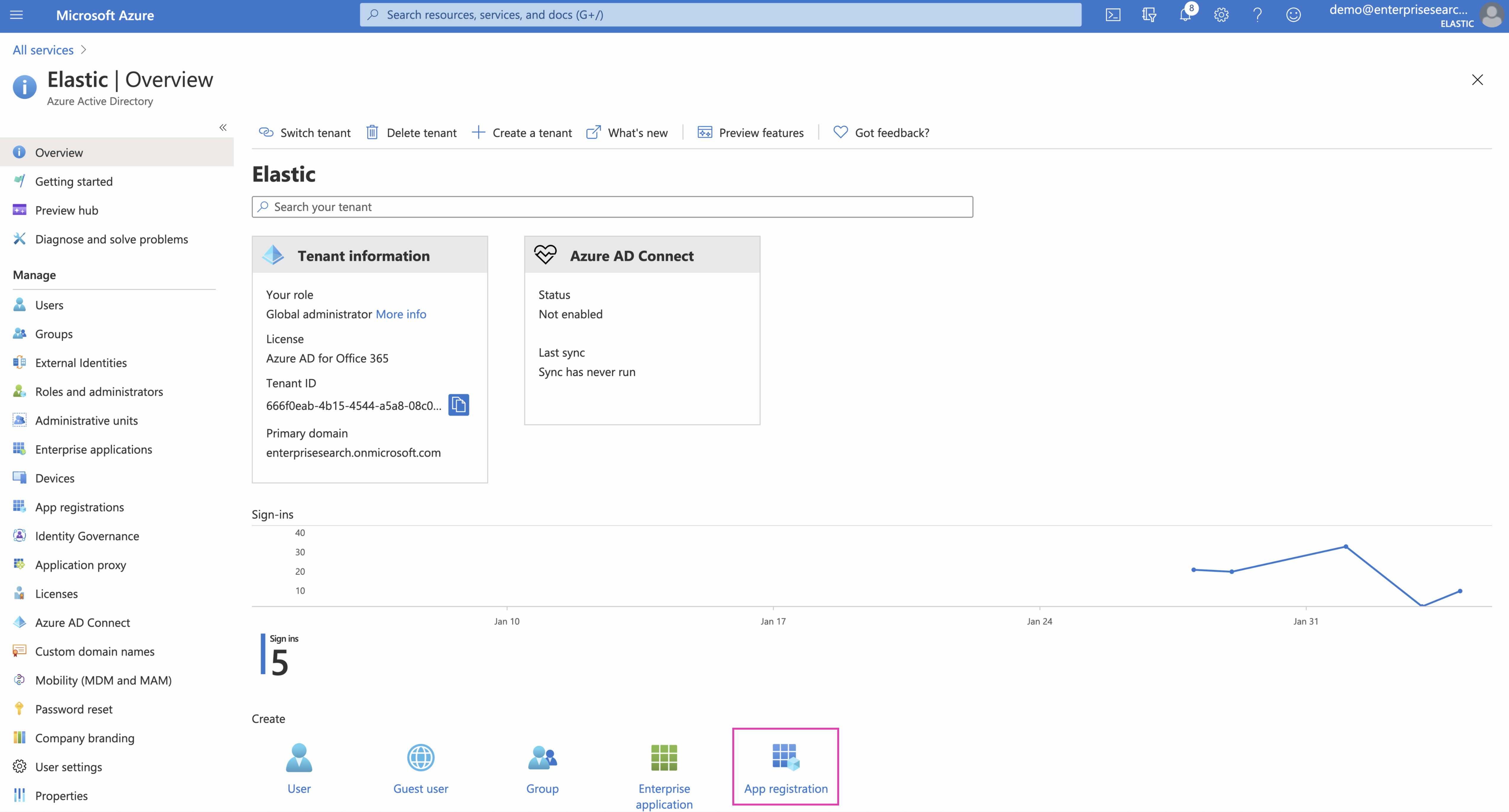

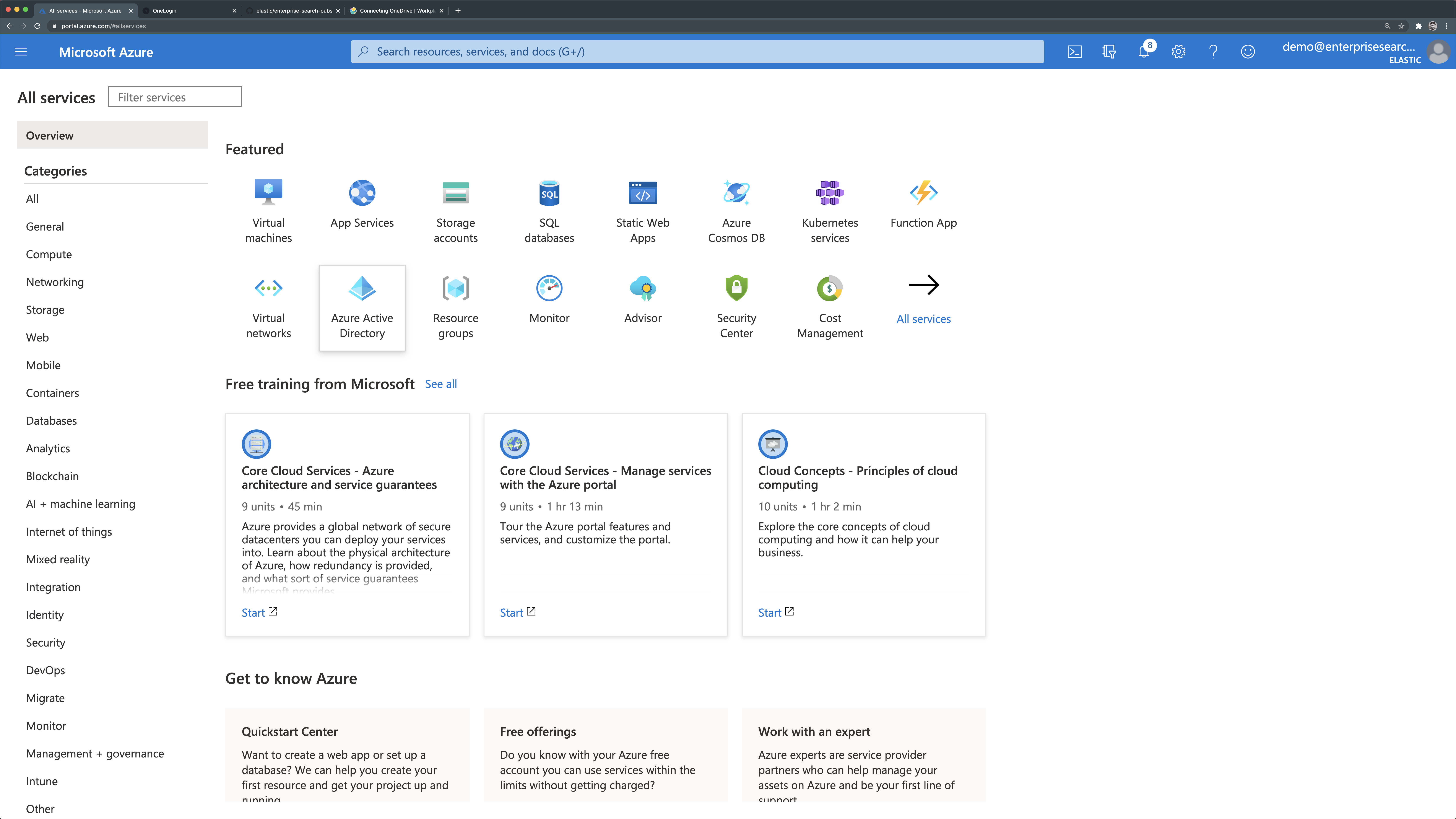

Step 1. Sign in to https://portal.azure.com/, look up and click on Azure Active Directory under More services:
Figure 60. Connecting OneDrive

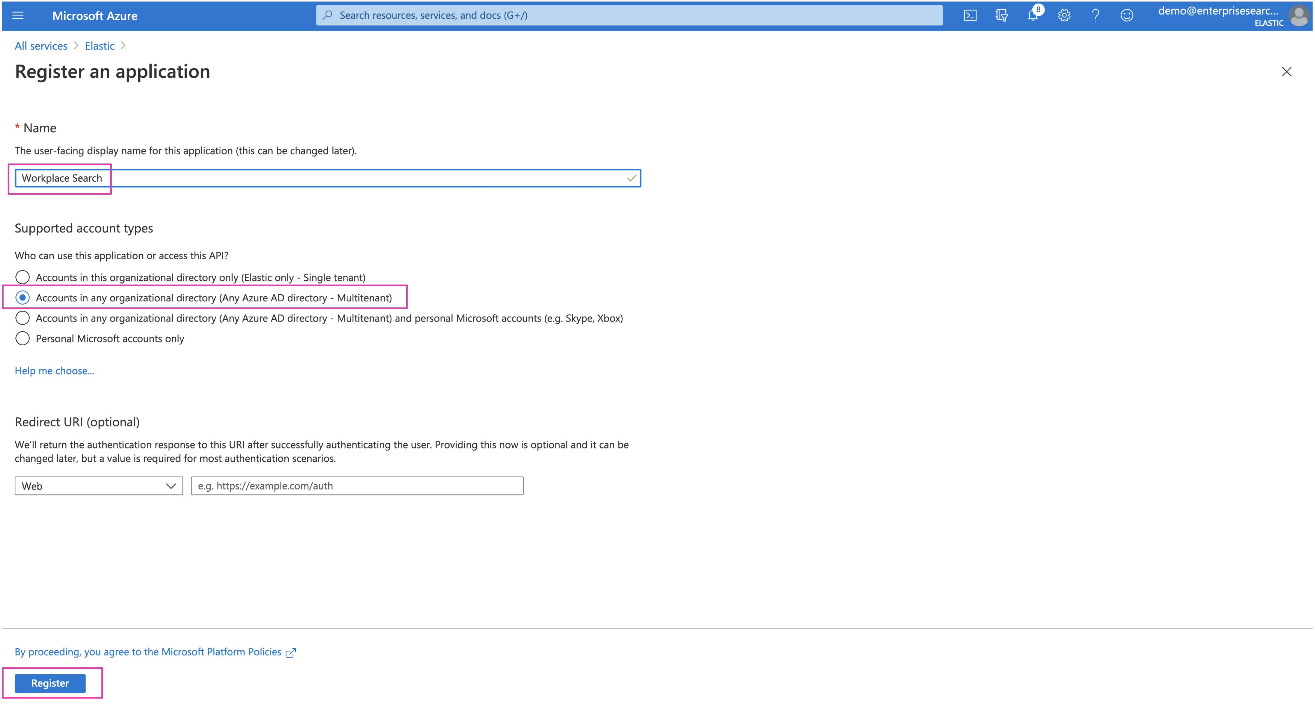

Step 3. Register the application
Give your app a name - like "Workplace Search", make it multitenant and click Register.
Leave the Redirect URIs blank for now. We will need two: one for organizational sources and the other for private sources. We’ll add this later in the process.
Click Register
Figure 62. Connecting OneDrive
Setting the app to single tenant will result in a degraded experience, and the connector will not sync content.

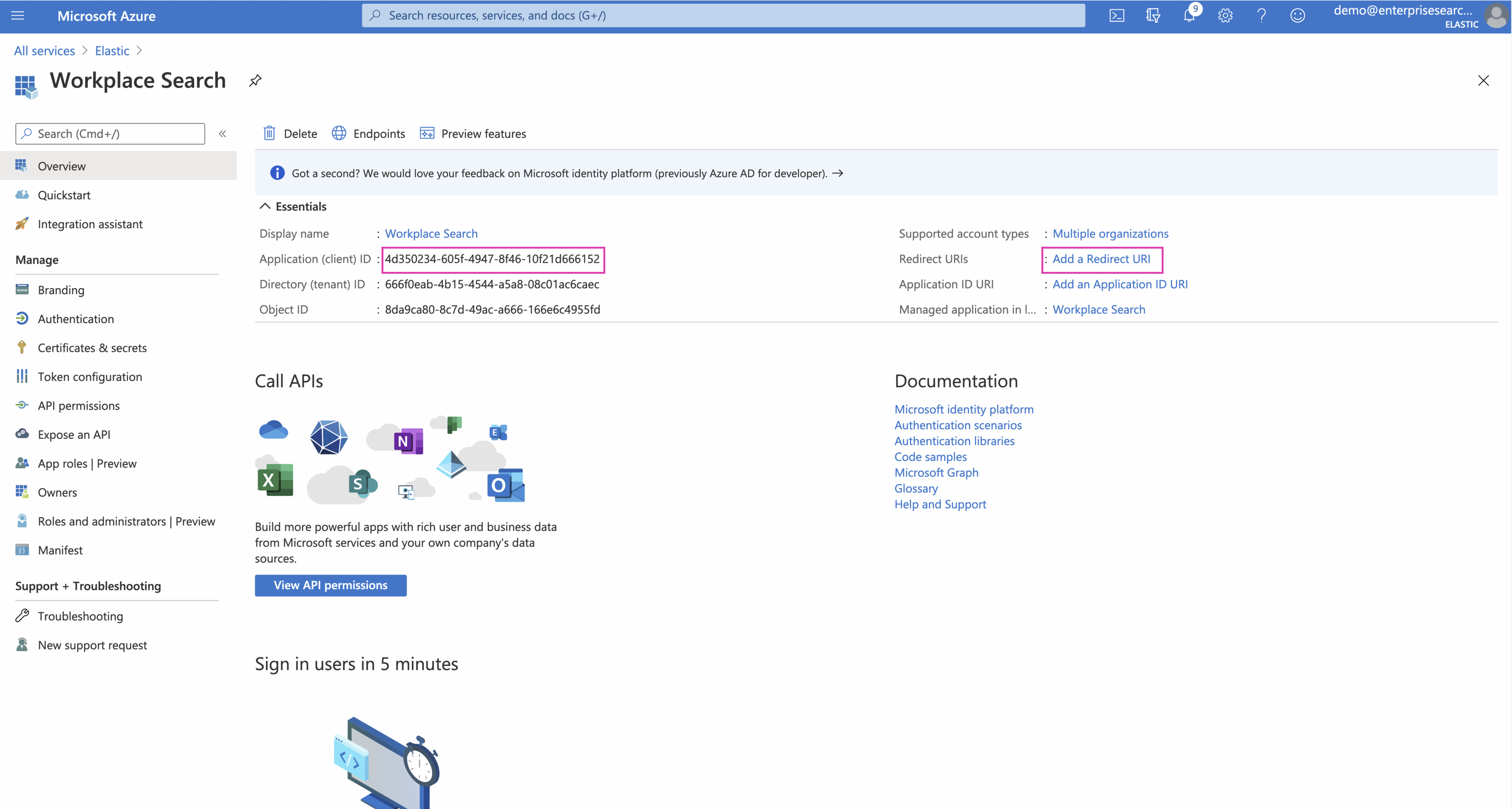

Step 4. Retrieve and keep the Client ID handy - we’ll need it within Workplace Search.
Step 5. Next, click the Add a Redirect URI link in the header.

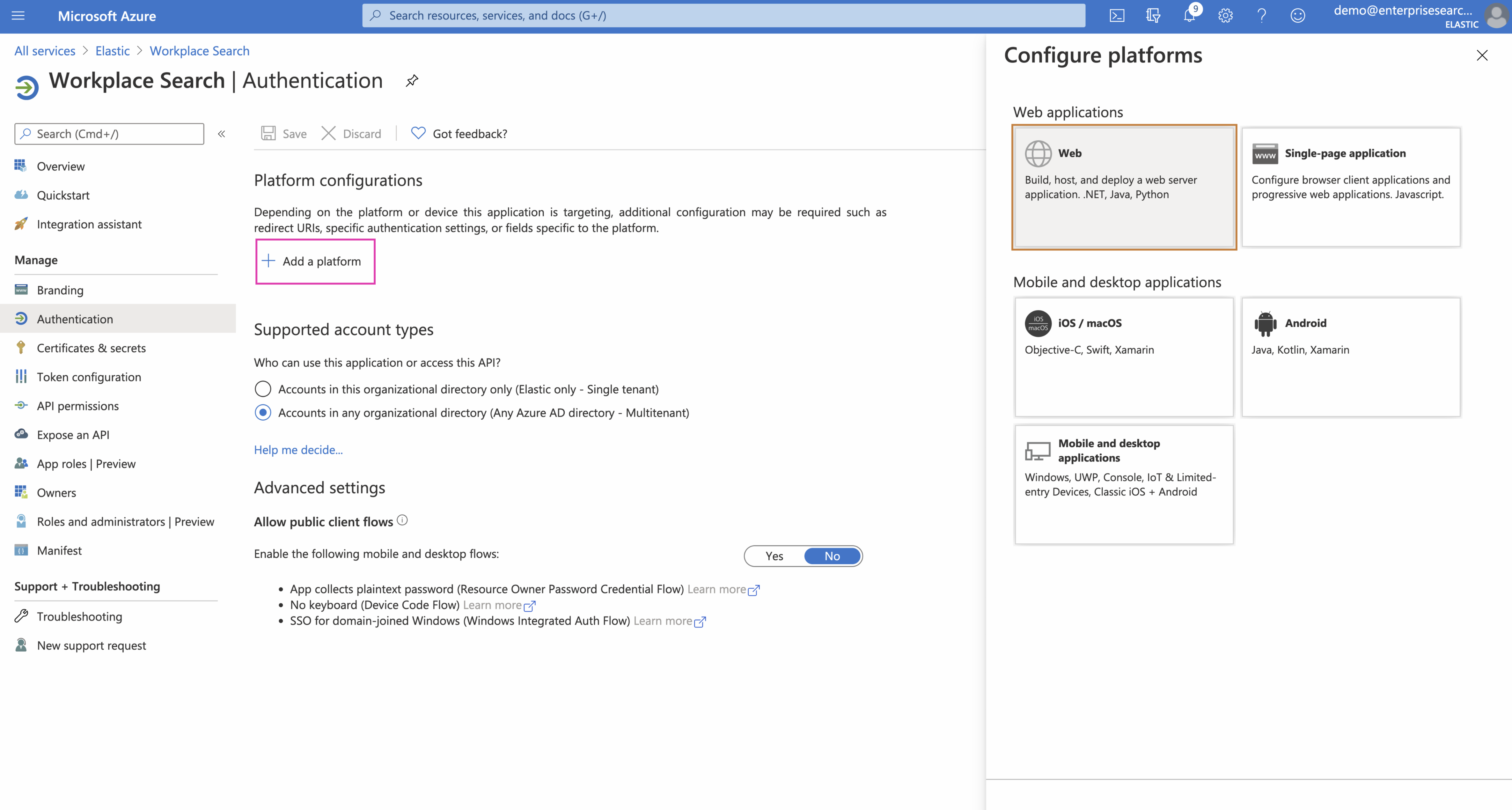

Step 6. Click Add a platform and then select Web from the sidebar
Figure 64. Connecting OneDrive

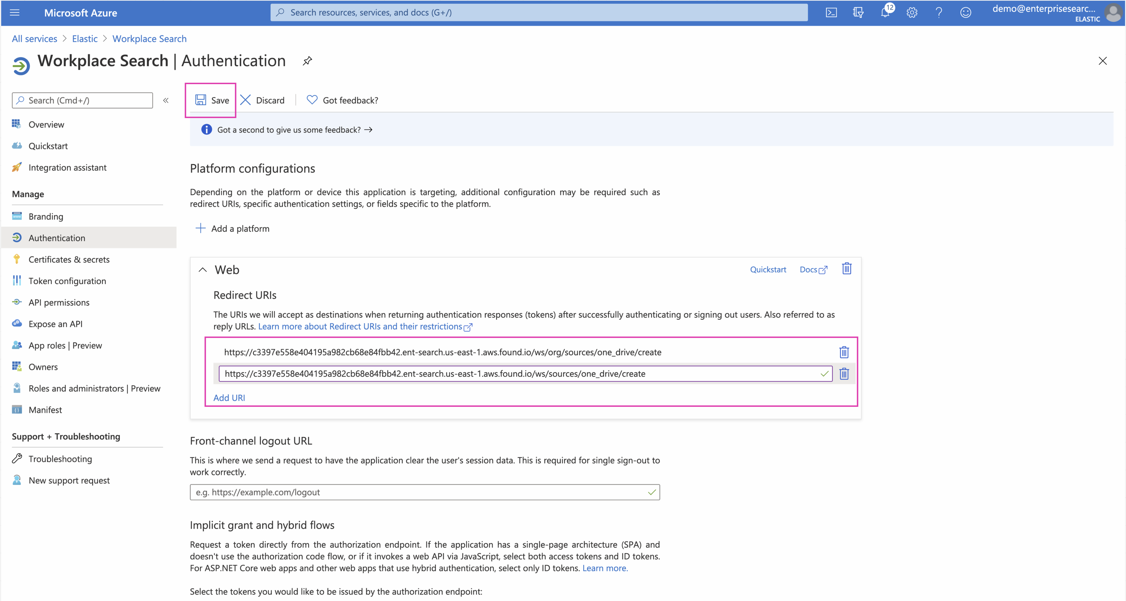

Step 7. Add the appropriate redirect URIs and Save the cofiguration:
Figure 65. Connecting OneDrive

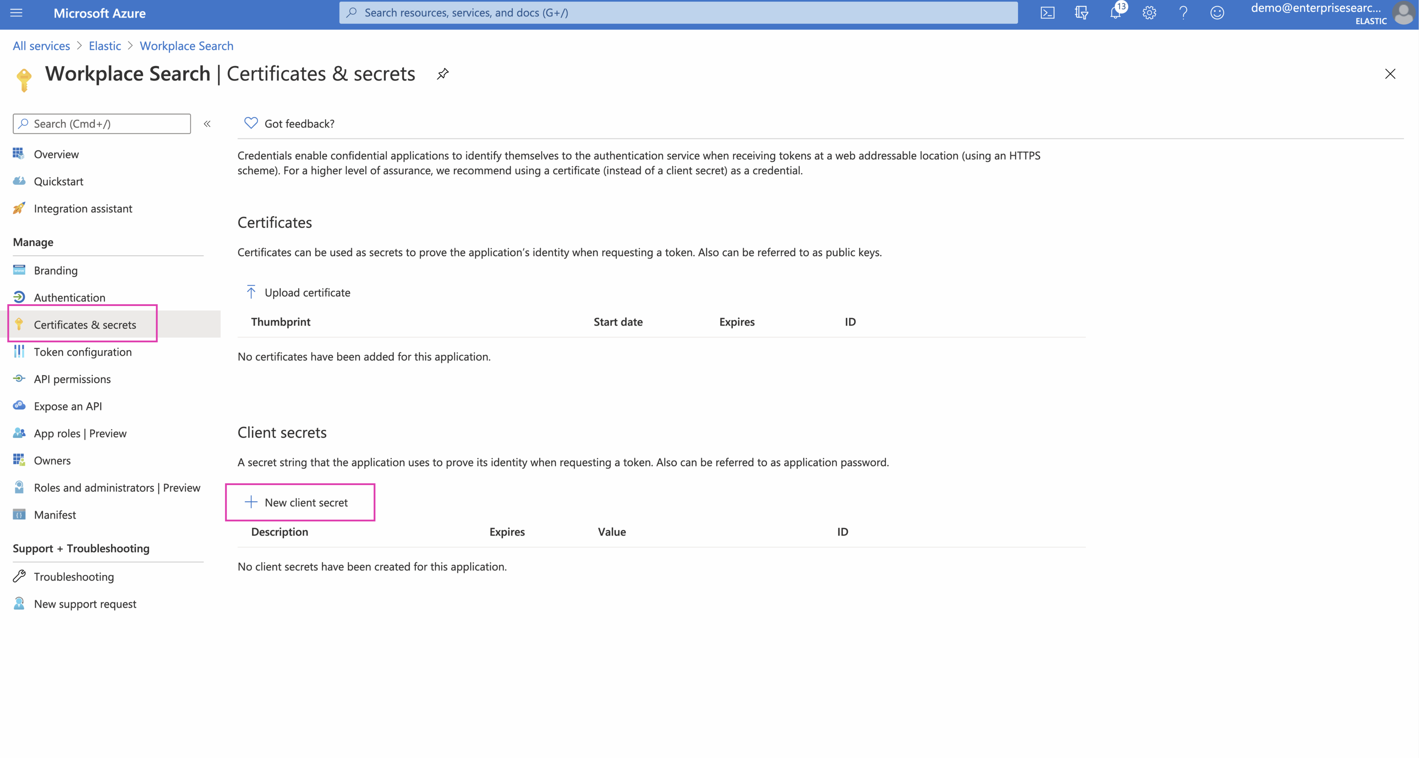

Step 8. Navigate to Certificates & Secrets and then click New client secret:
Figure 66. Connecting OneDrive
Step 9. Pick a name for your client secret (for example, Workplace Search). Select 24 months as the expiration date:
Figure 67. Connecting OneDrive
Step 10. Save the Client Secret value before leaving this screen.
Figure 68. Connecting OneDrive

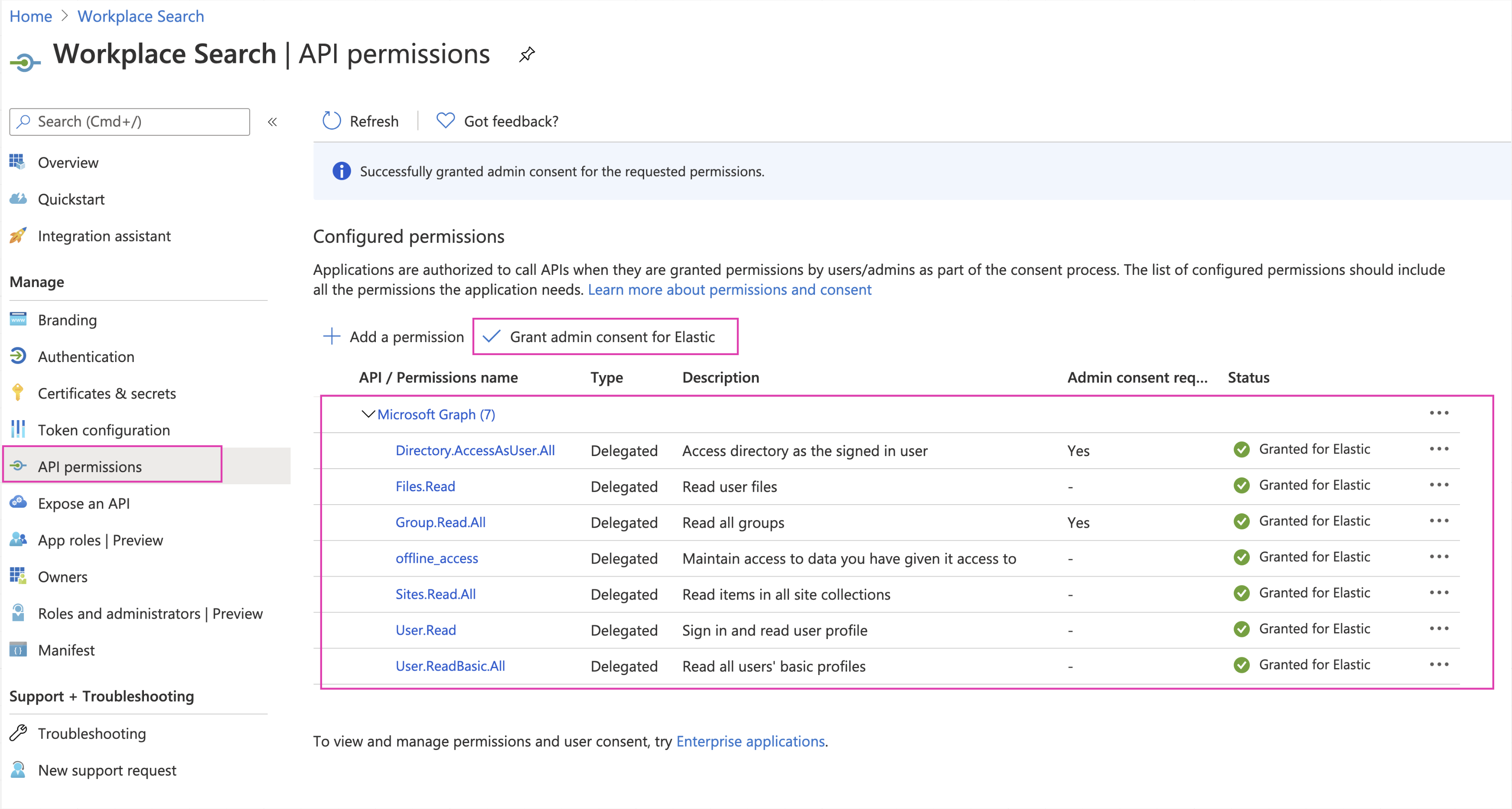

Step 11. We must now set up the permissions the Application will request from the Admin. Navigate to API Permissions and click Add Permission. Click Microsoft Graph and add delegated permissions until the list resembles the following:
Figure 69. Connecting OneDrive
Step 12. Finally, Grant admin consent.
