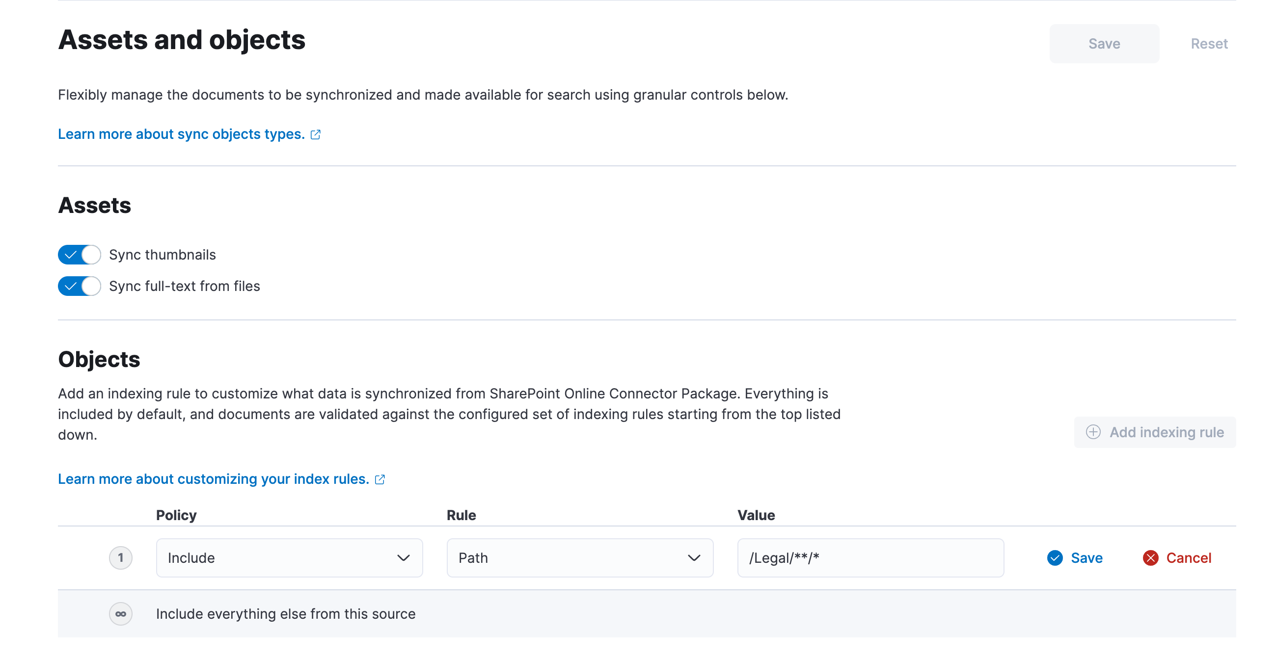

Step 3. We can then use the table at the bottom of the page to build an indexing configuration to filter out our Legal documents. Click Add indexing rule, set the Policy to Exclude, the Rule to Path and the Value to /Legal/**/*. Click Save in the table to add the rule to the indexing configuration.
A picture of the Assets and objects page. A rule to exclude all documents in the Legal path has been added.
Note that the new indexing rule configuration won’t be saved until you click the Save button at the top of the page. You can do so now.

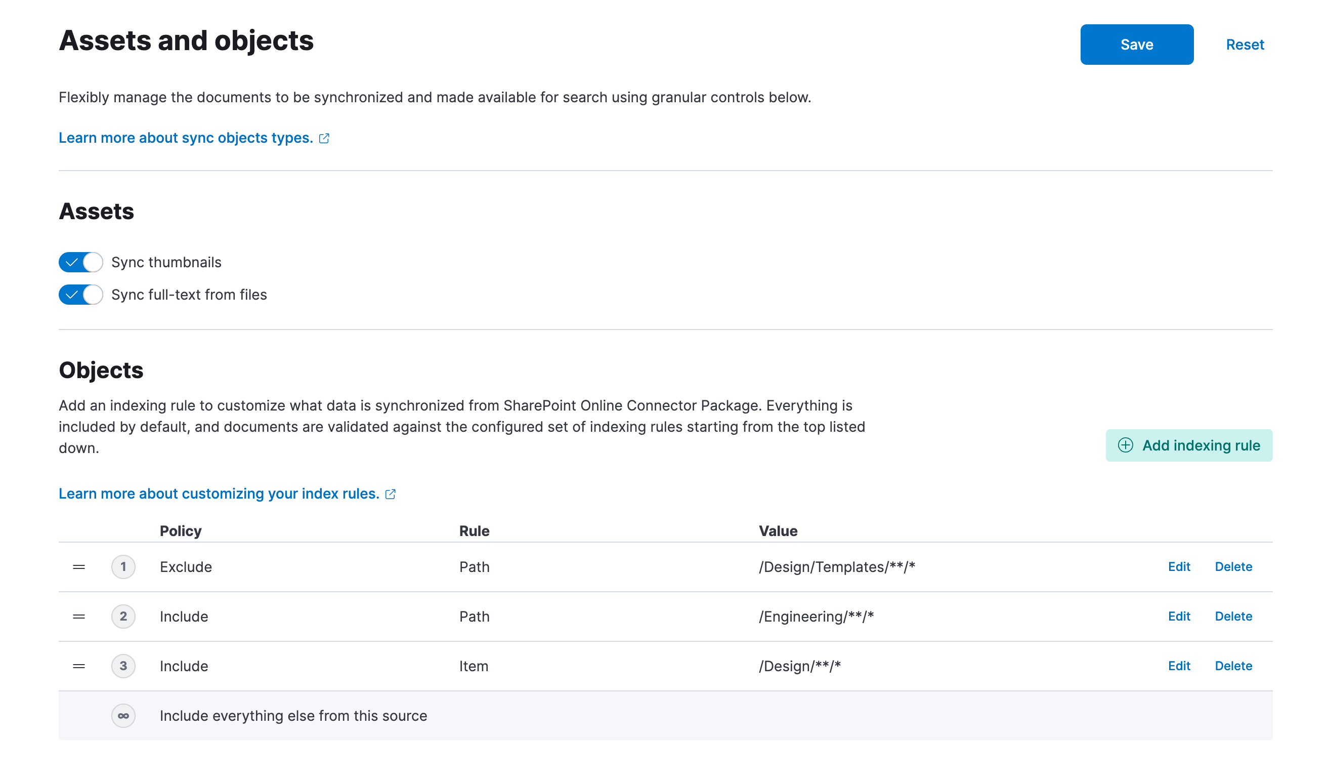

Include only specific sub-directories
For file system based sources, rather than excluding content, perhaps you only want to index content within a specific set of directories. Note that rules are evaluated in order, which allows a complex mixture of include and exclude rules. This example will index all content in the Engineering and Design top-level folders, however the Templates folder within Design will also be excluded:
A picture of the Assets and objects page. Three rules have been added, the first excludes everything in the /Design/Templates folder, the second includes everything in /Engineering, the third includes everything in /Design.
Rules can easily be reordered by dragging them within the table. You will need to click Save at the top of the page to store your changes and trigger a full synchronization.

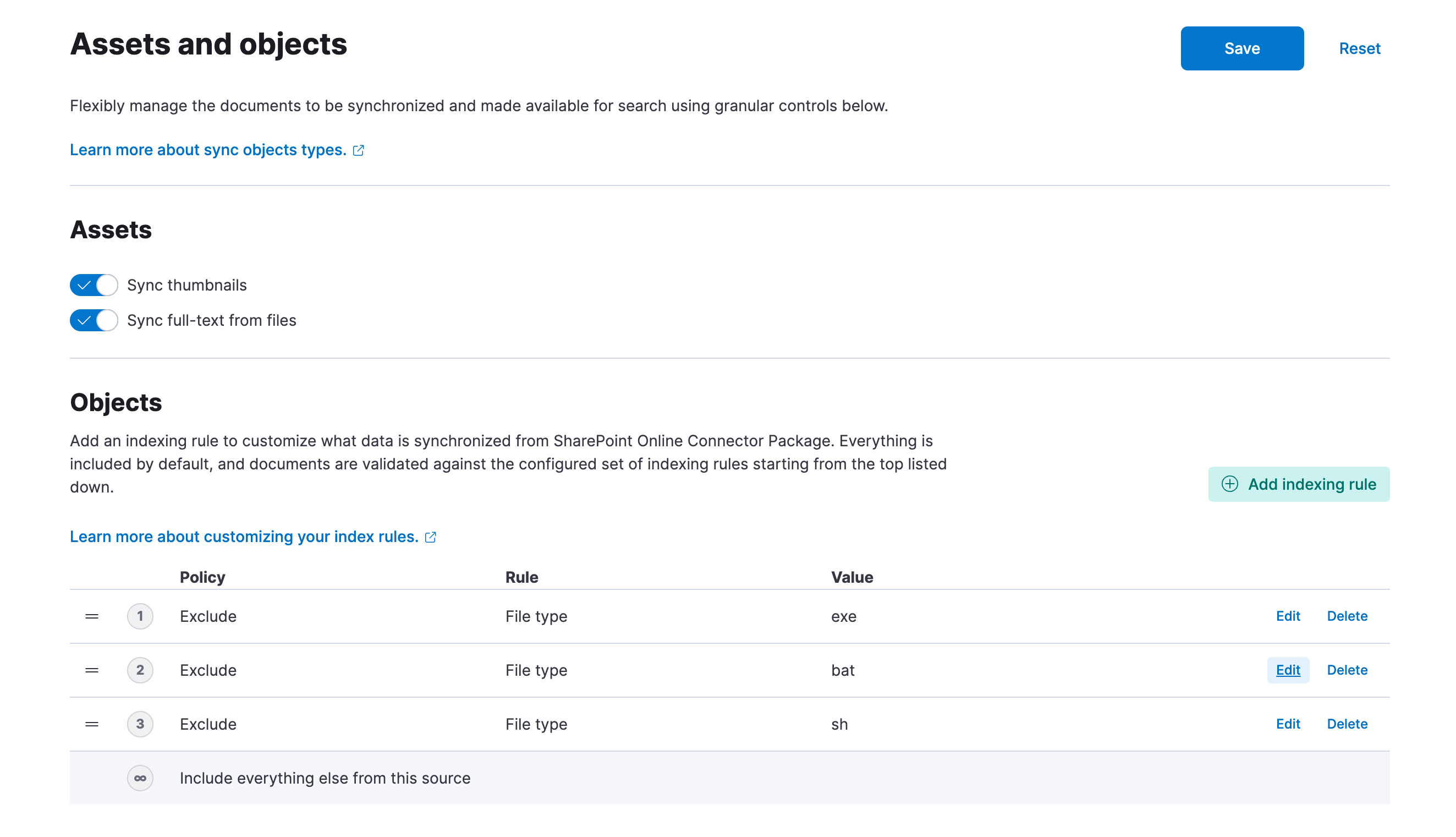

Exclude specific file extensions
This configuration will exclude some common executable file types:
A picture of the Assets and objects page. Three rules have been added, excluding exe, bat and sh files.
