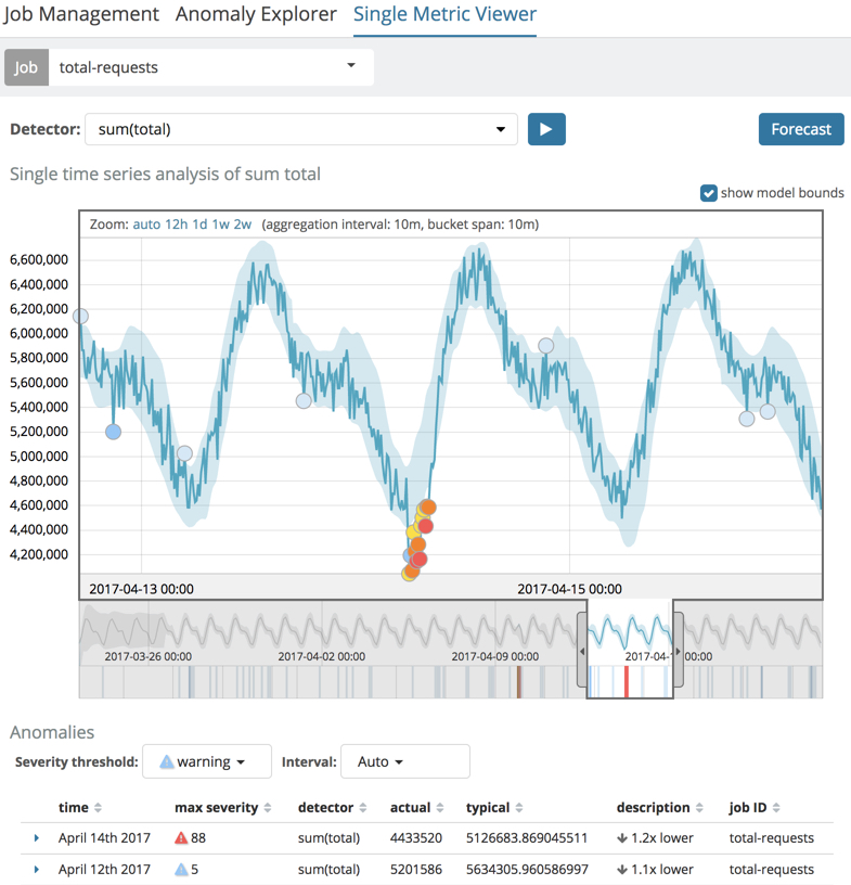

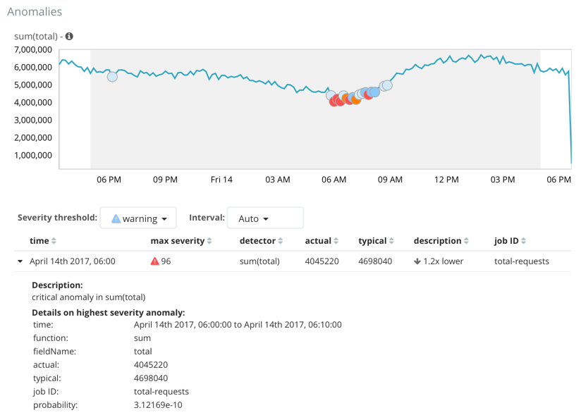

By default when you view the results for a single metric job, the Single Metric Viewer opens:
The blue line in the chart represents the actual data values. The shaded blue area represents the bounds for the expected values. The area between the upper and lower bounds are the most likely values for the model. If a value is outside of this area then it can be said to be anomalous.
If you slide the time selector from the beginning of the data to the end of the data, you can see how the model improves as it processes more data. At the beginning, the expected range of values is pretty broad and the model is not capturing the periodicity in the data. But it quickly learns and begins to reflect the daily variation.
Any data points outside the range that was predicted by the model are marked as anomalies. When you have high volumes of real-life data, many anomalies might be found. These vary in probability from very likely to highly unlikely, that is to say, from not particularly anomalous to highly anomalous. There can be none, one or two or tens, sometimes hundreds of anomalies found within each bucket. There can be many thousands found per job. In order to provide a sensible view of the results, an anomaly score is calculated for each bucket time interval. The anomaly score is a value from 0 to 100, which indicates the significance of the observed anomaly compared to previously seen anomalies. The highly anomalous values are shown in red and the low scored values are indicated in blue. An interval with a high anomaly score is significant and requires investigation.

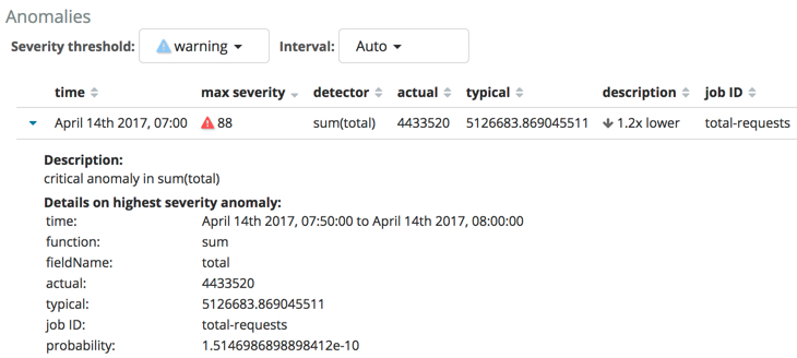

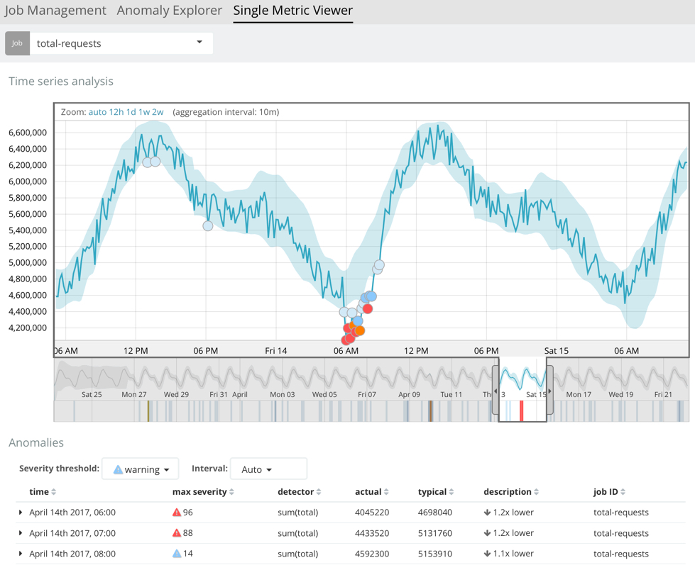

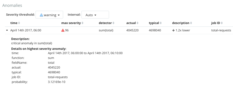

Slide the time selector to a section of the time series that contains a red anomaly data point. If you hover over the point, you can see more information about that data point. You can also see details in the Anomalies section of the viewer. For example:
For each anomaly you can see key details such as the time, the actual and expected ("typical") values, and their probability.
By default, the table contains all anomalies that have a severity of "warning" or higher in the selected section of the timeline. If you are only interested in critical anomalies, for example, you can change the severity threshold for this table.
The anomalies table also automatically calculates an interval for the data in the table. If the time difference between the earliest and latest records in the table is less than two days, the data is aggregated by hour to show the details of the highest severity anomaly for each detector. Otherwise, it is aggregated by day. You can change the interval for the table, for example, to show all anomalies.

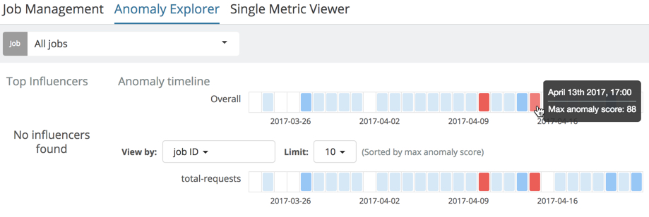

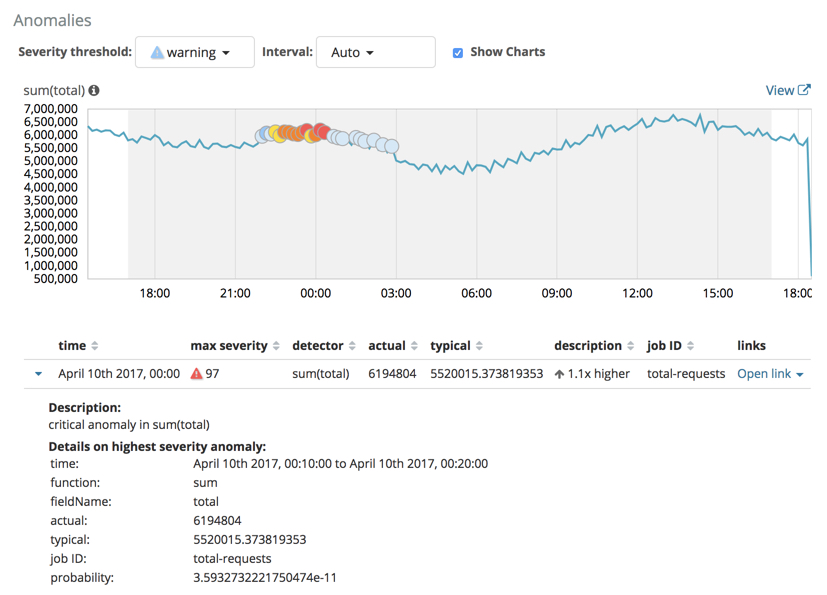

You can see the same information in a different format by using the Anomaly Explorer:
Click one of the red sections in the swim lane to see details about the anomalies that occurred in that time interval. For example:
