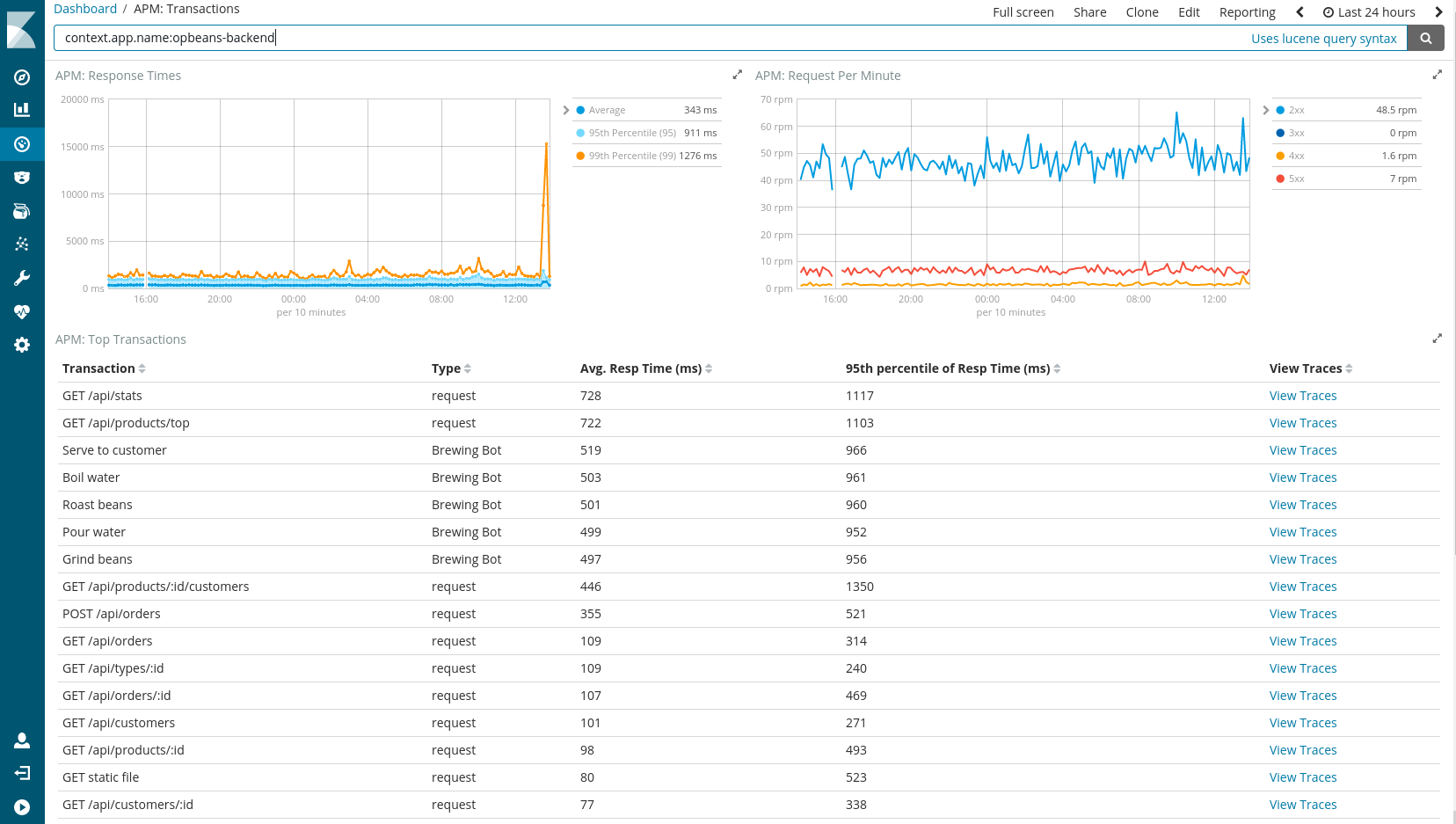

See an example screenshot of a Kibana dashboard:
