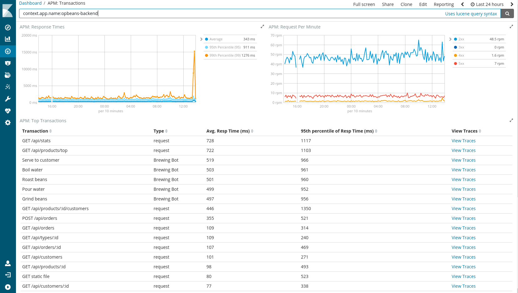

Install the Kibana dashboards
APM Server comes with predefined Kibana dashboards and index templates for APM data. To install those run the following command:
./apm-server setup
Due to a bug in Kibana 6.0.0.-rc2 the dashboards don’t work in Kibana 6.0.0-rc2.
See an example screenshot of a Kibana dashboard:
Screenshot of a Kibana Dashboard
