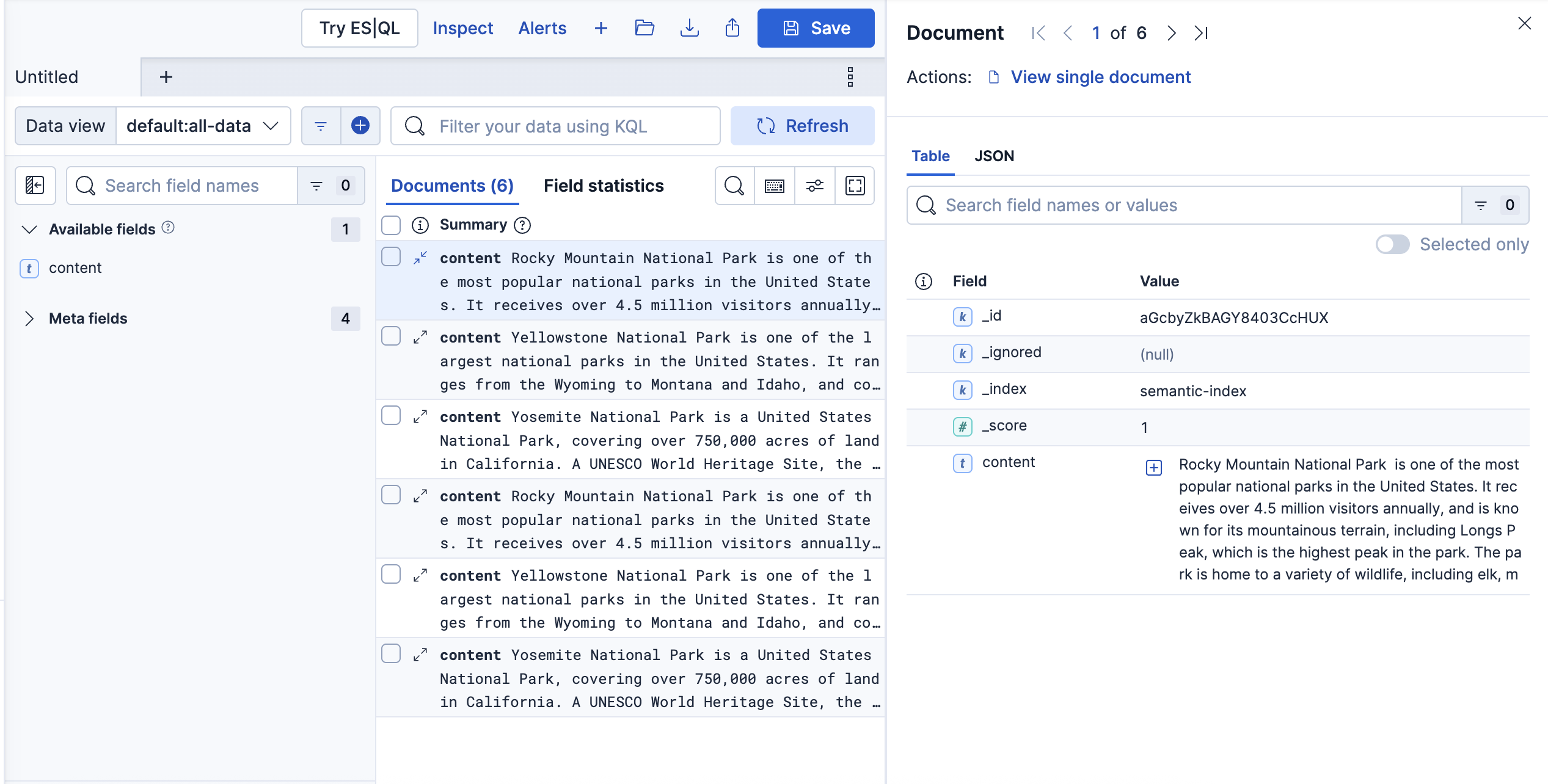

Explore the data
To familiarize yourself with this data set, open Discover from the navigation menu or the global search field.
In Discover, you can click the expand icon to show details about documents in the table:
For more tips, check out Explore fields and data with Discover.

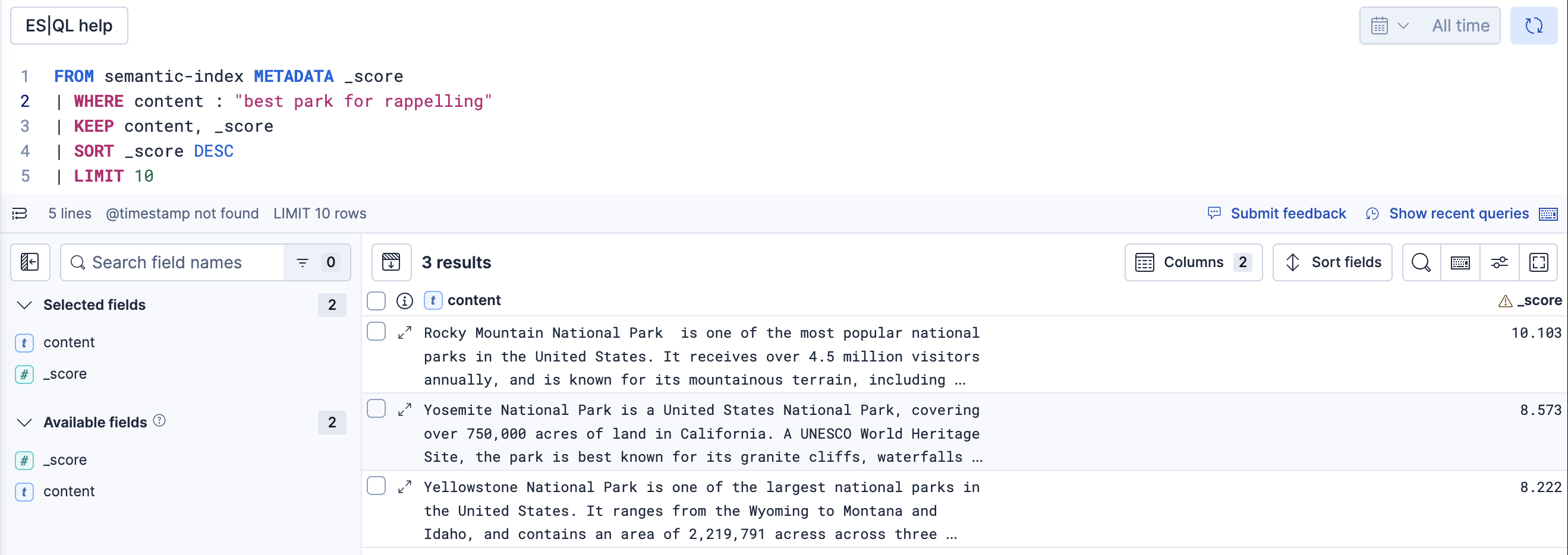

Analyze the results
To have a better understanding of how well each document matches your query, add commands to include the relevance score and sort the results based on that value. For example:
FROM semantic-index METADATA _score | WHERE content: "best spot for rappelling" | KEEP content, _score | SORT _score DESC | LIMIT 10- The
METADATAclause provides access to the query relevance score, which is a metadata field. - The KEEP processing command affects the columns and their order in the results table.
- The results are sorted in descending order based on the
_score.
TipClick the ES|QL help button to open the in-product reference documentation for all commands and functions or to get recommended queries. For more tips, check out Using ES|QL in Discover.
In this example, the first row in the table is the document related to Rocky Mountain National Park, which had the highest relevance score for the query:
