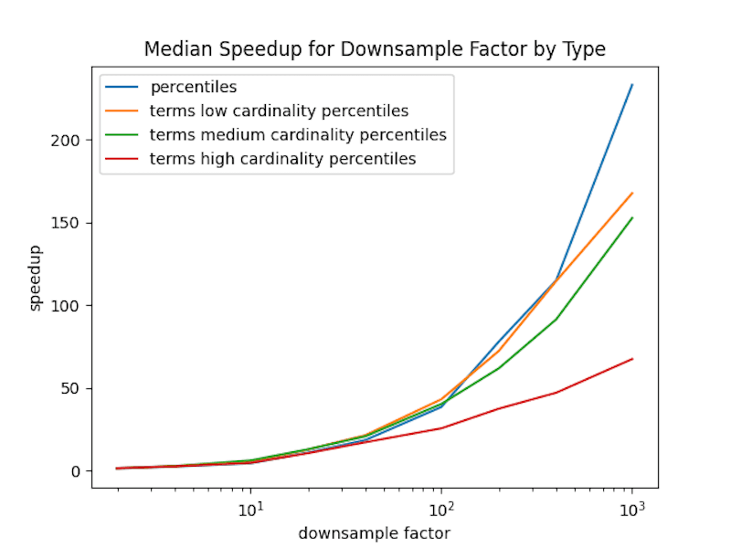

The calculations are from: 300 query and aggregation combinations, 5 seeds, and 9 sampling probabilities. In total, 13,500 separate experiments generated the following graphs for median speedup and median relative error as a function of the downsample factor which is 1 / sample probability.
Figure 2. Median speedup as a function of the downsample factor (or 1 / probability provided for the sampler).
Figure 3. Median relative error as a function of the downsample factor (or 1 / probability provided for the sampler).
With a probability of 0.001, for half of the scenarios tested, there was an 80x speed improvement or better with a 4% relative error or less. These tests involved a little over 64 million documents but spread across many shards. More compact shards and larger data can expect better results.

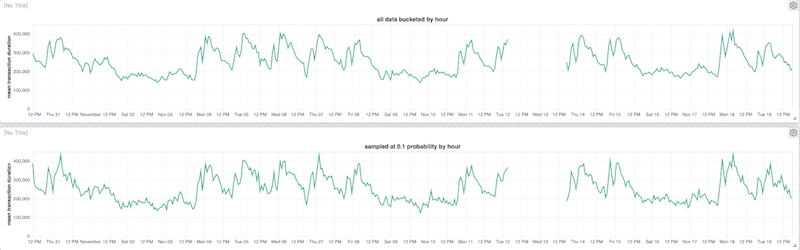

Here is another example. This time the average transaction by hour is calculated and visualized. While visually these are not exactly the same, the overall trends are still evident. For a quick overview of the data to catch trends, sampling works marvelously.
Figure 5. Sampled vs. unsampled average transaction time by hour visualization.
