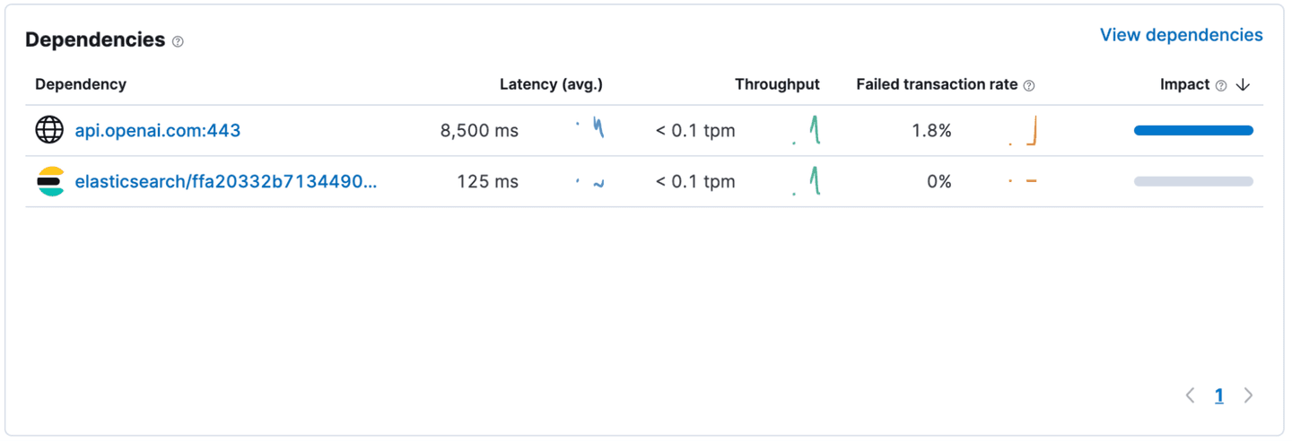

Analyzing the APM data — Elasticsearch vs. OpenAI performance
After instrumenting the application, a quick look at the “Dependencies” gives us a better understanding of what’s going on. It looks like our requests to Elasticsearch return within 125ms on average, while OpenAI takes 8,500ms to complete a request. (This screenshot was taken on a version of the application that does not use streaming. If you use streaming, the default instrumentation only considers the initial POST request in the dependency response time and not the time it takes to stream the full response.)

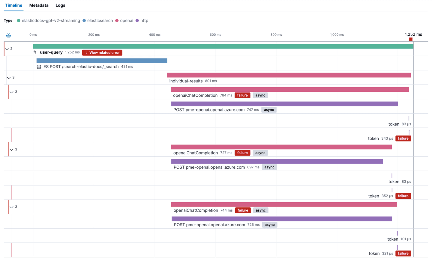

As mentioned previously, we added a bit more custom instrumentation than just the bare minimum. This allows us to get detailed information on where our time is spent. Let’s take a look at a full trace and see this streaming in action.
Our application is configured to fetch the top three hits from Elasticsearch, and then run one ChatCompletion request against OpenAI in parallel.
As we can see in the screenshot, loading the individual results takes about 15s. We can also see that requests to OpenAI that return a larger response take longer to return. But this is only a single request. Does this behavior happen for all requests? Is there a clear correlation between response time and number of tokens to back up our claims from earlier?

Any captured errors are then visible in the waterfall charts as part of the span where the failure happened.

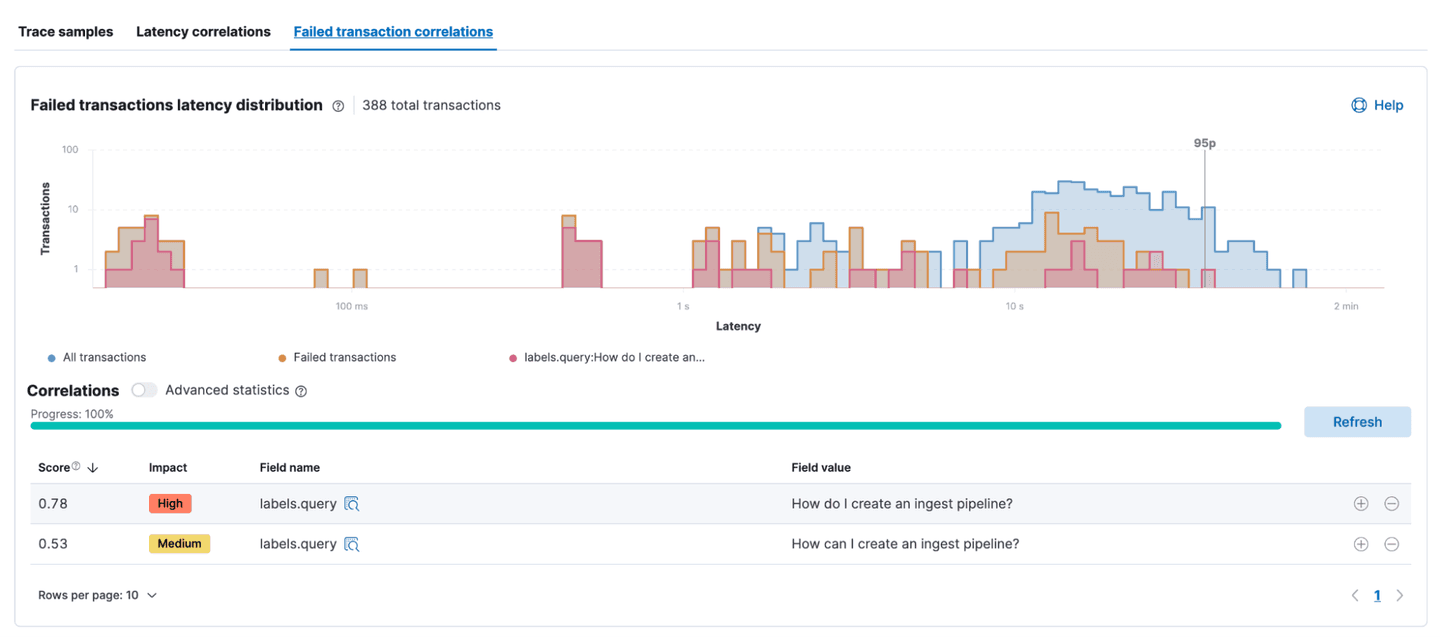

Latency and failed transaction correlation
With all the built-in metadata that the Elastic APM agent capture, as well as the custom labels we added, we can easily analyze if there’s any correlation between the performance and any of the metadata (like services version, user query, etc.)
As we can see below, there’s a small correlation between the query “How can I mount and index on a frozen node?” and a slower response time.
Similar analysis can be done on any transaction that resulted in an error. In this example, the two queries “How do I create an ingest pipeline” and “How can I create an ingest pipeline” fail more often than other queries, causing them to bubble up in this correlation analysis.
