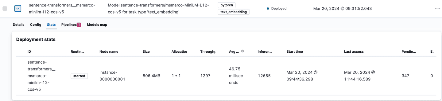

Finally, we are ready to reindex. Given that reindex will take some time to process all documents and infer on them, we do reindex in the background by invoking the API with the wait_for_completion=false flag.
The above returns a task id. We can monitor progress of the task with:
Alternatively, track progress by watching Inference count increase in the model stats API or model stats UI.
