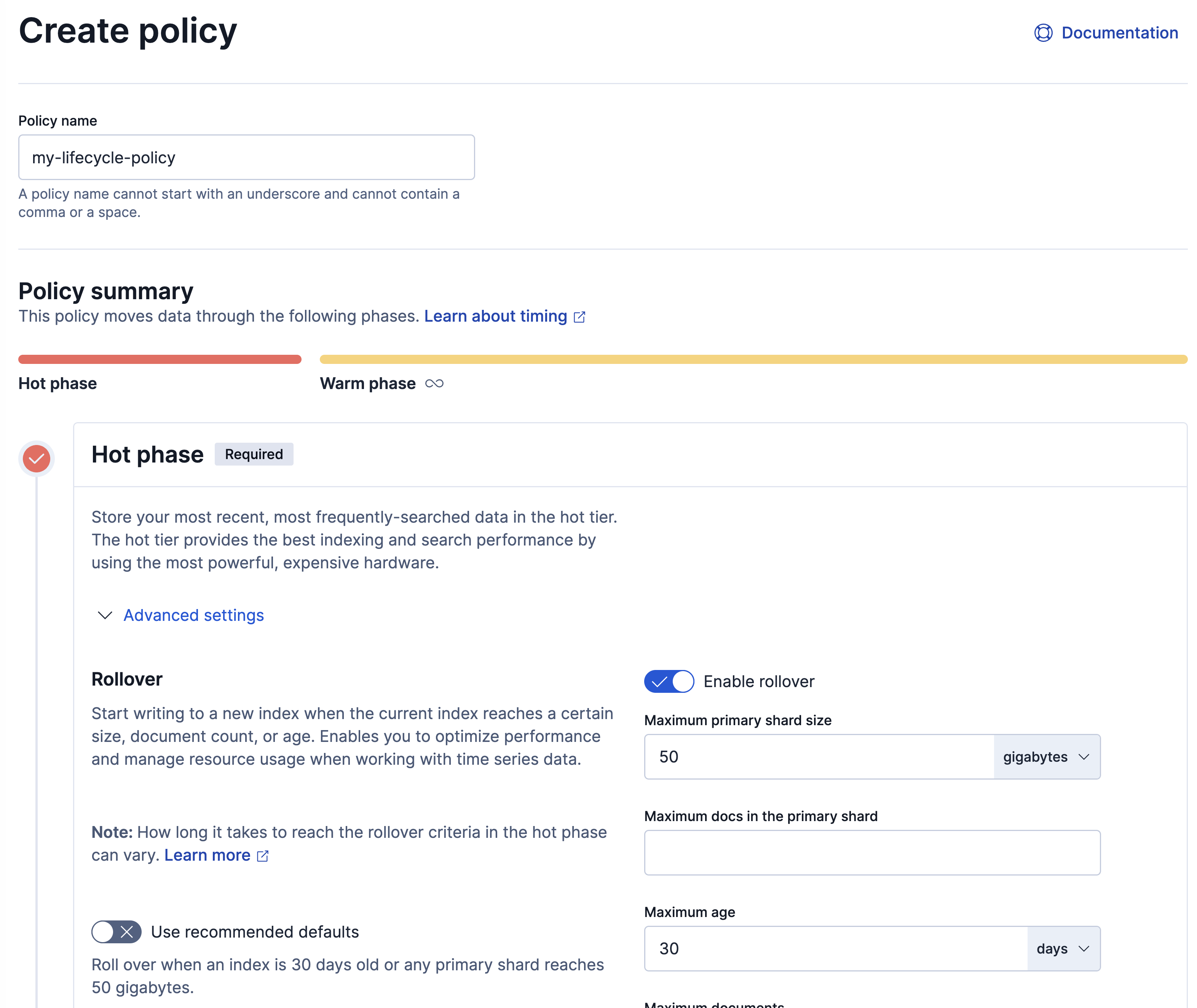

The min_age
value is relative to the rollover time, not the index creation time. Learn more.
You can create the policy through Kibana or with the create or update policy API. To create the policy from Kibana, open the menu and go to Stack Management > Index Lifecycle Policies. Click Create policy.

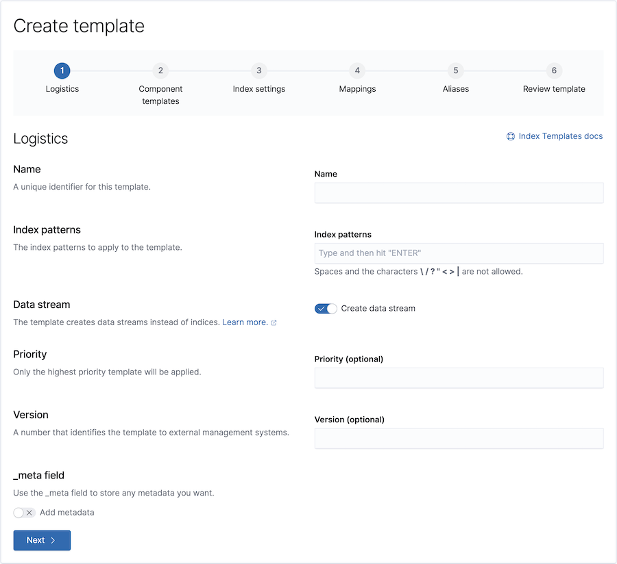

To set up a data stream, first create an index template to specify the lifecycle policy. Because the template is for a data stream, it must also include a data_stream
definition.
For example, you might create a timeseries_template
to use for a future data stream named timeseries
To enable the ILM to manage the data stream, the template configures one ILM setting:
index.lifecycle.name
specifies the name of the lifecycle policy to apply to the data stream.
You can use the Kibana Create template wizard to add the template. From Kibana, open the menu and go to Stack Management > Index Management. In the Index Templates tab, click Create template.
This wizard invokes the create or update index template API to create the index template with the options you specify.

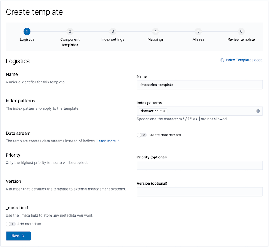

To automatically apply a lifecycle policy to the new write index on rollover, specify the policy in the index template used to create new indices.
that is applied to new indices whose names match the timeseries-*
index pattern.
To enable automatic rollover, the template configures two ILM settings:
specifies the name of the lifecycle policy to apply to new indices that match the index pattern.index.lifecycle.rollover_alias
specifies the index alias to be rolled over when the rollover action is triggered for an index.
You can use the Kibana Create template wizard to add the template. To access the wizard, open the menu and go to Stack Management > Index Management. In the Index Templates tab, click Create template.
The create template request for the example template looks like this:
