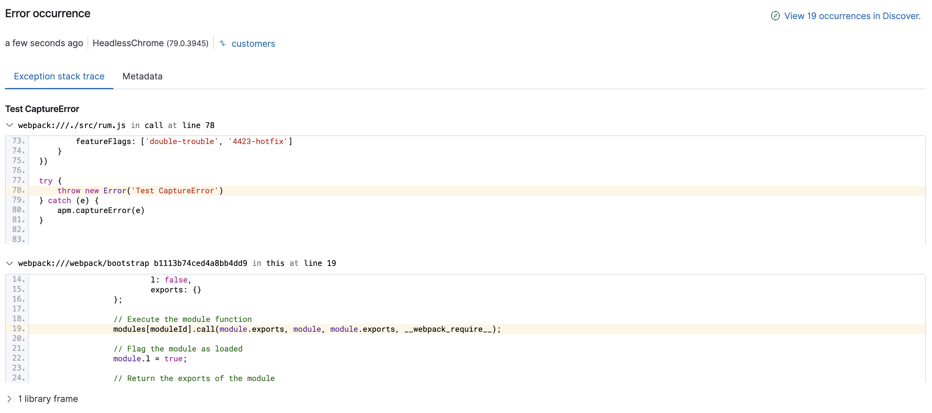

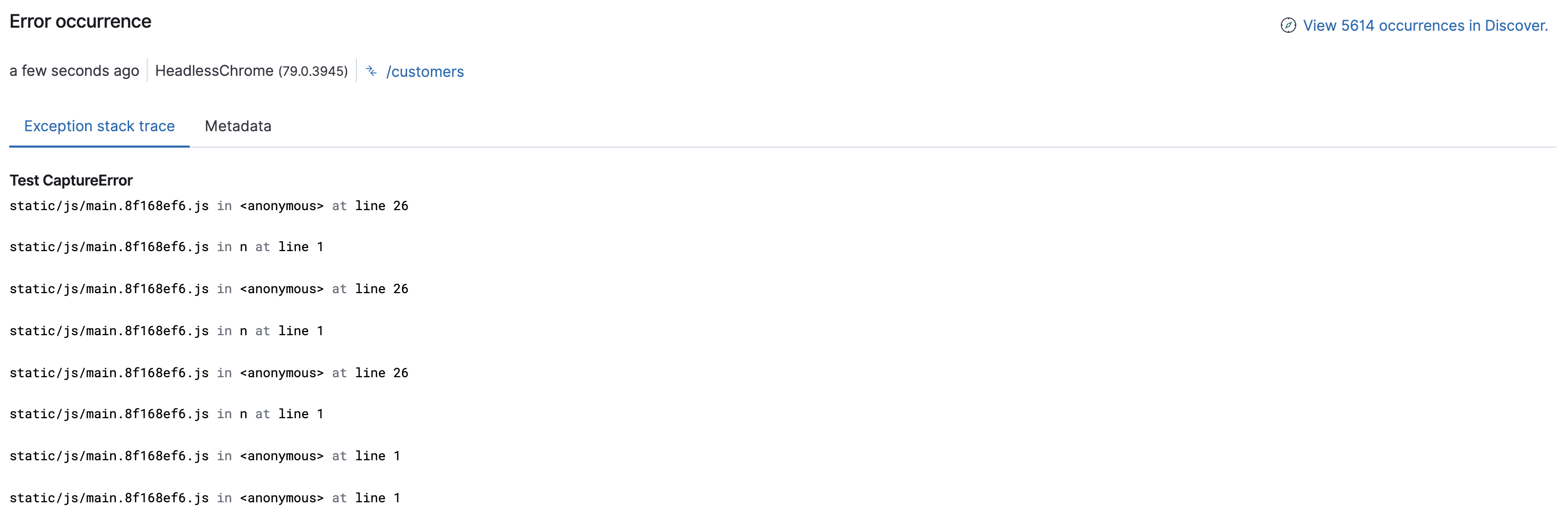

Here’s an example of an exception stack trace in the APM app when using minified code. As you can see, it’s not very helpful.
With a source map, minified files are mapped back to the original source code, allowing you to maintain the speed advantage of minified code, without losing the ability to quickly and easily debug your application. Here’s the same example as before, but with a source map uploaded and applied:
