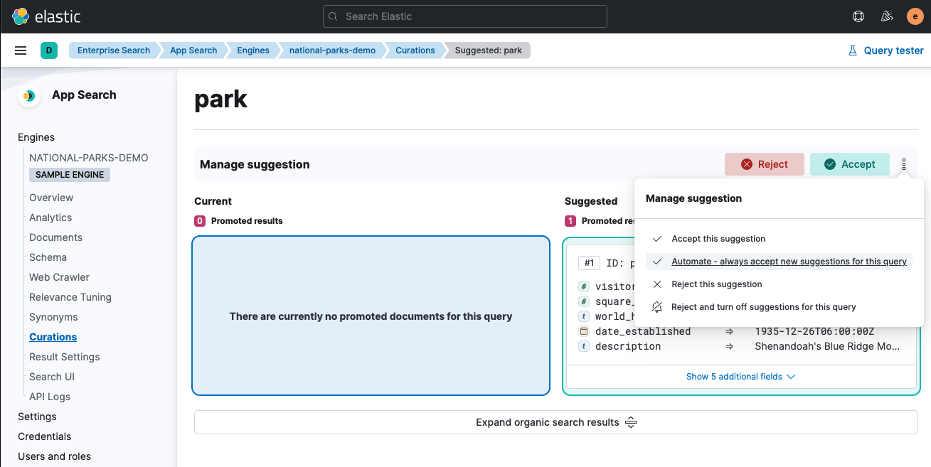

Manage adaptive relevance suggestions using Kibana
Manage adaptive relevance suggestions for your curations using Kibana:
  1. Open: SearchEnterprise SearchApp SearchEnginesengineCurations
  2. Choose the Overview tab if it isn’t already selected, and locate the Suggestions section.
  3. List and view adaptive relevance suggestions for your curations.
  4. Select a query from the list to view a specific suggestion.
  5. Accept, reject, automate, or disable suggestions for that query.

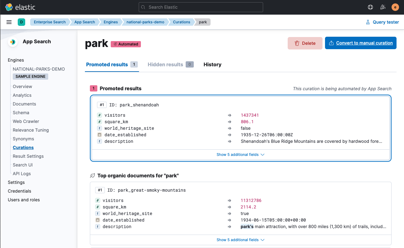

Convert an automated curation to a manual curation
Convert an automated curation to a manual curation.
Use Kibana:
  2. Select a curation to view its details, and choose Convert to manual curation.

Search operators can manage each suggestion using Kibana. Operators can:
  • Accept the suggestion. A curation will be created or updated with the suggestion.
  • Reject the suggestion. No curation will be created or updated. Updates to the suggestion will be highlighted again for approval.
  • Accept the suggestion and accept all future suggestions for the same curation. This converts the curation into an automated curation.
  • Disable the suggestion. The suggestion will be discarded and future suggestions for the same query will not be considered.
Alternatively, search operators can use the Enterprise Search API to directly manipulate the status of each suggestion. The possible statuses are:

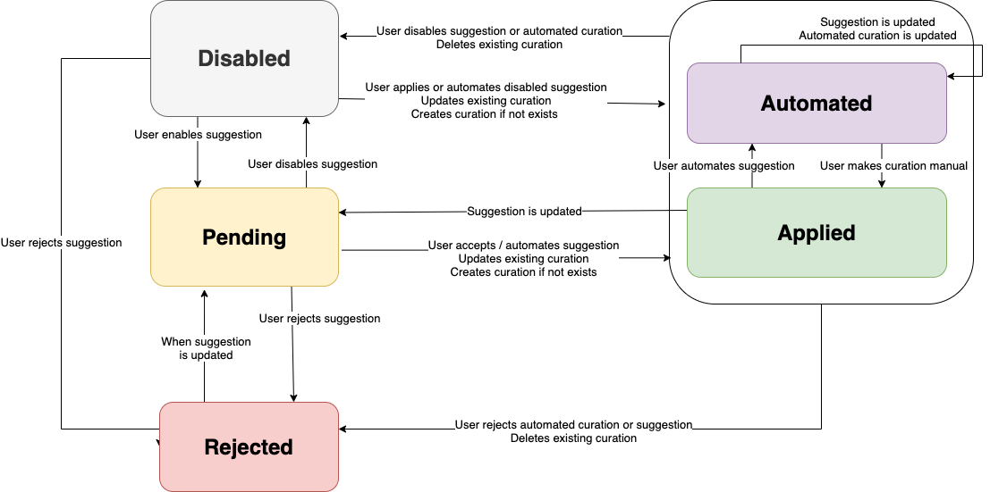

  • pending: The suggestion is waiting to be accepted or discarded.
  • applied: The suggestion has been accepted and a curation has been created or updated with the suggestion.
  • automated: The suggestion has been accepted, and any future updates on the suggestion will be applied automatically.
  • rejected: The suggestion was rejected. Future updates to the suggestion will bring it back to pending state.
  • disabled: The suggestion has not been applied, and any future updates to the suggestion will be ignored.
Also refer to the following statuses diagram:
Adaptive relevance suggestions statuses
A pending suggestion may override a curation that has been created or modified manually if applied (or automated). When that would happen, a field override_manual_curation with value true will be returned as part of the suggestion information to warn about this.

Automated curation
An automated curation is a curation whose adaptive relevance suggestions have been pre-approved. App Search therefore applies new suggestions automatically as soon as they are obtained.
Search operators cannot change queries or promoted for an automated curation. These are managed exclusively by App Search. However, search operators can change hidden.
